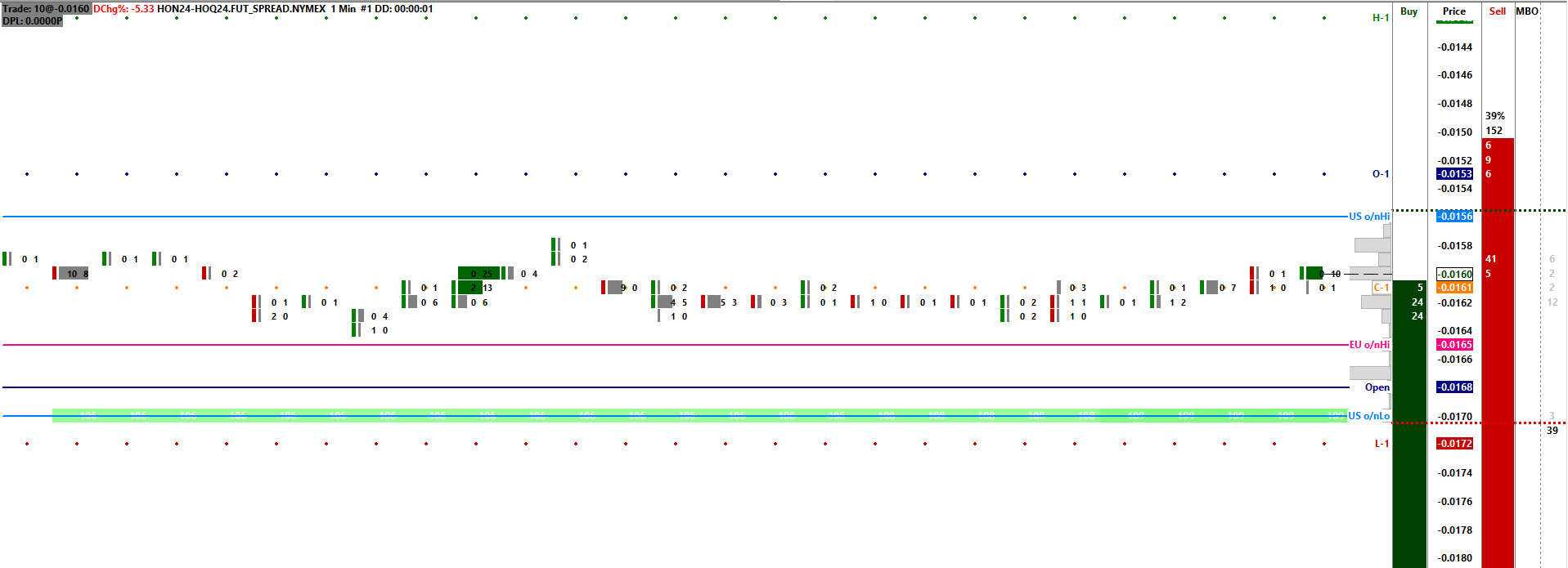

Hi guys,
How do I fix the ladders when they look like this?

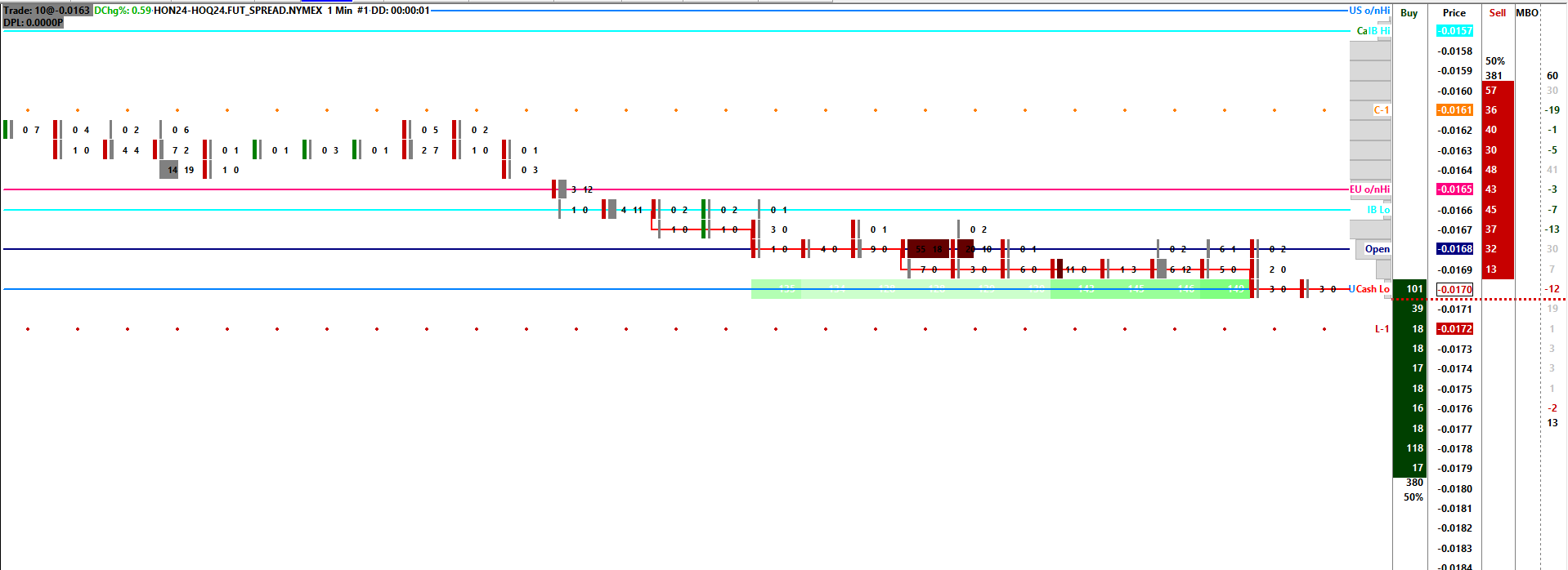

Its fixed itself now. This is what its meant to look like (first pic). I don't know what brought it back.
Here is another thats gone. CL (second). Even when I disconnect the data and reconnect, or close the chart book and reopen, it won't fix it.

Yea sorry Ill explain further.
If you look at the DOM on the right in the first picture youll see I have 10 bids and 10 offers, nice and clean like they should be.
Then on the second picture you can see I only have a few bids and a few offers, and the green from the bid column just randomly goes up the top. What you cant see in the picture is that those bids and colours are flashing in and out as well. I have another ladder on other software so Im 100% certain this is not how its meant to look.

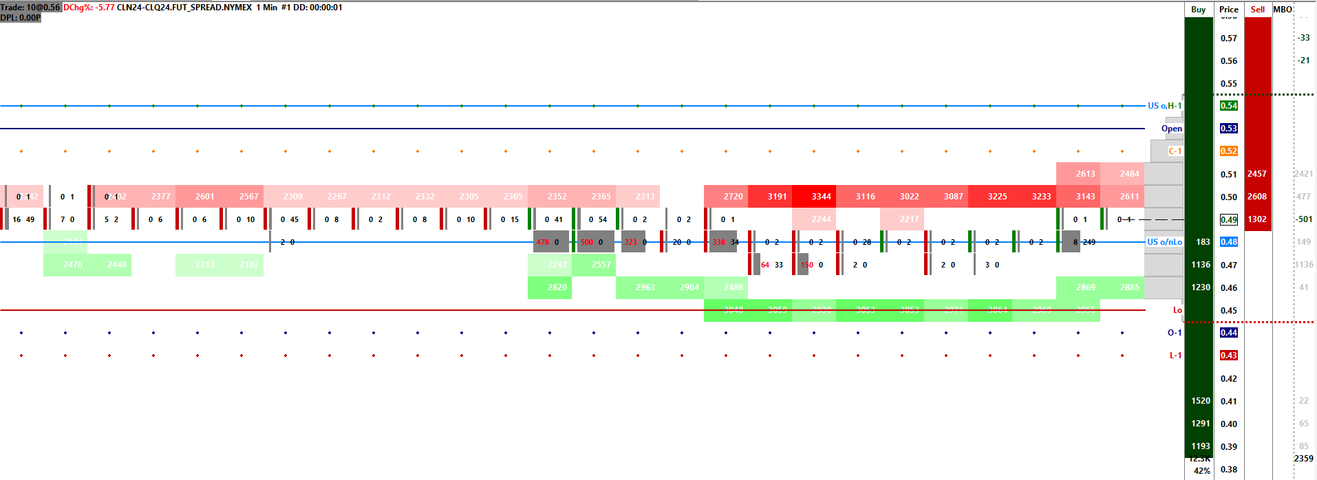

[2024-05-23 19:04:23]
StephenL - Posts: 122
To add to the above. Here is what Sierra Charts ladder shows me, versus what is actually happening in the market.
But the Sierra Chart ladder only does that if its been live for over a day or two. It doesnt happen straight away.
FYI: There is a slight delay in when I took the two screenshots so the orders figures aren't exact but you can see the general point.

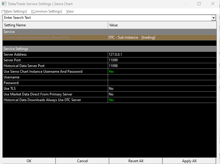

What is Global Settings >> Data/Trade Service Settings >> Current Selected Service set to?
[2024-05-24 06:59:42]
DTC - Sub Instance [trading]
screenshot attached.
imageScreenshot 2024-05-24 075833.png / V - Attached On 2024-05-24 06:59:26 UTC - Size: 24.69 KB - 260 views

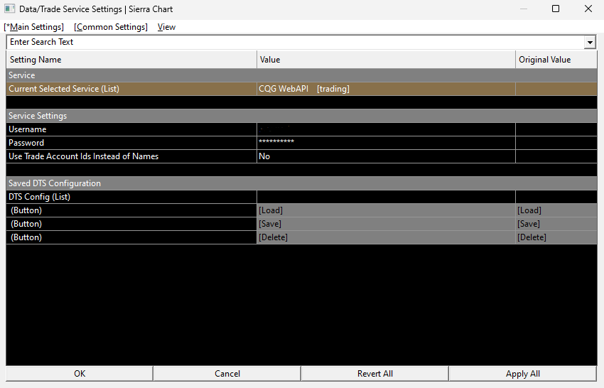

[2024-05-24 12:08:02]
Therefore, we need to know how this is set in the main instance:
Global Settings >> Data/Trade Service Settings >> Current Selected Service .
The issue must relate to symbol settings. Otherwise, it does not make sense why there would be a problem like this. It should never happen.
Date Time Of Last Edit: 2024-05-24 12:08:42
[2024-05-24 14:01:13]
CQG. It will happen for both ICE and CME calendar spreads. I use Denali for the CME calendars, thru the Find Symbol on the sub-instance.

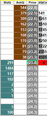

In this example, I have two charts, one above the other. The top is the Jun/Aug Gold Calendar Spread, the bottom is the Aug/Oct.
You can see that the book is not working in the top. There is data coming thru somewhere tho because you can see the 1485 at the bid at -23.5 on the Market Depth Historical Graph.
imageScreenshot 2024-05-30 101843.png / V - Attached On 2024-05-30 09:29:24 UTC - Size: 76.26 KB - 238 views
[2024-05-30 10:14:48]
We do not see why, the spread with in the leg GCM24 would be providing any data. That contract is not active.

Here is a comparison of what it should look like, versus what my SC is showing.
