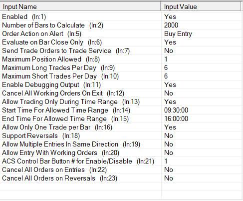

Hi there, i wondered if i could simply put the alert condition formula [as discussed below] into the "trading system based on alert condition" this was the alert for a bullish gamma candle i used to color bar:
=AND(ID35.SG3[0] > 1000, ID35.SG10[0] > ID35.SG10[-1], ID35.SG12[0] > ID35.SG12[-1], ID35.SG13[0] > ID35.SG13[-1])
is it as simple as adding it to the above or are there more steps involved?
screenshot of settings attached.
Thx
imageScreenshot 2024-03-25 160842.png / V - Attached On 2024-03-25 19:17:59 UTC - Size: 31.23 KB - 329 views
[2024-03-25 19:19:58]
If that alert condition is working for what you want, and you then want to use it to enter a trade, then yes - you can just copy and paste it into the "Trading System Based On Alert Condition" and use it for trading. Just make sure the options for the study are set as you want.
