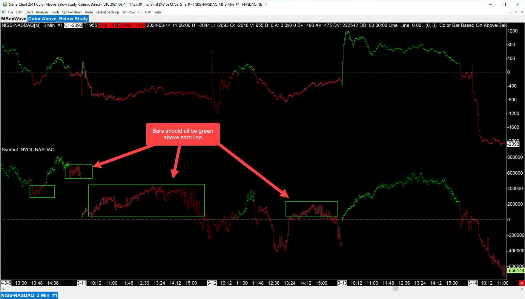

I add an additional symbol to region 2 and then add a Line study set to the zero line. And then when I add Color Bar Based on Above/Below study set to the subgraph zero Line study, some of the bars are red above the zero line when they should be green.
I also noticed the reverse is never true - bars below the zero Line study are always the properly color red.
Picture is attached.

[2024-03-15 13:25:00]
Make sure the "Color Bar Based on Above/Below Study" for the Add Additional Symbol has the "Based On" set to the Add Additional Symbol study. Refer to the following:
Chart Studies: Settings and Inputs Tab >> Based On - Basing a Study on Another Study

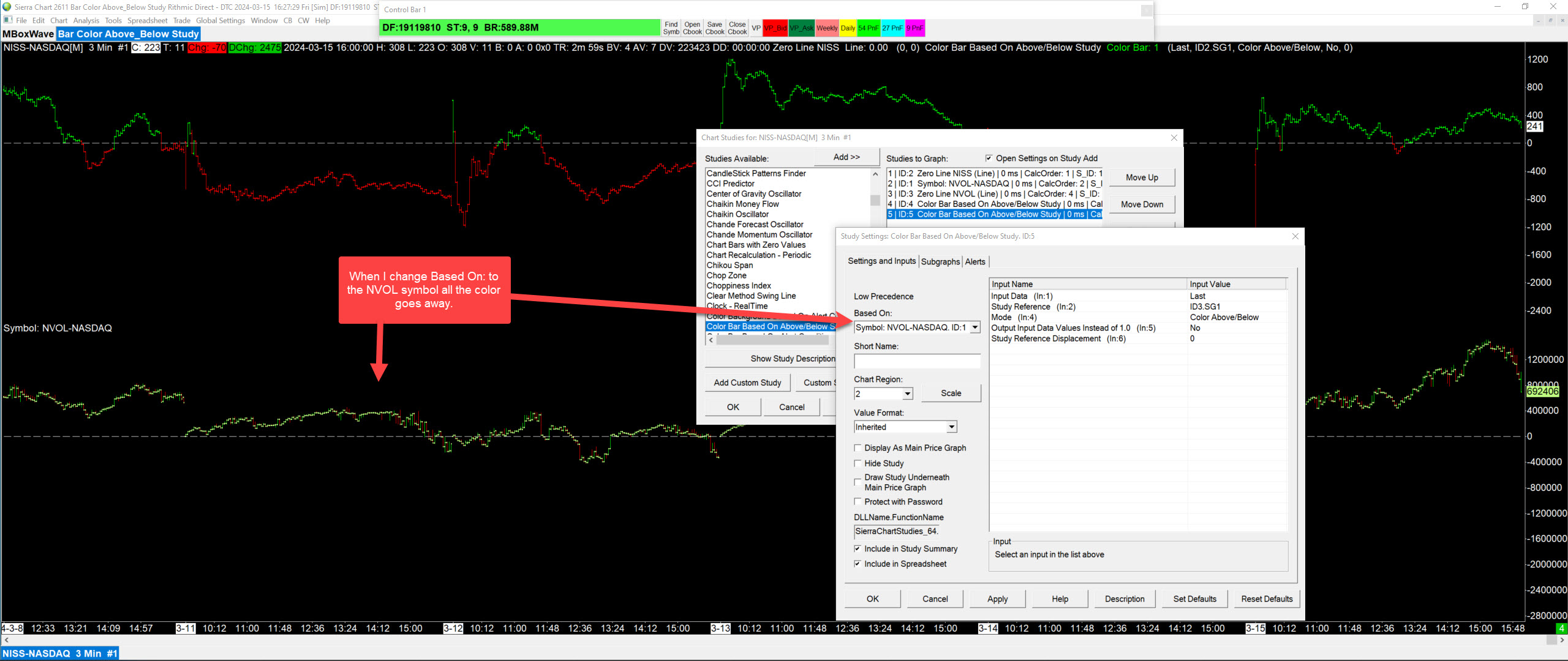

tommartin321 - Posts: 81
When I do that, all the coloring goes away.
imageBase on NVOL.jpg / V - Attached On 2024-03-15 20:32:16 UTC - Size: 513.21 KB - 304 views

[2024-03-18 21:06:03]
We are not sure exactly why the "Color Bar Above/Below Study" has an issue, but it appears to not like the "Add Additional Study", although when we first tried this we did not have an issue, but we are seeing it with your chart.
We recommend using the "Color Bar Based on Alert Condition" study instead. We have setup the chart for you using this study. The Chartbook is attached.
