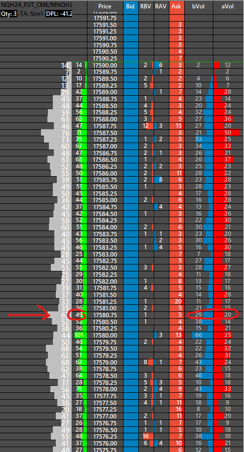

also I noticed there are some significant volume difference on the dom vsa volume by price..the first column with the arrow is a volume by price...the first circle is current total volume traded...the second circle is both the current trade bid volume and the total as volume...as expected the total bid volume + total ask volume ='s current traded total volume..but does not equal the total volume represtented in th volume by price...this is not isolated to that particulare price level if you look a couple of lines below it is significant...101 vs 44...please advise

[2024-02-21 15:24:33]
With regards to the replay of the Trade DOM, refer to the following:
Replaying Charts: Replaying Trade DOM Windows
With regards to the Volume by Price, what you are comparing is very hard to get right. In order to have the values line up perfectly, you would have to reset the Current Traded columns exactly at the start of the period where the Volume by Price profile is starting.

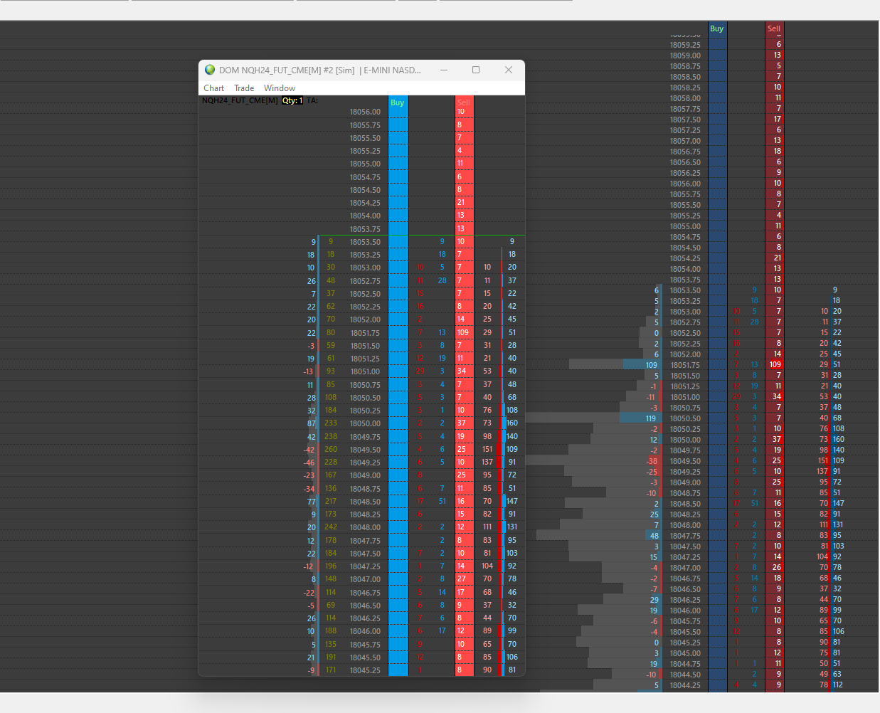

I am a little confused with the volume profile and the current total volume....so here is a picture of my dom...from left to right...there is a volume profile with a delta profile overlayed on top of it...at price 17971.50 it reads a delta of 375 . the next column is the total curernt volume which reads 98...the last 2 columns are the bid total current volume and the ask total current volume....added together they equal 98...as I said this is the first time we have trade here since 2/12/2024 how can the delta show 375 if the volume traded at price is only 98 contracts?
Most likely this is due to the fact that you are using a "Trade and Current Quote Symbol", so you are probably viewing the data in the DOM for the MNQ and your Volume Profile is for the NQ. Refer to the following:

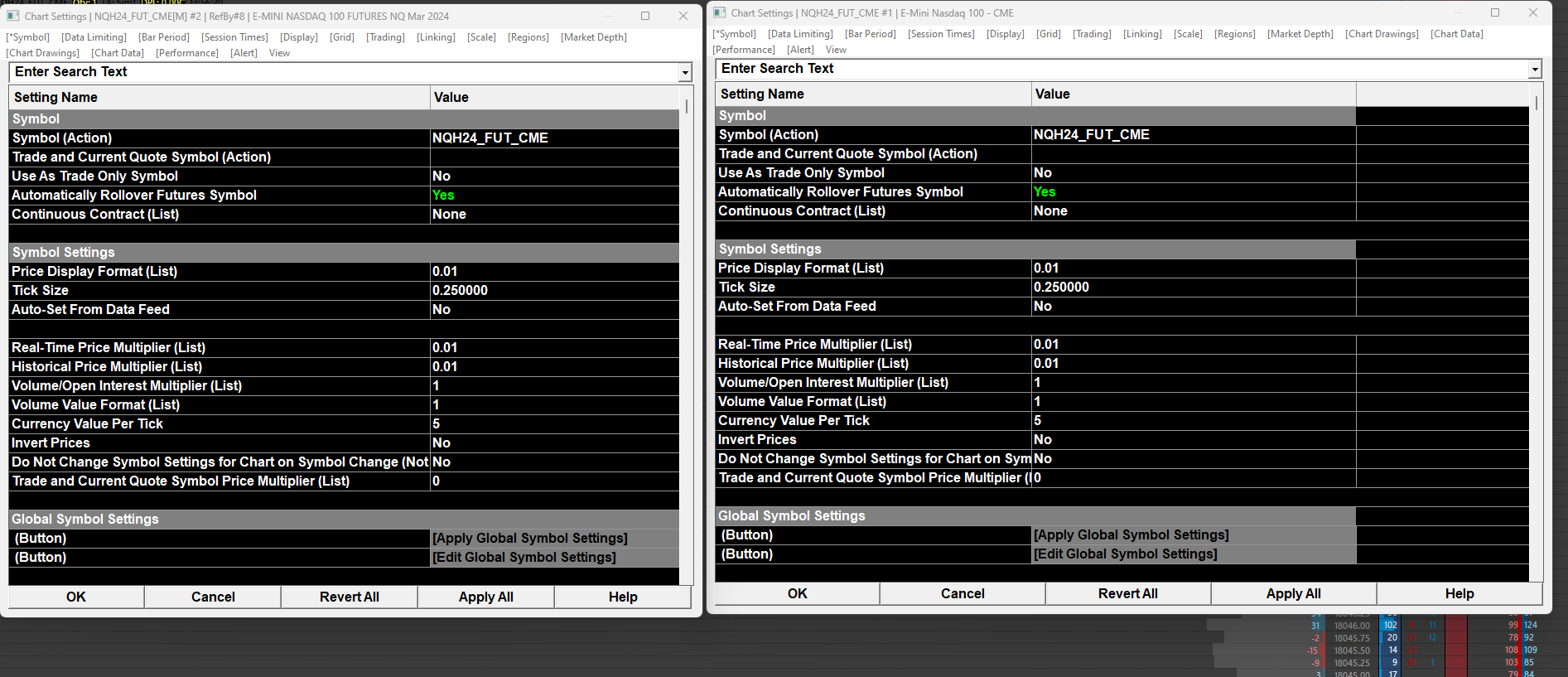

so i decided to take the traded MNQ out of both doms....yet one has a totally different delta than the other...i hsve attached a picture of the data and a corresponding chart setting ...the left chart is the left chart settings and the right chart is the right chart setting...niether have the mnq...and yet the delta is different

[2024-02-22 19:11:52]
You would need to look at the settings for the Volume by Price profiles to ensure they are set to cover the exact same time frame and that the Inputs to display what you want are the same.

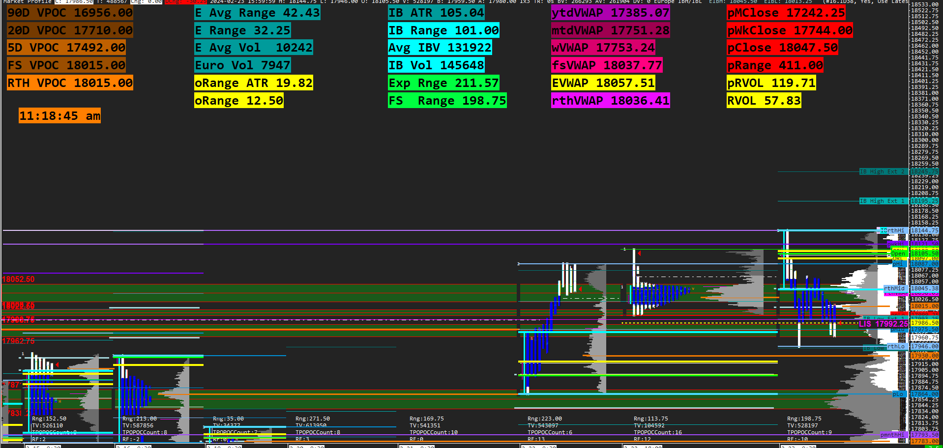

I have some data refelcting on a chart...please see attached....is there a way to have just a seperate chart/page with only these data refernces and calculations listed?

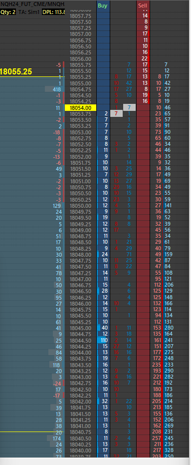

so i have verified all the inouts to match in vp...but it happened at the high of the day...it is impossible to have a 418 delta when only 44 contracts trade....

coachted - Posts: 544
furthermore i have rebuilt the dom multiple times and the correct delta shows on it and then eventually if we get this push and a new hi or low the delta gets messed up...

With regards to the delta of 418, please get us that chart and tell us the date and time when you see that value and the Time Zone setting for the chart (if it is set to Use Global Time Zone, then we need to know your Global Time Zone). Refer to the following for how to get us a chart:
