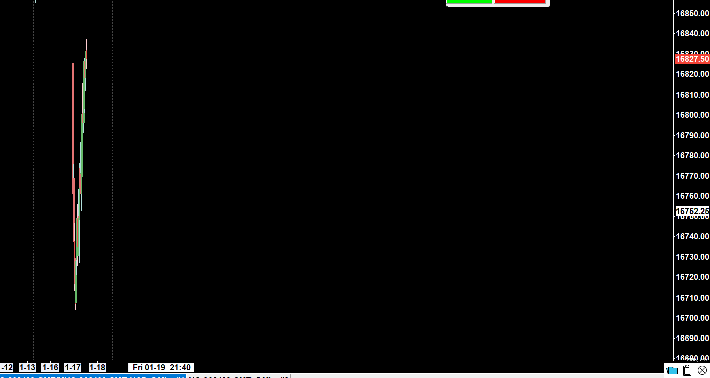

1. When I scroll to zoom out and after a few scrolls back to back, the chart just goes to far left and gets extremely zoomed out. Is there a way for that to not happen? Attaching a screenshot for reference. 2. Zooming on the price axis is also very sensitive. just a lil price axis manipulation makes the chart dance up and down. is there a way for it to be not as sensitive ? I can upload a video incase i didnt phrase it right. Thank you |

Refer to the following setting that should help you: General Settings Window: Scroll Multiplier (Global Settings >> General Settings >> GUI >> Scroll) For the most reliable, advanced, and zero cost futures order routing, use the Teton service: Sierra Chart Teton Futures Order Routing |

1. I have set the scroll multiplier to 0.15. Still not making any difference 2. What about this? What i mean by scrolling on the price axis is by tweaking the scale by mouse left click (not by scroll) |

1. Another option is to use your left pointer and drag the time scale to adjust. Or, you can use the Control Bar keys or the Page Up/Page Down buttons. 2. There is no specific control for this, and we have never seen an issue with how this functions. Do you have your mouse settings such that small movements move the mouse far distances? This could be what is impacting the way this works on your system. For the most reliable, advanced, and zero cost futures order routing, use the Teton service: Sierra Chart Teton Futures Order Routing |

1. Mouse scroll is way convenient and fast to use. Any other option? Another thing i noticed is once it gets extremely zoomed out to the left, the chart locks to the left. when i try to drag it to the right it doesnt come. Can i atleast disable that ? 2. I just tried to lower my mouse DPI and that did make a difference but then my mouse would move so slow everywhere else :/ So annoying. I think mouse DPI shouldnt cause this because I am using two more charting software and i dont have any problems there. |

1. This is not the case. We do not know why you would have this particular issue, but you definitely can increase the bar spacing again. Check to make sure you do not have the option for "Chart >> Lock Fill Space" enabled. 2. The only thing we can suggest is to setup your pointing device so that the scroll wheel will change the spacing in the price ladder. Refer to the following: General Settings Window: Scroll Wheel (Global Settings >> General Settings >> GUI >> Scroll) For the most reliable, advanced, and zero cost futures order routing, use the Teton service: Sierra Chart Teton Futures Order Routing |

1. I was able to figure out why it was going to the left and getting locked. (I had very few days loaded on the chart). I fixed that. But the scroll zoom out is still quite fast to get extremely zoomed out. first couple scrolls seem to be fine then if i scroll again it gets zoomed out extremely. Idk if thats how it’s supposed to be. Scroll zooming in is working fine. No issues there 2. There is no option for scrolling to increase/decrease spacing (i.e :increase/decrease size of the bars) for price axis. The option available is for thr scroll to move the chart up/down. It would be great if i could just hover my pointer to the price axis and use scroll to increase/decrease spacing |
