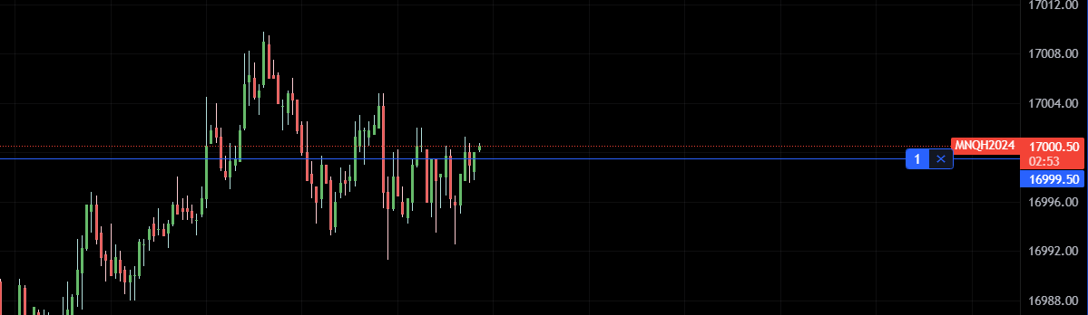

Sierra_Chart Engineering - Posts: 25439
4. This should not be difficult for us to add.

2. I think if there can be an 'x' button besides an open order to cancel then a 'x' button besides a position should not be difficult to add and I think a lot of chart traders will like this feature.
4. That would be great. This is one thing i cant live without. So can you'll please do add it in the upcoming update. (I am attaching a SS for your reference)

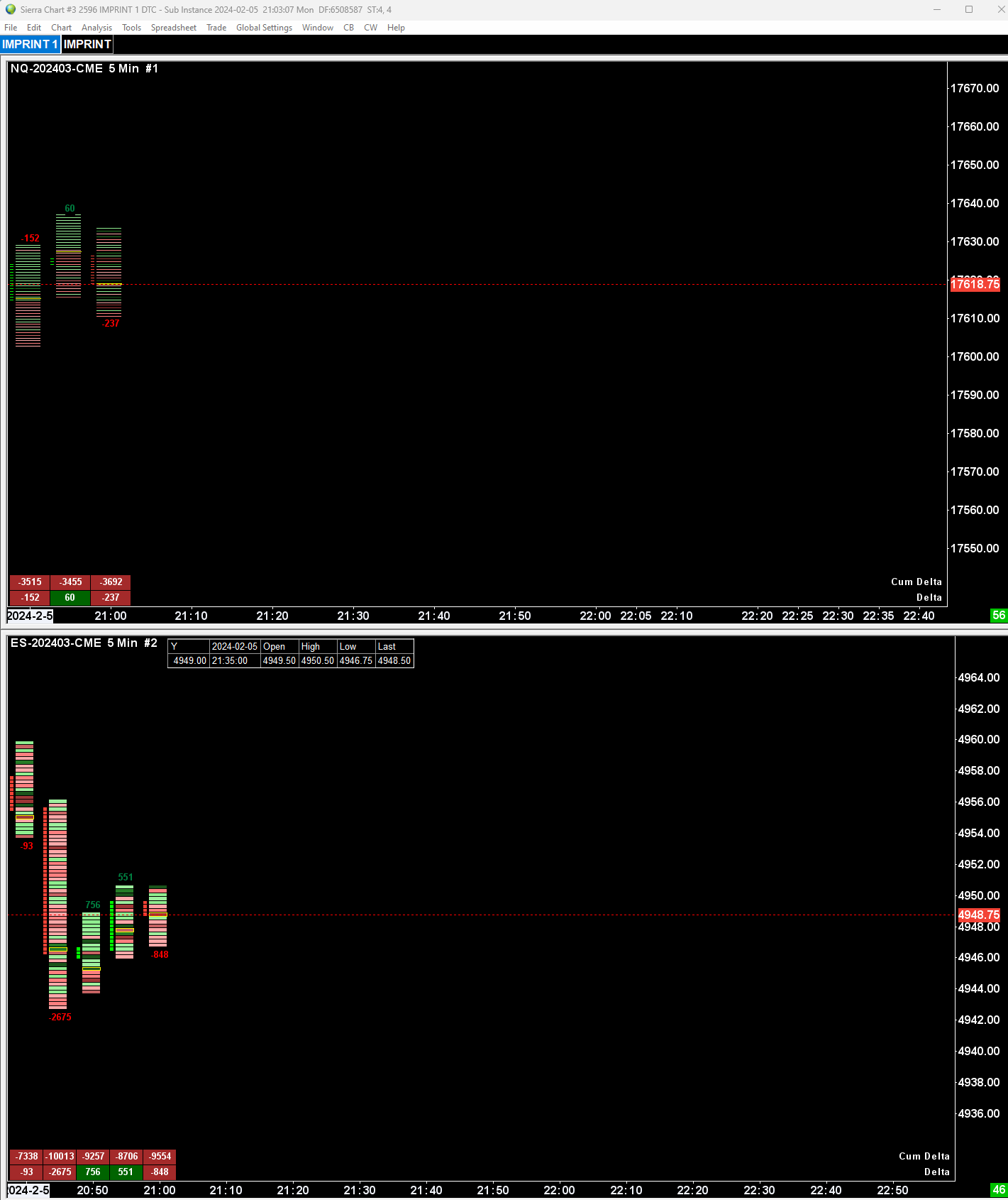

Jimmyy - Posts: 358
I have two charts tiled in one window (attached SS). I want to be able to have compact tools value windows visible on both of them separately, would that be possible to do? Currently, the CTVW only shows up on the chart which is active.
imageScreen Shot Mon 02 5 2024 at 9.03 PM.png / V - Attached On 2024-02-05 15:35:36 UTC - Size: 72.72 KB - 343 views
[2024-02-05 15:51:17]
No, there is only one Compact Tool Values Window.
Date Time Of Last Edit: 2024-02-05 15:51:58
[2024-02-05 16:04:52]
Jimmyy - Posts: 358
Does that mean when I click on the other chart i.e make the other chart active. The CTVW moves from non active chart to the active chart ?
I was assuming that theres two CTVW and just because a chart window is non active the CTVW hides itself.
[2024-02-05 17:56:38]
The Compact Tool Values Window displays the information for the chart where the pointer is located. it does not need to be the "active" chart.
Note that Compact Tool Values Window does not move. It may expand/contract depending on what needs to be displayed for each chart, but the window itself is a single window that keeps a specific position where you have put it.
[2024-02-05 18:08:44]
Jimmyy - Posts: 358
I am uploading a screen recording of what I am trying to say.
I am aware of that. What I'm basically asking is : to have the CTVW visible on both of my charts. They both need to be visible, check the recording :when i click on the upper chart, the CTVW becomes visible of that chart and CTVW of the bottom chart becomes hidden and vice versa. I want them both to be visible always for their respective charts.
Date Time Of Last Edit: 2024-02-05 18:10:47
Private File
[2024-02-05 18:22:30]
As stated previously, there is only a single Compact Tool Values Window, so you can not have it showing for both charts at the same time.
The only way you could do this would be to have another instance of Sierra Chart running.
