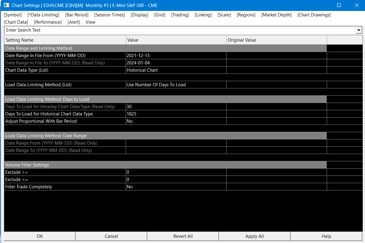

Hello team,
I just realized that my montlhy ES chart has the wrong values when Back adjusted. Im attaching the settings I have there, and the current chart, where it is clear that last December was not the ATH according to my data, same goes to my Weekly chart, basically the two historical charts I have.
Any ideas?
I tried Deleting and Downloading the data again, same situation.
Thank you!
imagees-settings-historical.png / V - Attached On 2024-01-05 08:36:59 UTC - Size: 50.21 KB - 227 views
imagees-montly-settings.png / V - Attached On 2024-01-05 08:37:05 UTC - Size: 55.32 KB - 156 views
imagees-weekly-backadjusted.png / V - Attached On 2024-01-05 08:37:16 UTC - Size: 123.7 KB - 203 views

You are using Back-Adjusted data, so the data from December has been shifted from the actual values in order to line up with the following contract. Refer to the following regarding Back-Adjustments:

Sorry but I still dont get it, I thought that using back-adjusted data would then adjust the past prices, so for this case, I would see the December 2023 high as the ATH, however I still see the ATH as January 2022. What could I do to achieve what I thought it was the expected behaviour?
Thank you!
[2024-01-08 16:27:54]
Back-Adjusting is going to adjust each and every contract such that the contract lines up with the newer contract. This means there is a multiplicative effect as you go further back in time, as each adjustment for newer contracts requires an additional adjustment for the contract before that.
So we are not sure what data would end up exactly where, so we are a bit confused why you would expect any particular date to be the ATH, when you can not know the adjustment amounts ahead of time. If this is not what you want, and you want to view the data exactly as it was at that point in time, then do not use the Back-Adjusted option.
