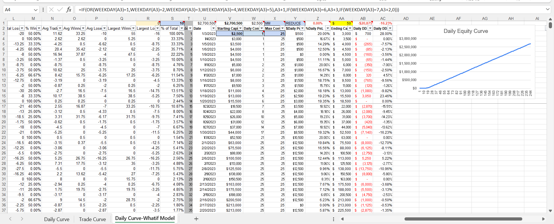

To address your dilemma on how to find missing days in TAL, here's what I do in Excel.
Step1:
Cell A2 enter "Period"
Cell A3 enter 1/3/2023 (first trading day of the year)
Cell A4 = =IF(OR(WEEKDAY(A3)=1,WEEKDAY(A3)=2,WEEKDAY(A3)=3,WEEKDAY(A3)=4,WEEKDAY(A3)=5),A3+1,IF(WEEKDAY(A3)=6,A3+3,IF(WEEKDAY(A3)=7,A3+2,0)))
Drag this formula to next 260+ rows to give you all the weekdays
Step2: delete rows when CME holidays. This will give you your actual trading days throughout the year
(Step1 and 2 is required only once to save it in excel for repeat use)
Step3: After each replay run, copy all from Period tab and paste it in Column B to quickly determine if there are any missing days :-)
Protip: All this should be part of your overall equity curve analysis. Attaching a screenshot since I am in the mood to share today.
Date Time Of Last Edit: 2023-12-04 23:19:06
