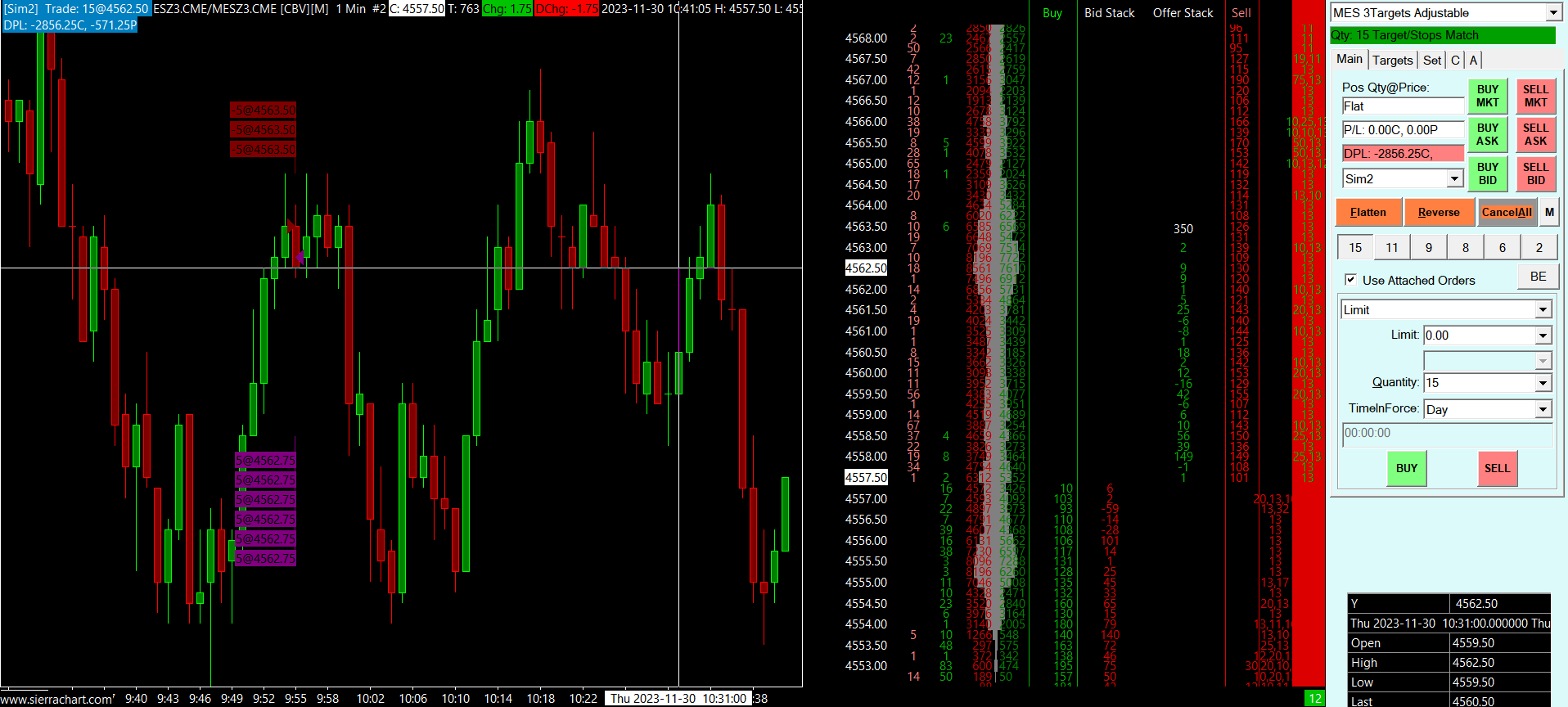

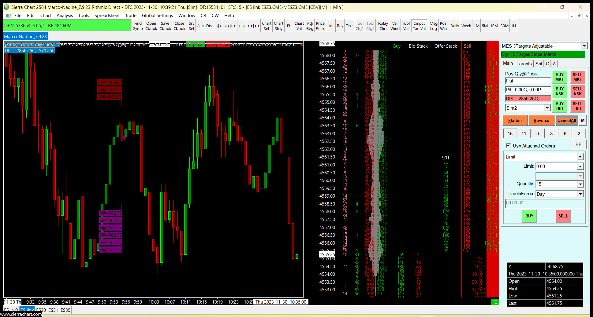

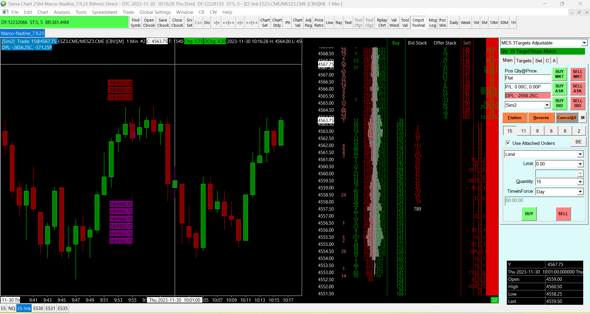

I placed a SIM order of 30 ES micro contracts and was negative over $2800 at a 0.75 tick draw down. Can you please help me trouble shoot what the issue may be here? I have attached files to assist with trouble shooting the situation.

Thank you for your help. What the log shows does not make sense. It looks like incomplete trade data. Can you please review the attachment and advise?

Yes, but more specifically, how the three-tick drawdown on MES contracts ended up being over a $2800 loss. The drawdown should have been $56.25 in total. This is a concern for taking future real account trades.
