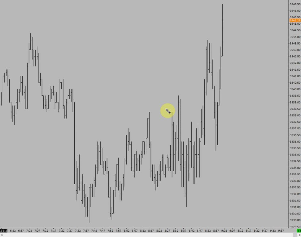

[2023-03-02 16:44:14]
User431178 - Posts: 909
Seems possible to make something.
imagereward_risk.gif / V - Attached On 2023-03-02 16:40:46 UTC - Size: 2.16 MB - 798 views

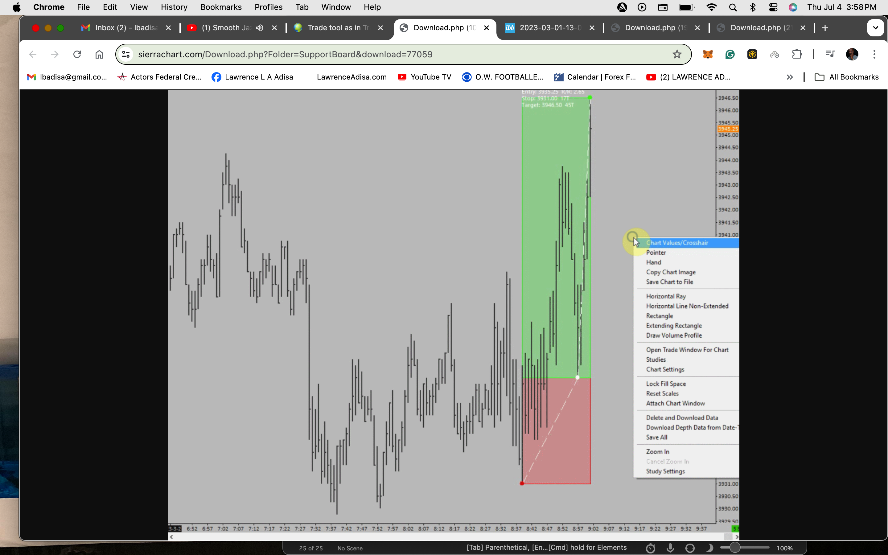

LAdisa - Posts: 17
I was hoping that there was a good conclusion to this inquiry. It seems many fellow traders are looking for a basic upgrade to the R/R reward tool. Has that been achieved yet? User431178 shared a gif in this thread of a version that would work great. If you read this User431178 could you please share? Thanks.

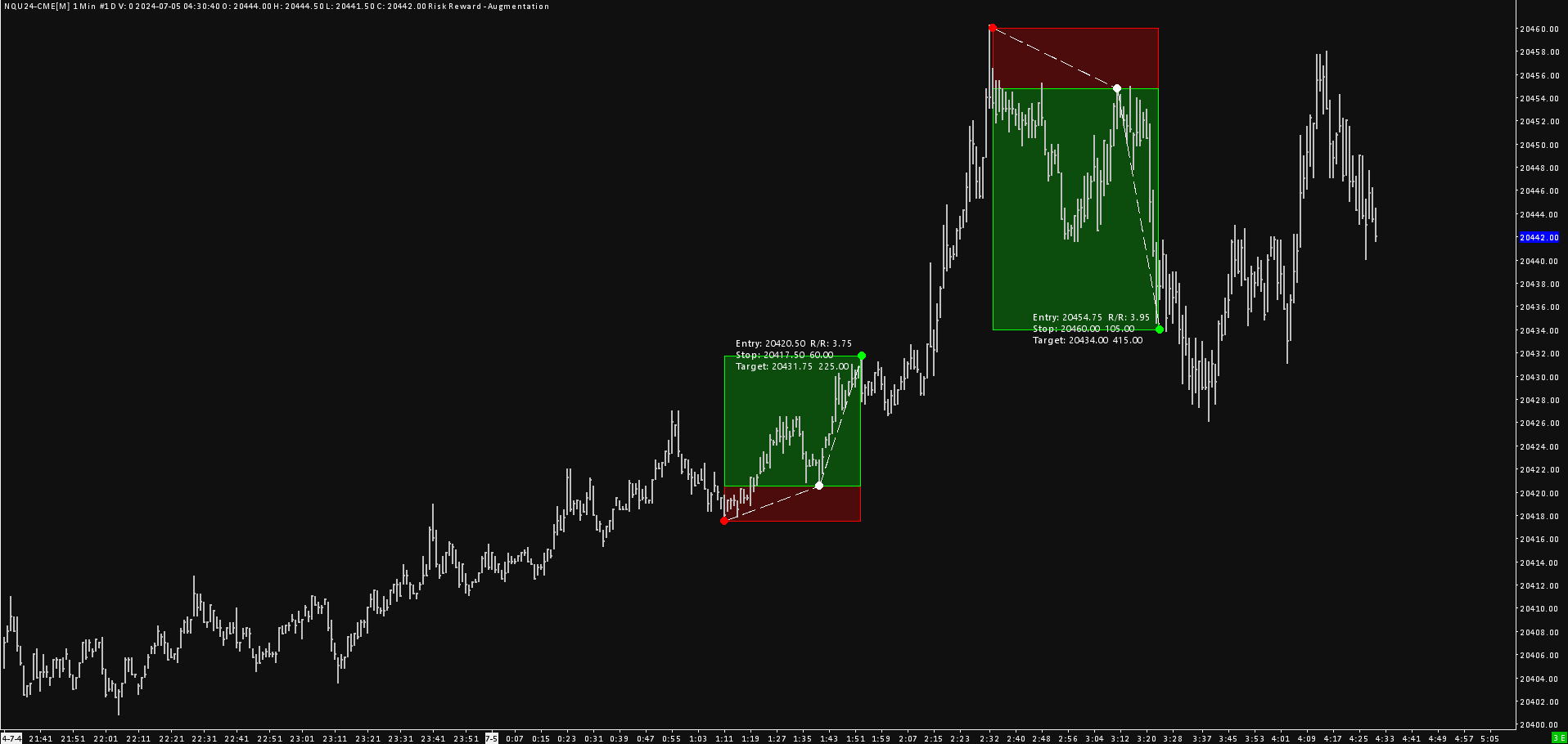

[2024-07-05 09:07:01]
Here you go, not as good as a native tool for sure.
Risk Reward - Box uses chart drawing tools to add r:r boxes to most recent r:r drawing
Risk Reward - Augmentation uses ACSIL graphics interface to add boxes to all visible r:r drawings
Not sure they are the most performant solutions, especially if you have lots of other user added drawings.
Risk Reward - Augmentation should only be used with OpenGL as this has alpha channel (transparency) implemented.
Maybe I could do a native GDI version so transparency works without OpenGL, but this is enough for now.
