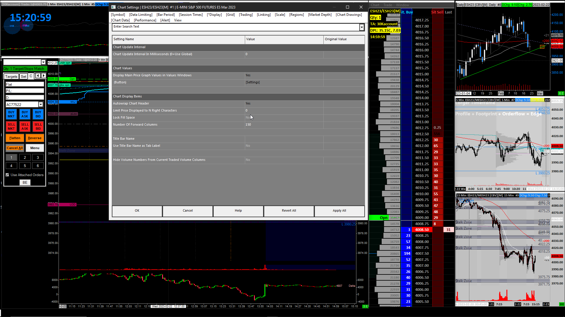

User547290 - Posts: 89
No difference,
All charts are set to zero, (no delay)
The attached image is the Ladder settings
I tried the replay mode and is the same.
imageEpicPen_bihX6ajBs9.png / V - Attached On 2023-02-22 22:24:57 UTC - Size: 189.94 KB - 204 views

[2023-02-23 14:33:05]
Is there something in Global settings that could affect this?
Yes, the Chart Update Interval. When the Chart Settings is set to 0, that means to use the Global Chart Update Interval. You need to check this value on both installations. The setting is located at Global Settings >> General Settings >> General >> Chart Update Interval. Refer to the documentation for this here:
General Settings Window: Chart Update Interval in Milliseconds (Global Settings >> General Settings >> General >> Update Intervals)

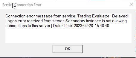

[2023-03-01 00:48:21]
The session times are fine. I set the Current Selected Service to : Trading Evaluator from (delayed) and the charts freeze for 10 minutes and then they start moving delayed 10 min, even though I set the Service from Delayed [trading] to [trading].
It's not session times.
I get the attached notice every session when using the Trading Evaluator
imageEpicPen_c9oB5j5mEv.png / V - Attached On 2023-03-01 00:46:49 UTC - Size: 91.33 KB - 174 views
imageEpicPen_DbEPQ97lG2.png / V - Attached On 2023-03-01 00:46:57 UTC - Size: 7.44 KB - 165 views
[2023-03-01 11:31:08]
Make sure you have enabled:
Set "Global Settings >> Data/Trade Service Settings >> Common Settings >> Allow Support for Sierra Chart Data Feeds" to Yes.
You also need to update Sierra Chart. You are running an older version:
You can safely ignore that notice with the Trading Evaluator if it occasionally occurs.
