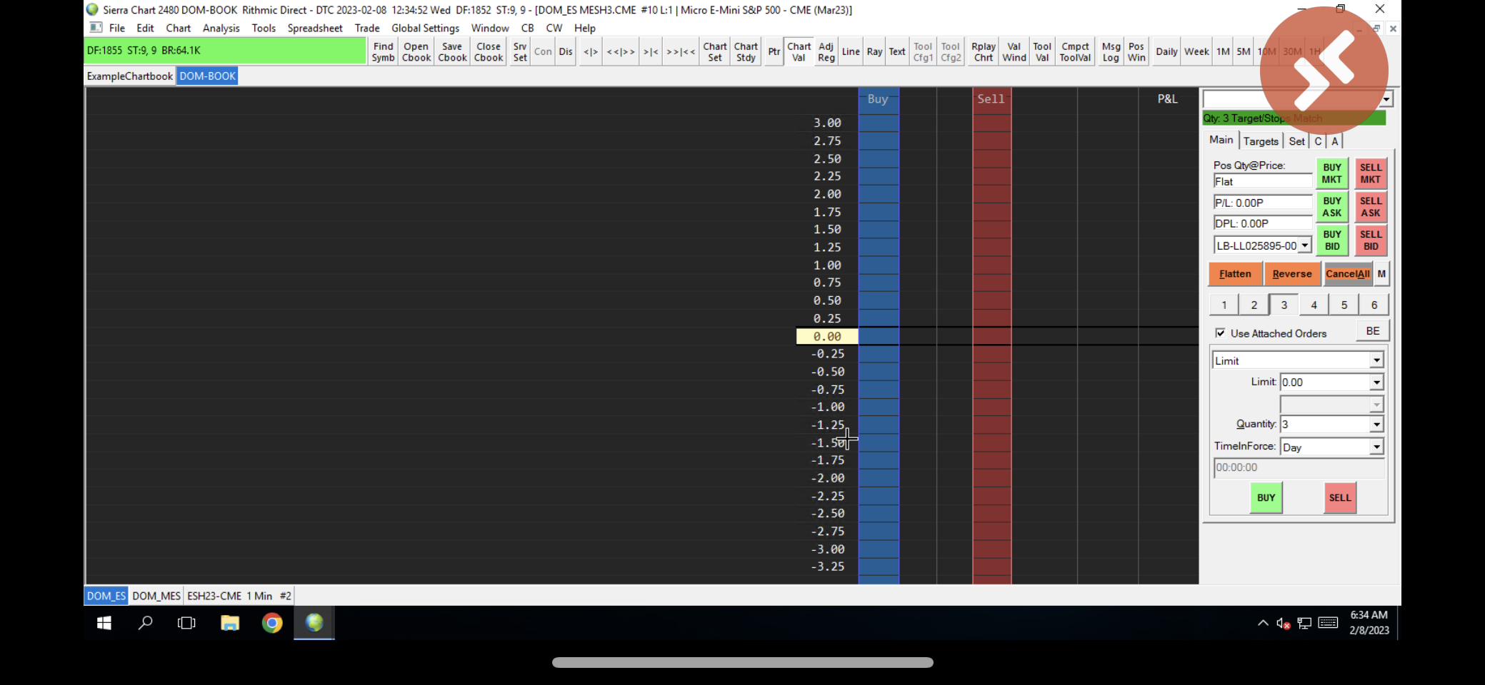

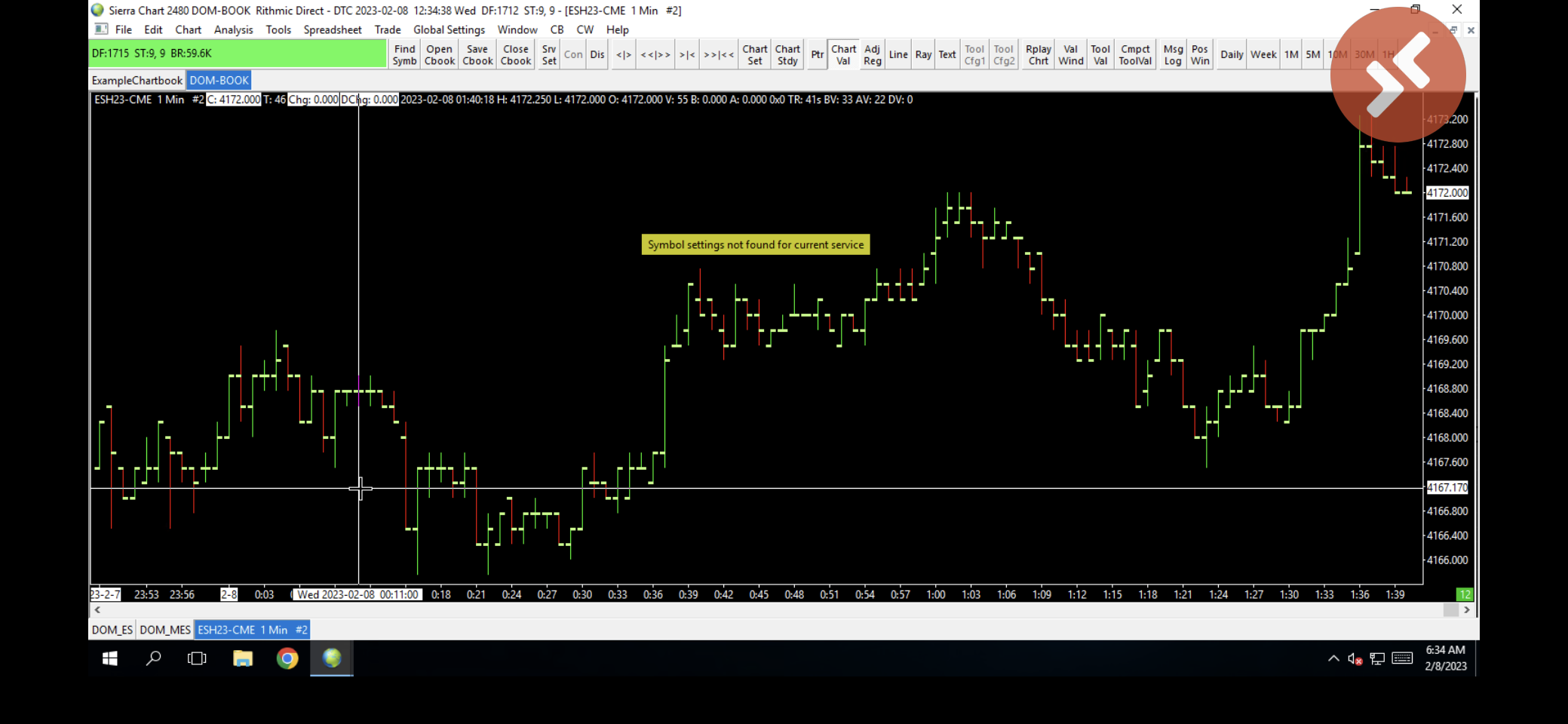

Thanks for the reply! I got rithmic set up and I believe I am connected. However, I am not seeing data actually come through on the screen. I have attached screenshots to show the issues I’m having.
image3DBFE5AF-6F5B-4D7B-8C93-85D245C09006.png / V - Attached On 2023-02-08 12:41:15 UTC - Size: 613.42 KB - 254 views
imageEB22B040-EAF0-4572-9A38-1732474E7736.png / V - Attached On 2023-02-08 12:41:29 UTC - Size: 656.21 KB - 279 views

You need to change your symbols to what is used by Rithmic. To do this, open your Chartbooks and select Edit >> Translate Symbols to Current Service.
[2023-02-08 16:45:24]
Here is the relevant documentation:
Edit Menu: Edit >> Translate Symbols To Current Service
