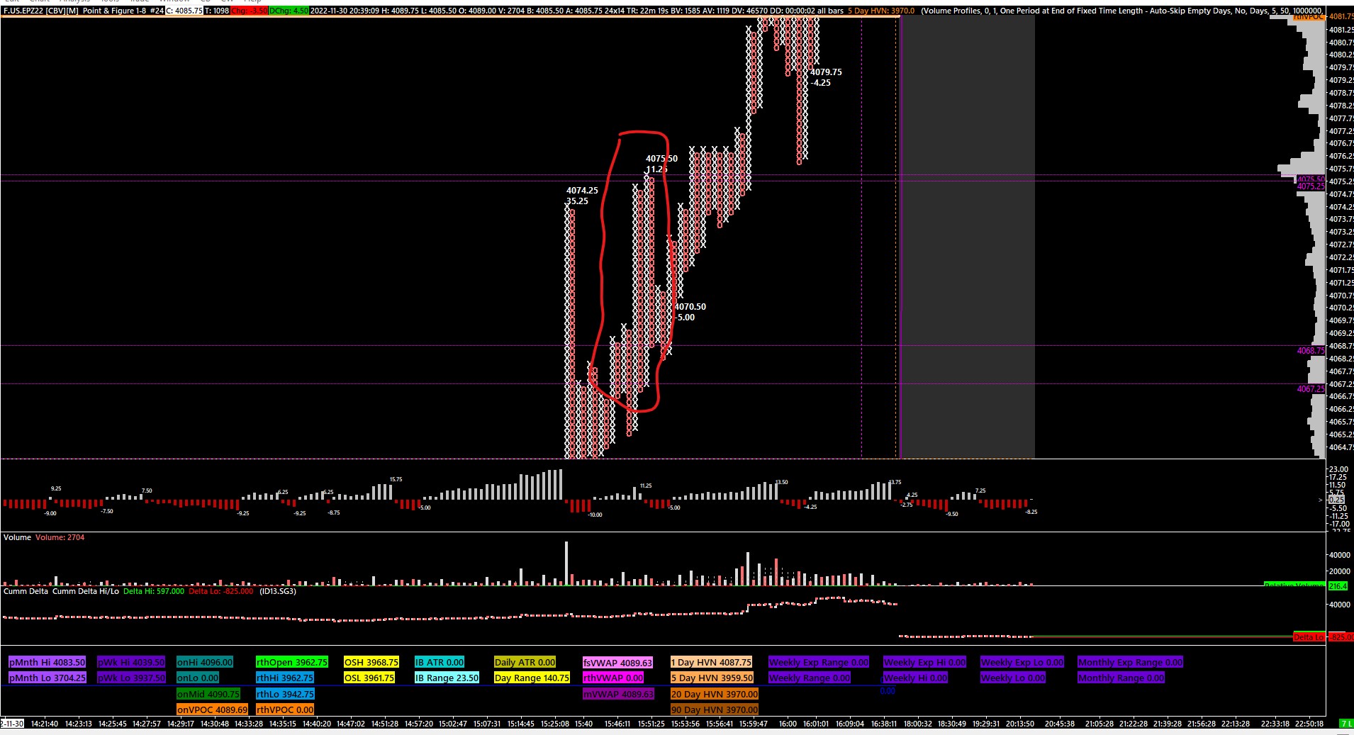

i have a footprint chart with a point and figure 1-8 setting and at the same time i have a regular point and figure 1-8 chart...why woulld the length of the bars be different
[2022-11-30 16:41:59]
They should not be different unless there is some difference in the settings between the charts.
Can you please give us screenshots of the two charts so we can see exactly what you are referring to. Follow these instructions to take a screenshot:
[2022-12-01 01:43:11]
coachted - Posts: 544

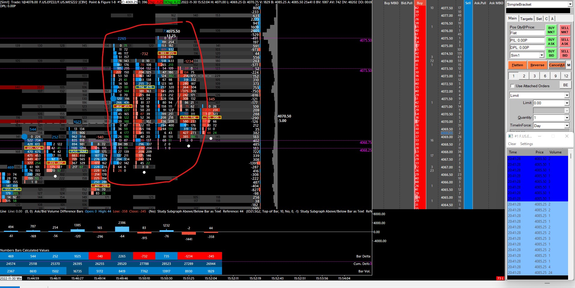

please note the first screen shot is a pnf chart 1-8...you can notice the bar pattern circled....for instance there is a bar with a zig zag above it 4075.5 ...11.5 the low of that bar is marked with a horizontal line = 4067.5 and the high is 4075.50..the bar next to this shows a low of 4068.75 and a high of 4075.25
the 2nd screen shot is a footprint chart with the bar type set as pnf 1-8 yet the bars look much different...notice the first bar is the same time as the pnf chart and yet the low is only 4068.25 and the second bar referrenced on the pnf chart shows a high of only 4073.5...
imageScreenshot 2022-11-30 203929.jpg / V - Attached On 2022-12-01 01:39:40 UTC - Size: 362.76 KB - 329 views
imageScreenshot 2022-11-30 204256.jpg / V - Attached On 2022-12-01 01:43:06 UTC - Size: 428.63 KB - 411 views

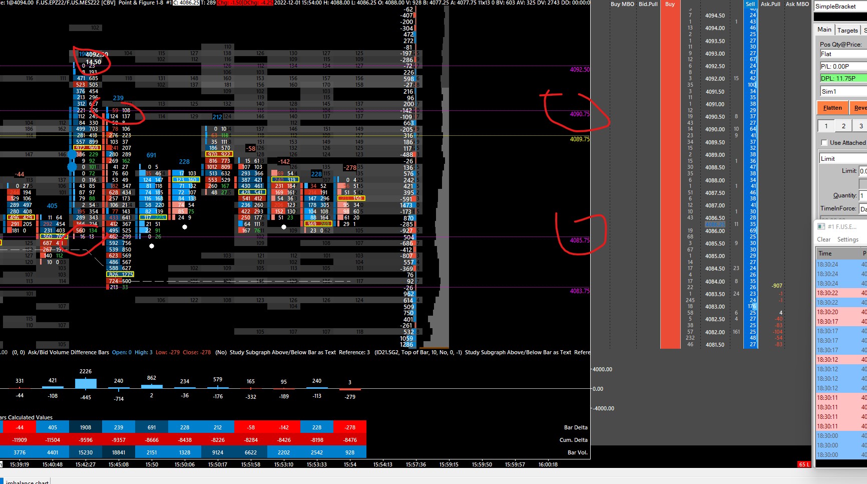

i made the change and it doesnt make a difference as you can see the bar length is still different
imageScreenshot 2022-12-01 183106.jpg / V - Attached On 2022-12-01 23:32:01 UTC - Size: 381.42 KB - 306 views
imageScreenshot 2022-12-01 183023.jpg / V - Attached On 2022-12-01 23:32:10 UTC - Size: 363.65 KB - 347 views

You can not look at the High and Low of the PnF X-O bars as the actual High/Low. Refer to the following:
Point and Figure Chart: Why Point & Figure Columns Do Not have the Same High/Low As The Underlying Bars
Your underlying bars (which is what we looked at yesterday) do match up correctly, it is just a display difference due to how the X-O bars are drawn.
