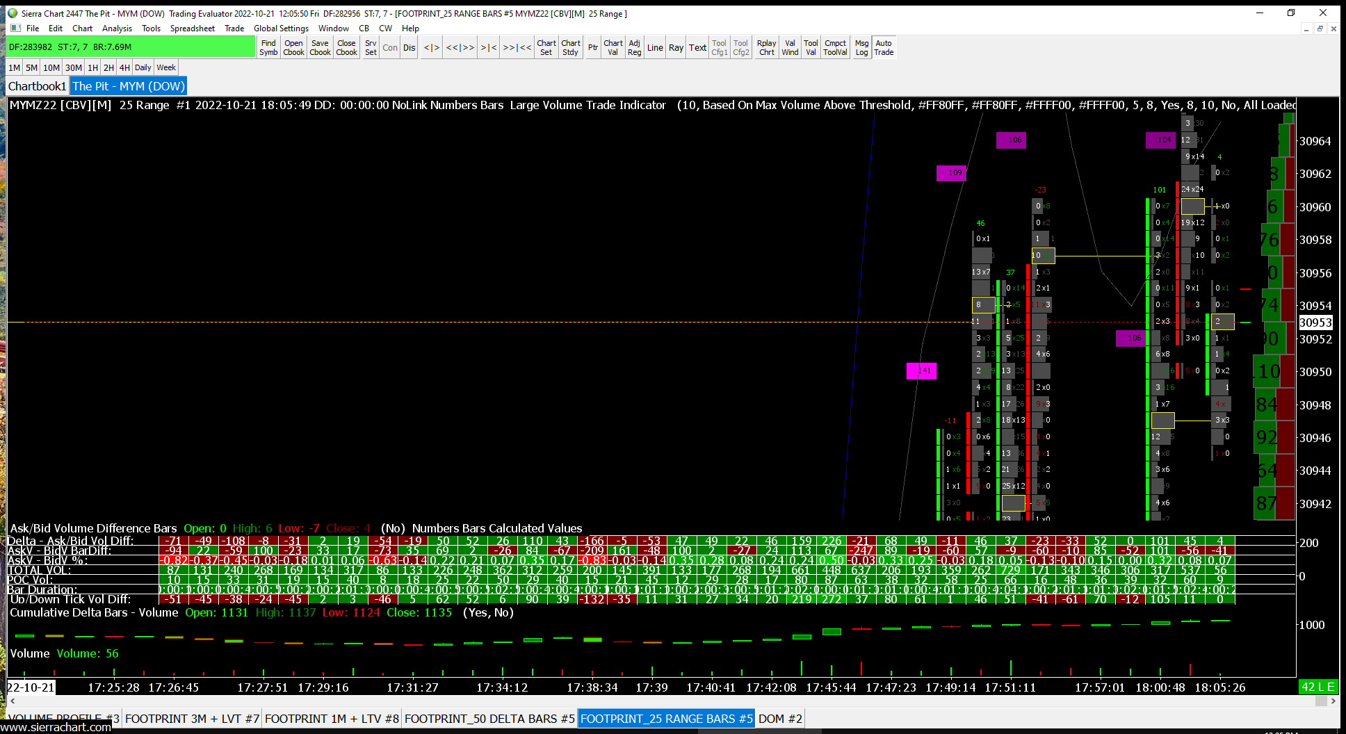

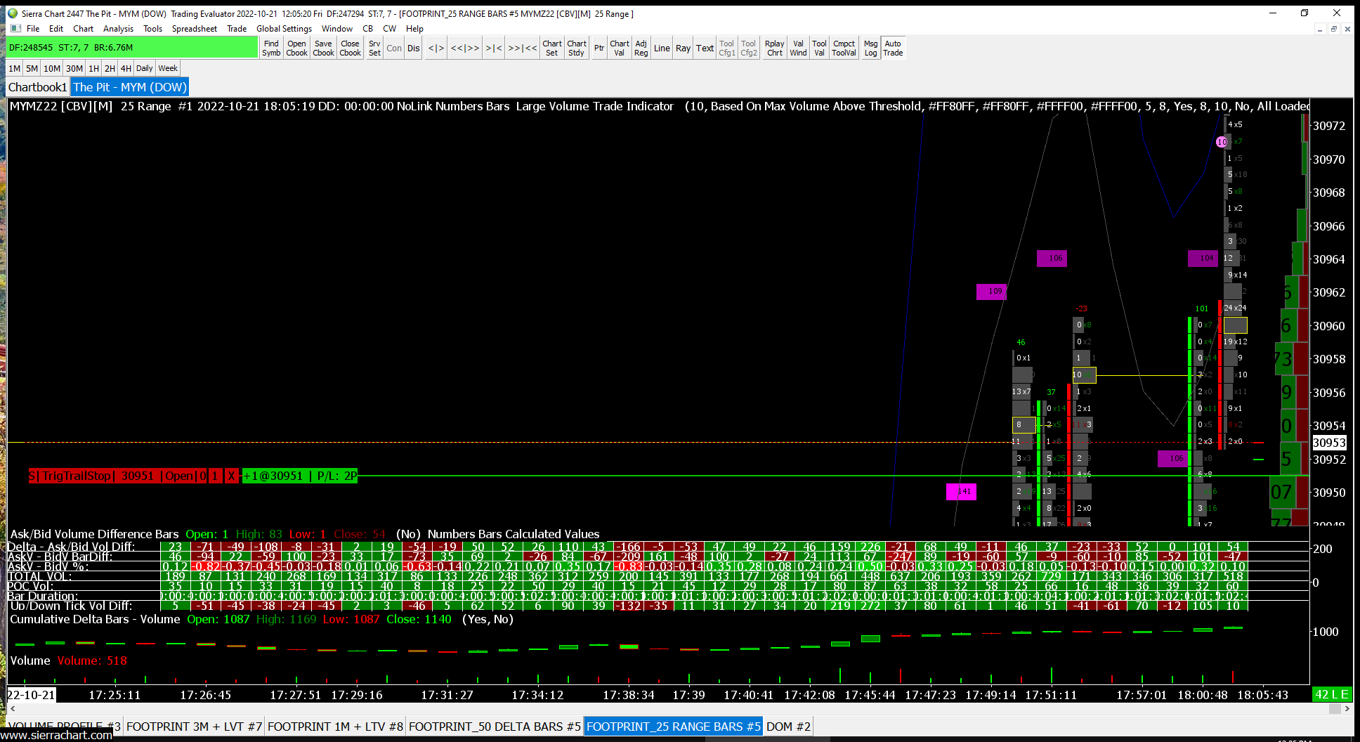

We just tried the MYM chart with our Simulated Futures Trading and everything is working as it should.
Here is an image of one of the Numbers Bars charts showing the position line
https://www.sierrachart.com/image.php?Image=1666371921799.png
But, we did notice that since this particular chart is setup with scaling as a Constant Range, the position line can easily move off the screen, as it then looked like the following a few seconds later:
https://www.sierrachart.com/image.php?Image=1666371952152.png
We do not know that this is the issue, but we are wondering if this is another possible reason for what you are seeing?
