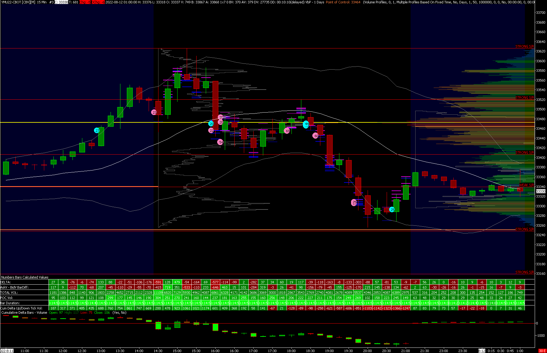

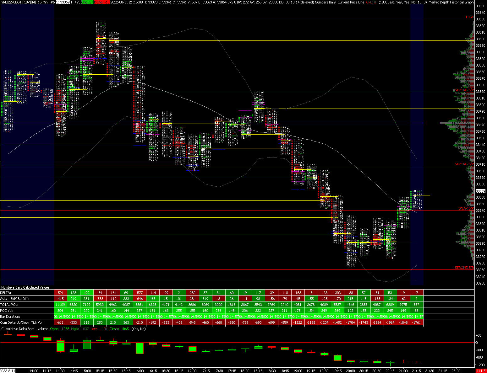

'Cumulative Delta Up/Down Tick Volume' (SG47) in 'Numbers Bars calculated Values' study showing different totals on 15M Candlestick bars Vs 15M Numbers Bars for YMU22-CBOT.
Therefore, I do not know which one is correct.
The chart setup is otherwise exactly the same, and settings are set to 'NO' for:
- Combine Trades Into Original Summary Trade (Data Feed and Exchange Specific)
- Reset Day Calculations At Both Session Start Time.
(Yes I checked other posts/questions)
The totals for 'ALL' other stats in 'Numbers Bars calculated Values' on both charts are all correct/consistent (Delta, Total Vol, AskV-BidV Bar Diff, POC Vol). If the other subgraphs relating to volume were also different this MAY make more sense - but they aren't.
INFO:
- Issue is every day
- 'Numbers Bars calculated Values' Study is exactly the same across all charts - I created a default setting then added it all all my charts so it's consistent.
- Continuous Futures Contract - Volume Based Rollover, Back Adjusted (Both charts)
Numbers Bars Screen
https://www.sierrachart.com/image.php?Image=1660651046366.png
Candlesticks Screen
https://www.sierrachart.com/image.php?Image=1660650648849.png

Actually, the "Cumulative Delta Up/Down Tick Volume" in the Numbers Bars Calculated Values are different. So there is something going on in terms of the underlying data not being exactly the same. There is something in the Chart Settings that is different, so you would have to go through and look at all the options to figure out what is different.
The easier thing to do would be to duplicate one of the charts and then add/remove the Numbers Bars to have the identical charts. You should not have any issues with the data being the same when you do this.
