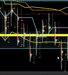

Hi, I'm interested in recreating this chart. It is just volume profiles with delta bars in between showing the relative volume of aggressive buyers vs. aggressive sellers.
Is this possible in Sierra Chart and if so what study would I use to create it?
Thanks...
(I uploaded a screenshot of the chart)
imageimage.png / V - Attached On 2022-04-22 13:20:51 UTC - Size: 93.97 KB - 303 views
[2022-04-22 15:04:10]
John - SC Support - Posts: 48239
It's very hard to tell from the small image, but you should be able to reproduce what you want using the Numbers Bars study and using 2 columns to get Volume Profiles and the Deltas. Refer to the following:
Numbers Bars
[2022-04-22 17:38:06]
Tonkadad - Posts: 235
youtube, type in "sierra charts volume profile" set filter to 1 month, should get you started. Also Bishop from "The Pit" is another resource.

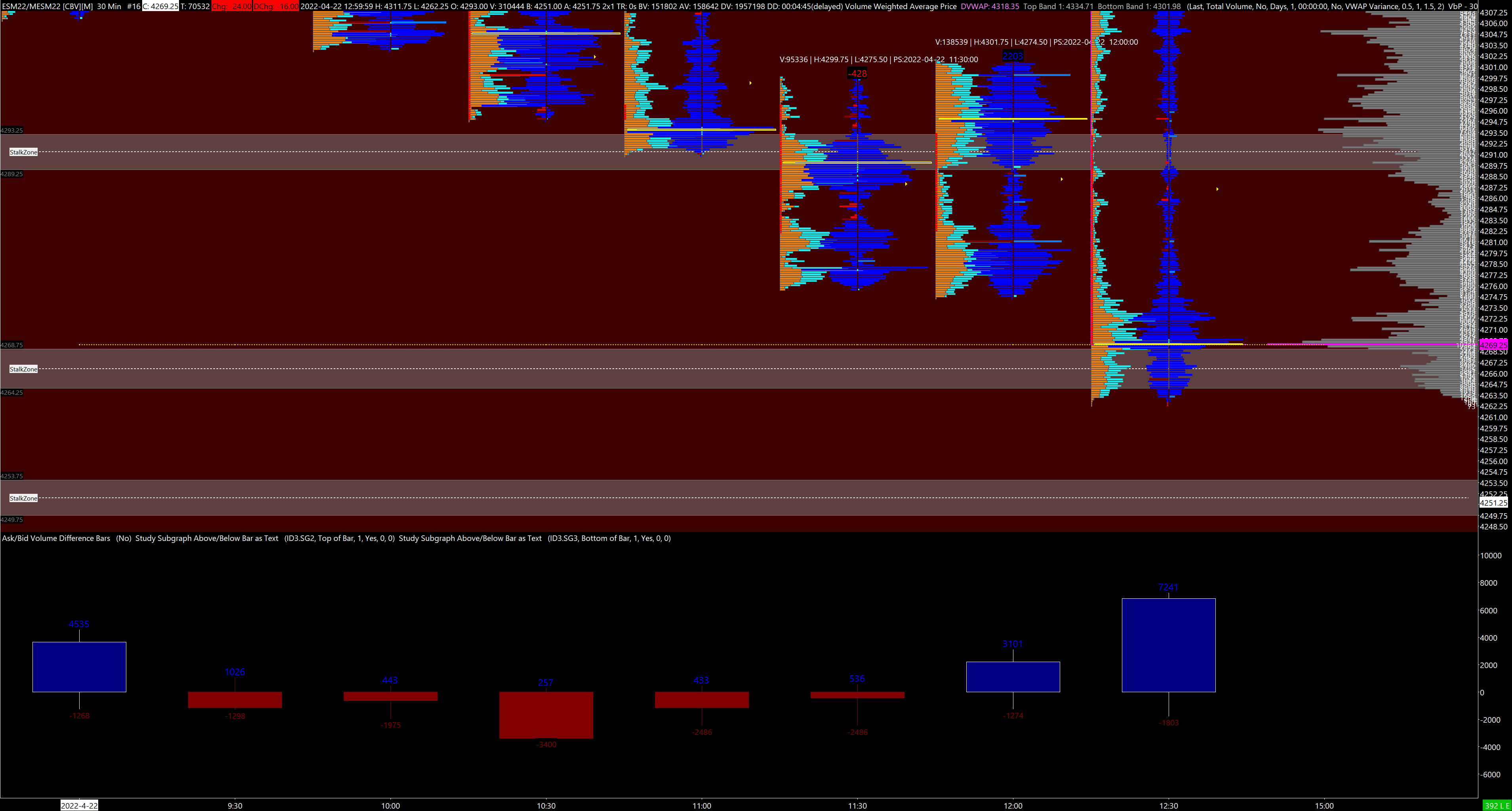

Okay I figured it out, but I've got some overlapping of the volume profile and the delta that I can't get rid of. I've uploaded a chart image. I tried increasing the bar space but that didn't work.
https://www.sierrachart.com/image.php?Image=1650685426462.png
Date Time Of Last Edit: 2022-04-23 13:55:39
[2022-04-24 15:16:11]
User148596 - Posts: 217
Hi apologies for the additional message but I had a typo on my last message that made it look like I had fixed the issue but I haven't. Just curious if you can help me to separate volume profiles from TPOs so that they don't overlap. And I'm having the same issue with numbers bars and volume profiles overlapping too so hopefully there's a fix that will apply to both those situations.
[2022-04-25 14:40:05]
Unless you have a need for the full Volume by Price study for each bar, we would recommend using two columns for the Numbers Bars study. One column would be a standard profile and the second column would be what you have now.
Otherwise, if you need the full VbP then you would need to adjust the length of the bars using the Inputs starting here:
Volume By Price Study: Maximum Volume Bar Width Type
