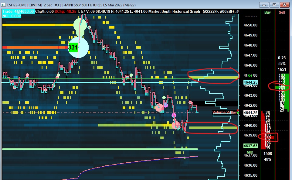

Version 2333, ESh22. Someone has been constantly moving a heavy bid and ask a couple of points away from the market. I circled the bid/ask areas. If you notice the market depth historical graph where I circled, the graph is not keeping up with the bid/ask changes. Is this normal?

Is your chart scrolled all the way to the end? We can not see the indicator in the bottom right corner to know if it is or not. Refer to the following to know if you are scrolled to the end or not:
Working With Charts: Chart Settings Indicators at Lower Right of Chart
If it is scrolled to the end, then make sure you are displaying the Last depth and not the Max depth for the Market Depth Historical Graph. Refer to the following:
Market Depth Historical Graph: Use Last Quantity Instead Of Max Quantity For Bars
[2021-12-14 16:55:27]
conr - Posts: 204
Yes, it is all the way to the end(green indicator). And it is set to Last Depth.

We are working on it. It looks like there may be something in the Market Depth Historical Graph code that is not setting the Maximum depth correctly. But we need to spend some more time on it.
[2021-12-16 15:41:36]
The problem came up with the latest release where we introduced a few changes to the Market Depth Historical Graph. The particular issue is that it is not picking up the proper Maximum/Minimum depths when using Actual Values for the Threshold Levels.
We are working on a fix and will let you know when we have it ready.
