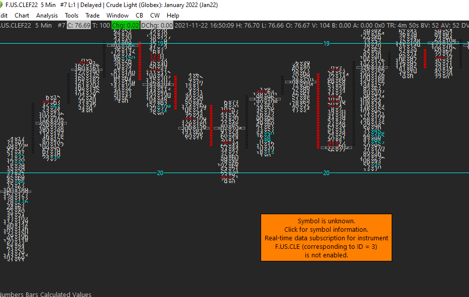

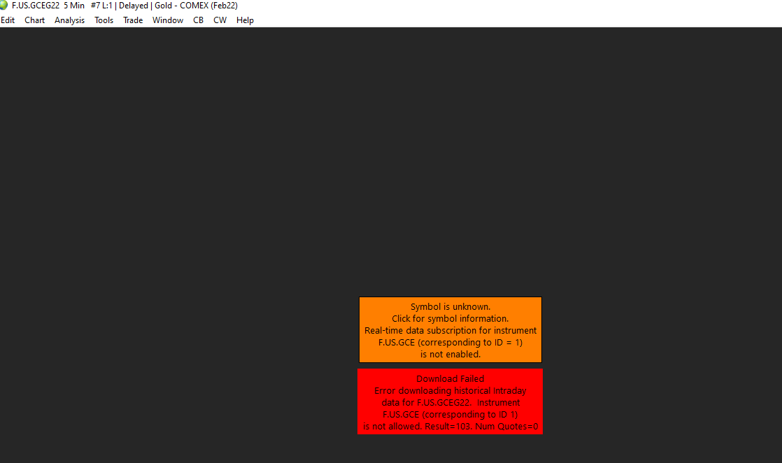

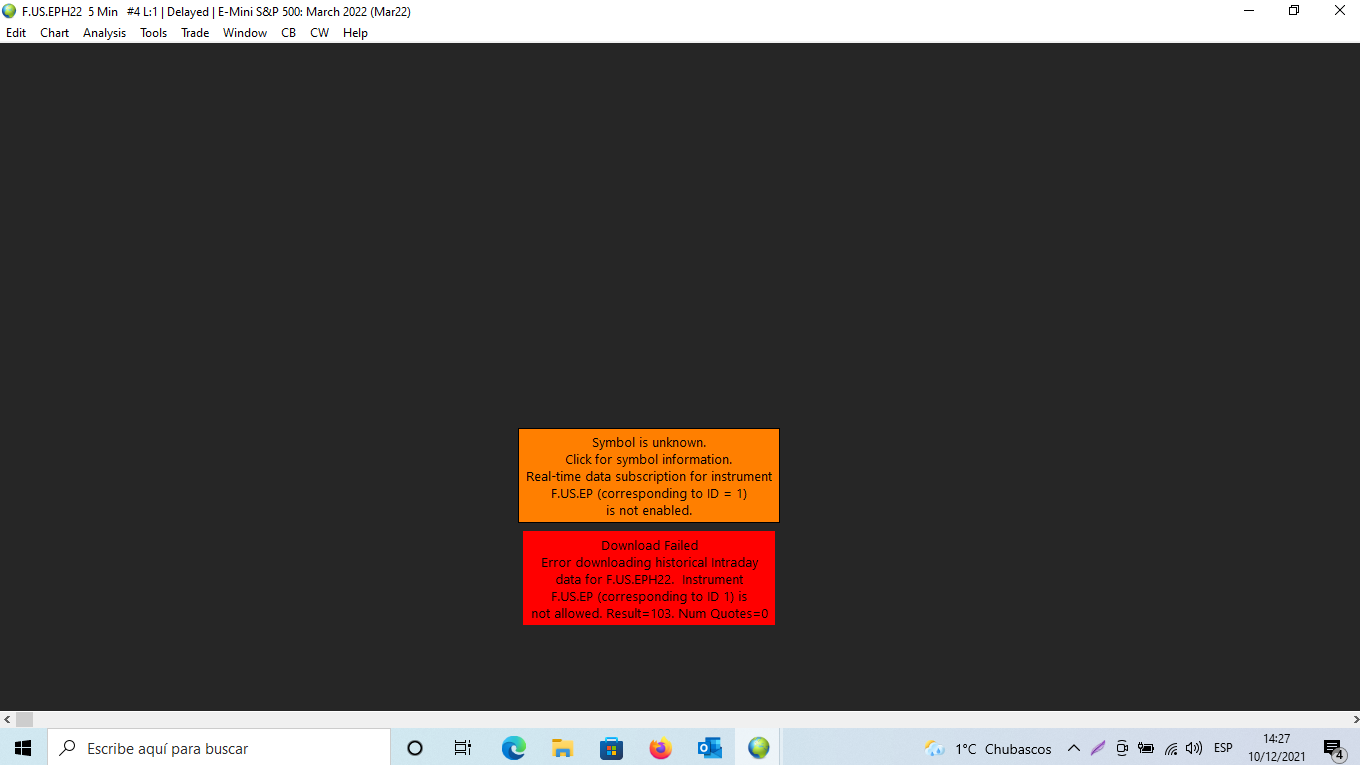

Dear Sirs,
I have the automated ROLLOVER active but when I started my Sierra today I can not see any contract. A weird error appears (please check pictures attached "Download failed. Result = 103. Num Quotes = 0" ). Till last month everything was working fine. It seems there is some problem with Rollover to the January/March contracts.
Can you please provide a solution?
I check and AMP balance is correct, my Sierra chart subscription is also correct and Data feed is Green. I don't know what else to do or where the problem is. As you can see in the pictures the error appears in all 3 assets I trade CL, GD and ES
I found few threads with similar problems and they have problem with Data Feed, but my Data Feed was ok, I was using last month (November) with Dezember contract without problem, the Rollover to the new contracts is not working.
Thank you in advance
Kind regards
David
imageError Sierra CL.png / V - Attached On 2021-12-10 14:02:07 UTC - Size: 56.72 KB - 275 views
imageError Sierra ES.png / V - Attached On 2021-12-10 14:02:11 UTC - Size: 62.14 KB - 277 views
imageError Sierra GOLD.png / V - Attached On 2021-12-10 14:02:16 UTC - Size: 17.75 KB - 303 views

The reason why you are getting those messages is because the exchange you had activated for the Denali Exchange Data Feed did not automatically renew on December 1, 2021. And since you are not setup to get the data from CQG, you are getting those error messages.
To fix this, just activate the exchanges you want at the following link:
https://www.sierrachart.com/UserControlPanel.php?page=DenaliDataFeed#Exchanges
Quite honestly, we have no idea why you were not getting these messages starting on December 1, 2021. You really should have been.

The first thing you need to do is to let your broker know that you are no longer getting access to the data. Let them know the error message you are getting. That error is from CQG and indicates you are not setup to get data from CQG for some reason.
Second, you are on Package 11, which is why we assumed you were wanting to use the Denali Exchange Data Feed. You do not need to be on Package 11 if you are connecting to CQG. You can change your Package to Package 5 at any time.
