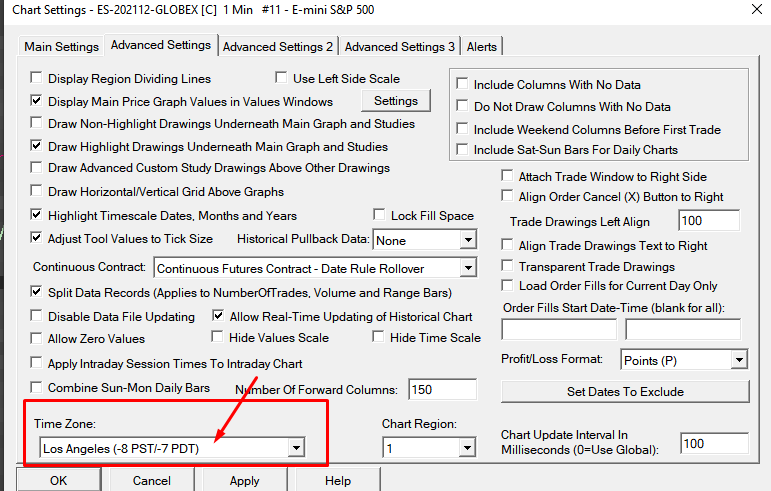

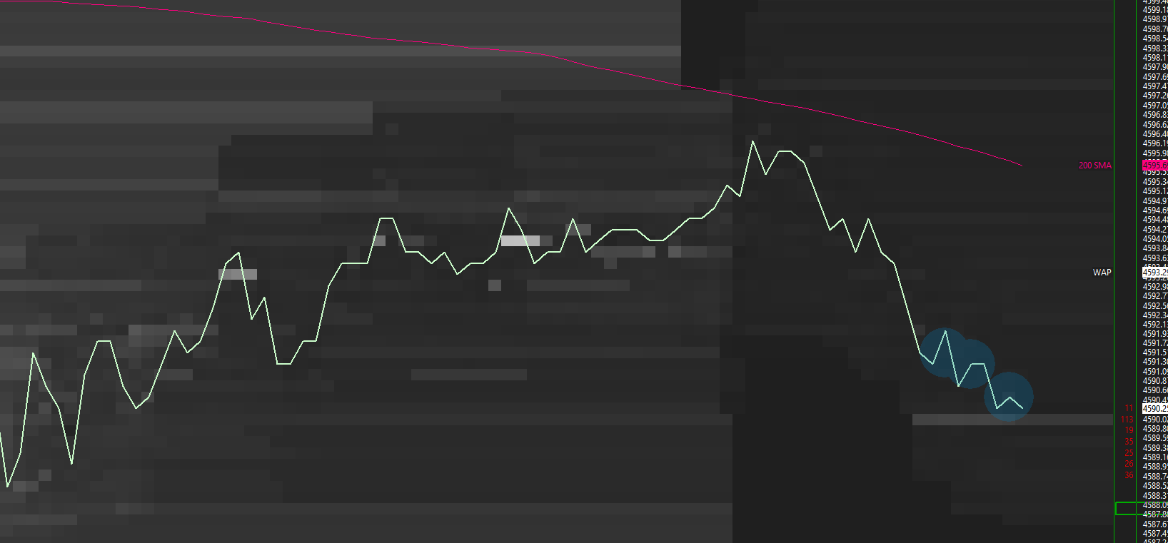

i have market depth chart that i have been setting up all night. (thats also frustrating, wish we could just a sample chart book to start with).
why isn't last stair step on close working ?
it was working during early AM (from 10 PM PST until 3 AM PST while i was setting it up, it was working find)
woke up this morning to see it work when i load the chart but only for a few seconds and then it stops.
why? super frustrating
imagesettings.png / V - Attached On 2021-12-06 16:18:34 UTC - Size: 44.18 KB - 305 views
imageimage_2021-12-06_01-29-32.png / V - Attached On 2021-12-06 16:18:41 UTC - Size: 28.96 KB - 241 views

ephi144 - Posts: 57

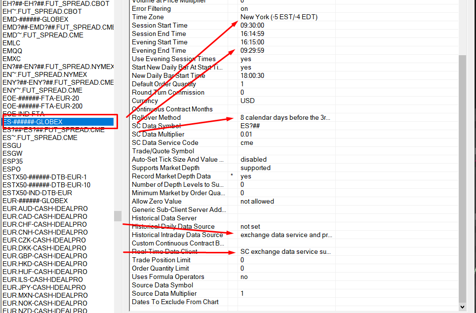

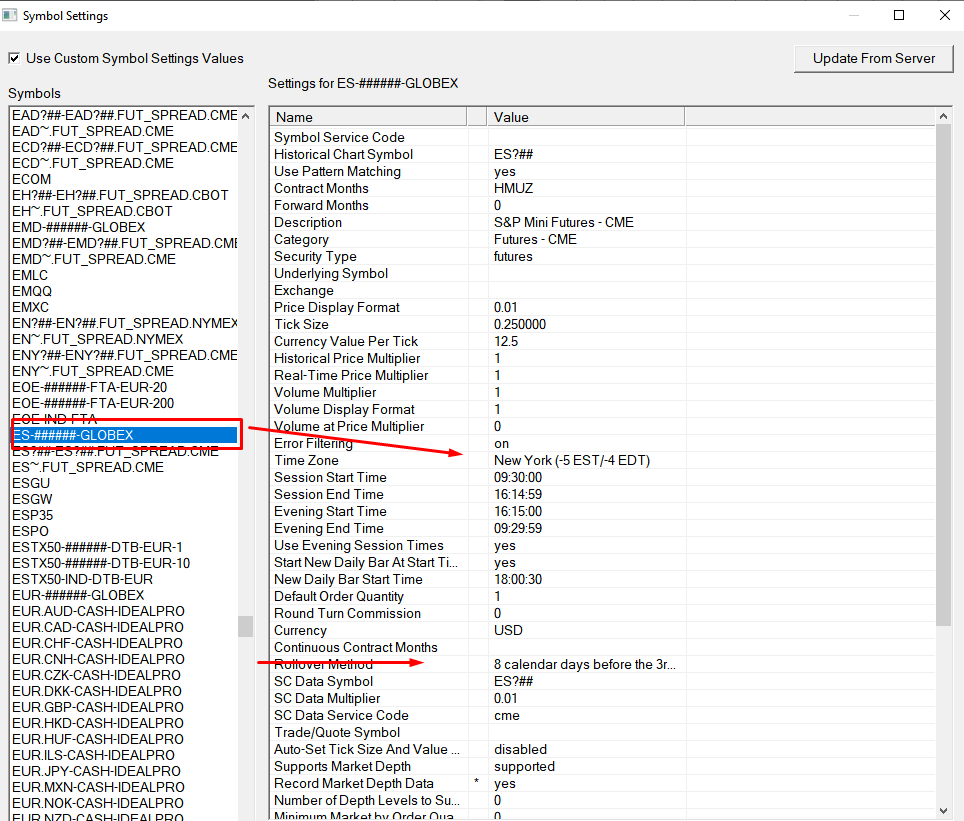

thank you, but i have not* locked fill space. If i use AAPL as symbol (or any other symbol) it works fine. only ES-202112-GLOBEX does not work.
does it have to do with my global symbol settings? attached are the two shots for symbol settings.
also attached is setting for chart's time zone as well.
i wonder if i dont understand timezone under symbol setting and chart settings?
i am in PST so i set chart's zone as PST and symbol setting as NYC???

[2021-12-06 23:09:41]
John - SC Support - Posts: 48014
This has nothing to do with Time Zones. The Time Zone setting in the Symbol Settings is establishing the Time Zone for the entry of the Start and End times of the Session Times in the Symbol Settings. That is all.
If you like to see your charts in PST, then what you have set is also fine. Although it is easier to set the Global Time Zone (in Global Settings >> Time Zone Settings) and use that global time zone for your charts.

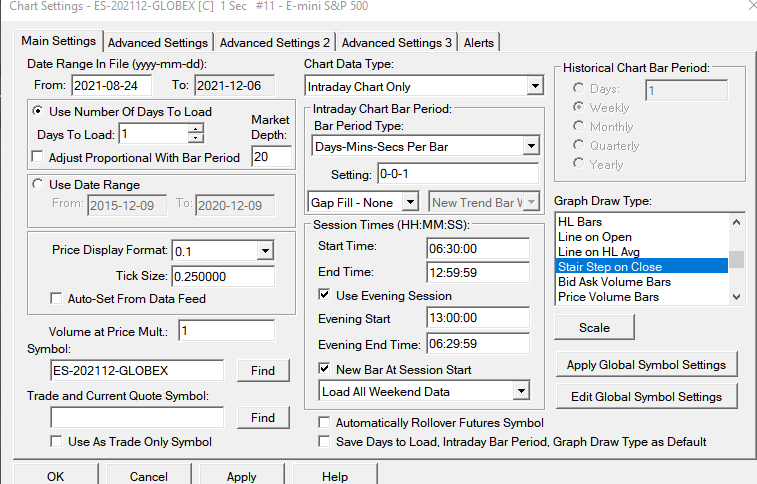

[2021-12-07 04:02:13]
Check the Session Times in the Chart Settings:
Intraday Chart or Chart Bars Not Updating | Blank Intraday Chart | "Currently no data to display" message for Intraday Chart: 3.3 - Session Start Time and End Time not Covering Current Time

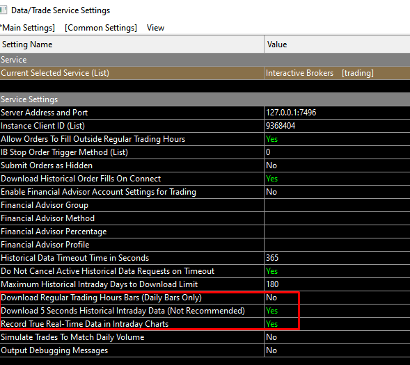

[2021-12-07 16:34:43]
ephi144 - Posts: 57
actually you were both wrong what fixed it was these settings under data services window. which by the way it so hard to read ...
imagefix_sc.png / V - Attached On 2021-12-07 16:34:07 UTC - Size: 26.56 KB - 270 views
