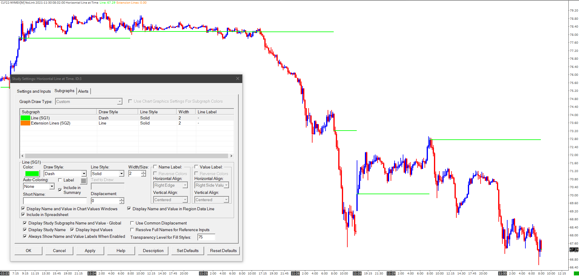

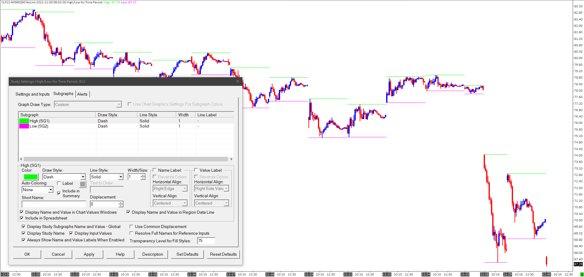

Are you sure? See attached images, no vertical line...
imagehigh-low-for-time-period.png / V - Attached On 2021-11-30 14:09:30 UTC - Size: 107.39 KB - 351 views
imagehorizontal-line-at-time.png / V - Attached On 2021-11-30 14:09:46 UTC - Size: 105.59 KB - 301 views

User907968 - Posts: 885
Not dashed 'line style' - Drawstyle Dash >>>> Chart Studies: Dash (ACSIL: DRAWSTYLE_DASH)
I am also using range bar charts with these studies.
Date Time Of Last Edit: 2021-11-30 15:02:55
[2021-11-30 15:16:08]
User12089 - Posts: 386
indeed it has worked. Thank you for the additional efforts/clarifications/time to point out that there was also Drawstyle "Dash" besides linestyle "Dash"
