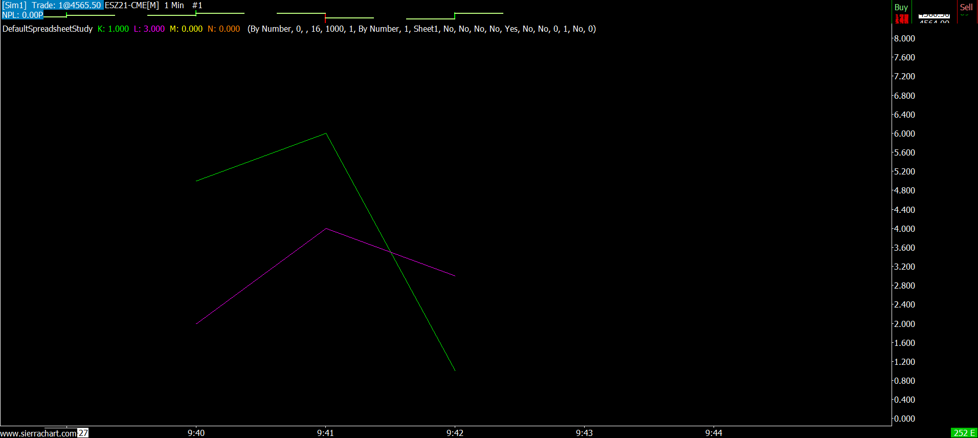

In I12-I14 cells I have 1, 6, 5 values. In J12-J14 cells I have 3, 4, 2 values. =CROSSFROMABOVE(I12:I14, J12:J14) returns 1 =CROSSFROMBELOW(I12:I14, J12:J14) returns 0 =CROSSOVER(I12:I14, J12:J14) returns -1 So CROSSFROMABOVE and CROSSFROMBELOW say 'The first range crosses the second Range from above.', CROSSOVER says 'The first Range crosses the second Range from below.'. Why different results? My logic says, that only CROSSOVER gives a correct return value. Date Time Of Last Edit: 2021-10-27 14:06:30
| [2021-10-27 14:44:51] |
| John - SC Support - Posts: 47802 |
Our logic says that the CROSSOVER is returning the wrong value and the other two are correct. But it depends on the order in which you have the data in the cells. If you have I12=1, I13=6, and I14=5 (and then the same for J12-J14), then you need to keep in mind that the system is reading the data from row 15 to row 12, not the other way around. Here is an example of the plotted data when it is entered as we specified: http://www.sierrachart.com/image.php?Image=1635345766563.png In this case, the green line is the first set of data and the purple line is the second. In this case the crossover goes from above to below with the first one crossing the second. We will look into why the CROSSOVER does not appear to give the right result. For the most reliable, advanced, and zero cost futures order routing, use the Teton service: Sierra Chart Teton Futures Order Routing |
Yes, that is what I meant. the system is reading the data from row 15 to row 12
I didn't know that, is it written somewhere in documentation? It is unusual to interpret and predict a result for all functions then, as people are reading from left to right for e.g. I mean, this fact makes description for CROSSFROMABOVE https://www.sierrachart.com/index.php?page=doc/SpreadsheetFunctions.html#CROSSFROMABOVE_Function inaccurate. |

Again, the system is reading the data from row 15 to row 12
Is it written somewhere in documentation? By reading description for CROSSFROMABOVE I would expect it to return 0 instead of 1, as I'm reading both ranges from left to right. |
| [2021-10-27 15:24:57] |
This is how all of these calculations are going to work within Sierra Chart. It is always going to look from older data to newer. Which is the expectation that you should have. It's just that with the Spreadsheet the lower numbered data is the most recent, so you have to adjust to where the data is located within the specified range.

Yes, from above. These sets of data cross from above too: I12,I13,I14=1,3,6 J12,J13,J14=2,4,5 Why =CROSSFROMABOVE(I12:I14, J12:J14) returns 0 then? Does it work incorrectly? |
| [2021-10-28 23:21:34] |
The data you show above gives a 0 for CrossFromAbove since the crossover occurs between the points at rows 13 and 14. Therefore the most recent set of points is not crossing (rows 12 and 13). The only time the 3rd value is looked at is when the 2nd values in each range are equal to each other. Then, and only then, is the comparison performed to check the 1st value with the 3rd value.

Now you are contradictiong your own words you said in post #2: you need to keep in mind that the system is reading the data from row 15 to row 12, not the other way around
If so, then the plotted data for I12,I13,I14=1,3,6 and J12,J13,J14=2,4,5 will look like this: http://www.sierrachart.com/image.php?Image=1635538667524.png The green line is the first set of data and the purple line is the second. You can see clearly there is a crossover with the first set of data crossing the second one from above. But now you are saying it goes from row 12 to row 14, which turns analysis upside dowm. In this case the 1st set of data definitely does not cross the 2nd one from above: http://www.sierrachart.com/image.php?Image=1635539546814.png If, by chance, the second values were the same...
If e.g. I12,I13,I14=1,4,6 and J12,J13,J14=2,4,5 CROSSFROMABOVE returns 1 correctly for these sets fo data: http://www.sierrachart.com/image.php?Image=1635540024559.png Date Time Of Last Edit: 2021-10-30 16:50:21
