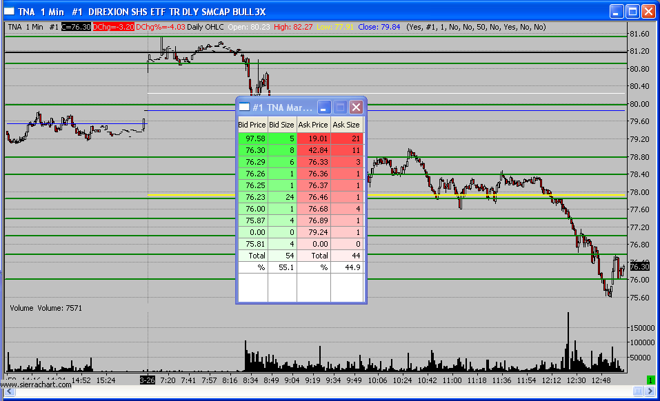

The market depth window for one of my symbols appears to be stuck with the incorrect inside bid and ask. The numbers for price and size are not updating. All of the numbers below the inside bid/ask are updating normally. How do I clear these incorrect numbers in the top row? I'm using TD Ameritrade as a data source with Sierra Chart version 1109. I uploaded an image of the market depth window to photobucket at the following link:

We cannot see the image (probably because of security software we use). The best way to provide an image is to put the market depth window over the chart and select Edit >> Screen Images >> Upload Chart with Overlays. And paste a link to the image here.
Anyway, being this is TD Ameritrade data, there really is not much we can do to help with this other than to recommend selecting File >> Disconnect and File >> Connect to Data Feed, when you see this kind of problem.

Reconnecting to the data feed does not help. Here's the image link per your instructions:
http://www.sierrachart.com/image.php?l=1395857070785.png

We observe this as well for this particular symbol when using TD Ameritrade.
Those prices you see at the top of the book, are coming from the data feed. Not sure if they are valid or not. Would seem unlikely. We recommend just ignoring those values. We could try to filter them, but we really do not like doing things like that because they should not be there if they are not valid and if they are valid, then they should be there.
