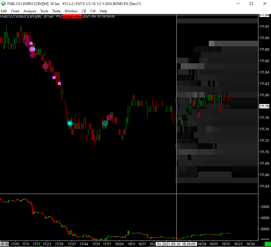

[2021-09-10 17:24:40]
User740709 - Posts: 159
Thank you.
Yes, that is set to Yes, that has not changed.
However, as you see from the screenshot, Market Depth does not show any data before the time I switched shown by the Chart Values Tool (crosshair).
One thing that comes to my mind is the Contract Symbol, which caused the issue I had in the morning. The Symbol looks different. It is FGBL1221-EUREX for Rithmic Trading connection but FGBL1221.EUREX for Rithmic Direct DTC.
Can that be the reason for denali datafeed to not recognize it and load the history?
Thanks.
H.
Date Time Of Last Edit: 2021-09-10 17:25:38
imageMarketDepth.png / V - Attached On 2021-09-10 17:24:27 UTC - Size: 36.24 KB - 264 views
[2021-09-10 18:33:54]
It does not have anything to do with the symbol.
The first thing that needs to be understood is whether there really is not any Market Depth Historical Data showing in that area, or if it is just at such a low level that the coloring is the same (or similar) to the background. Please display the quantity numbers with the Market Depth Historical Graph and see if there is data in that area or not.

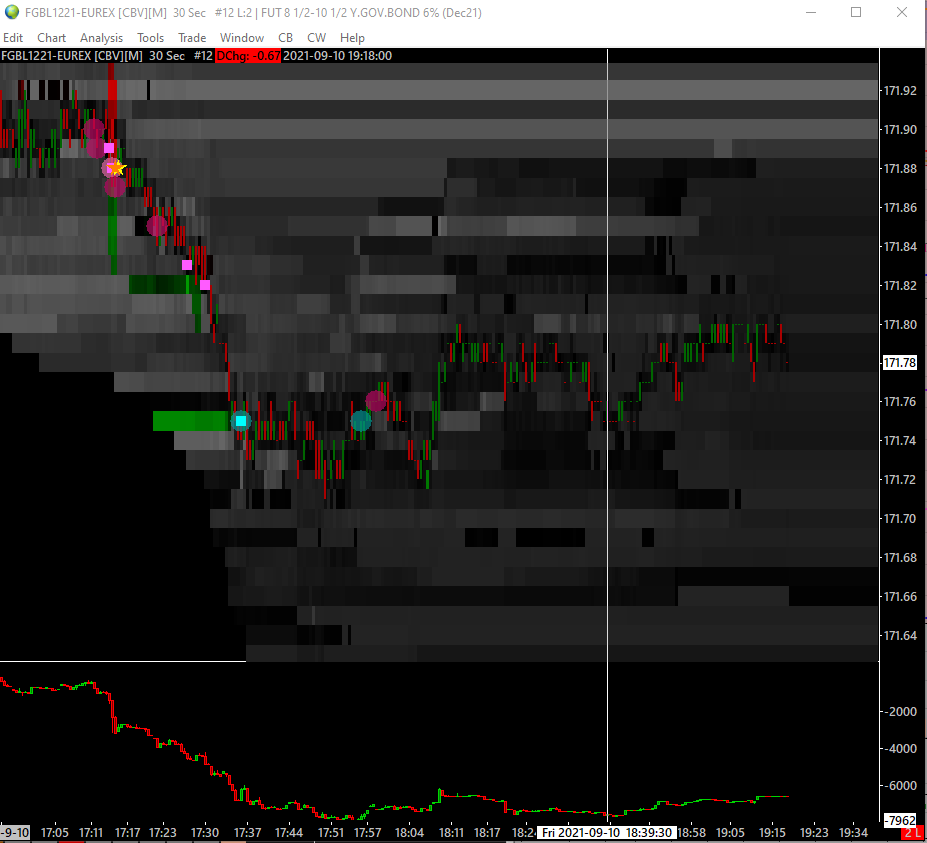

[2021-09-10 19:20:44]
OK.
Here is the prior setup with Rithmic Trading (what I had the whole day on before 18:39).
THere is no need to display the numbers.
Please advice.
Regards,
H.
imageMarketDepthPrior.png / V - Attached On 2021-09-10 19:20:40 UTC - Size: 57.5 KB - 332 views
