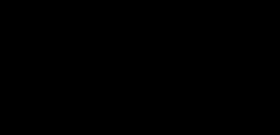

I seem to be a bit lost. im going to include a picture in this, is this picture what youre referring to ? is this the "main Sierra chart installation folder"?
imageScreen Shot 2021-08-02 at 8.44.55 AM.png / V - Attached On 2021-08-02 13:46:00 UTC - Size: 669.41 KB - 445 views

Can you not open a finder window on Mac that shows where Sierra Chart is located and shows all the folders within Sierra Chart? When SC folder view is expanded you will see multiple subfolders and that chart book file needs to go in the data folder.since you have SC installed using Crossover you may need to go to the Crossover website and see how to put files in an application installed using Crossover.
[2021-08-02 15:59:55]
We do not know how to access the files on a Mac, and particularly not when using Crossover. As 58LesPaul notes above, you need to be able to put the Chartbook into the 'data' folder that is under the main Sierra Chart folder. You would need to figure out how to do that.

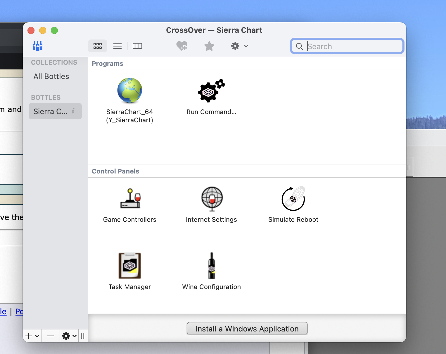

Open up the Crossover App on your Mac. Under Bottles, highlight the Sierra Chart bottle, right click on Sierra Chart. Then click on Open Y: Drive (If Sierra Chart installed on the Y: Drive, otherwise may be C: Drive). A Finder Window opens for drive_y or drive_c. Double click on the Sierra Chart directory in the Finder window. Double click on the Data directory. Now go to the Finder menu bar at the top of the Mac screen. Click File then New Finder Window. Click on the Downloads directory on the left hand side of the screen. Now copy or drag your Non-Mac User Chartbook file to the Data directory of the other open Finder Window. Your Chartbook should now appear in Sierra Chart.
