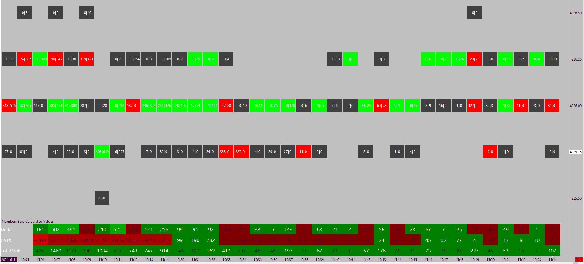

I have a foot print chart set to 1 minute interval as shown in the attached picture. On this chart I would like to see volume broken by different lot sizes like lot size less than 3, lot size greater than 5 etc. This needs to be below the "Total Vol" row shown in the attached picture.
Can you suggest of a way to do this ?

To do what you are asking for would require using another chart that is setup with filtering for the lot sizes you are wanting, and then you can use the Numbers Bars Calculated Values based on that other chart.
Refer to the following for filtering:
Chart Settings: Volume Filter (Chart >> Chart Settings >> Data Limiting >> Volume Filter Settings menu)
And refer to the following for setting up a Numbers Bars Calculated Values based on a different chart:
Numbers Bars: Overlaying a Numbers Bars Calculated Values Study from Another Chart
Another option available, although we are not sure it is exactly what you are looking for, is the Large Volume Trade Indicator. Refer to the information here:
