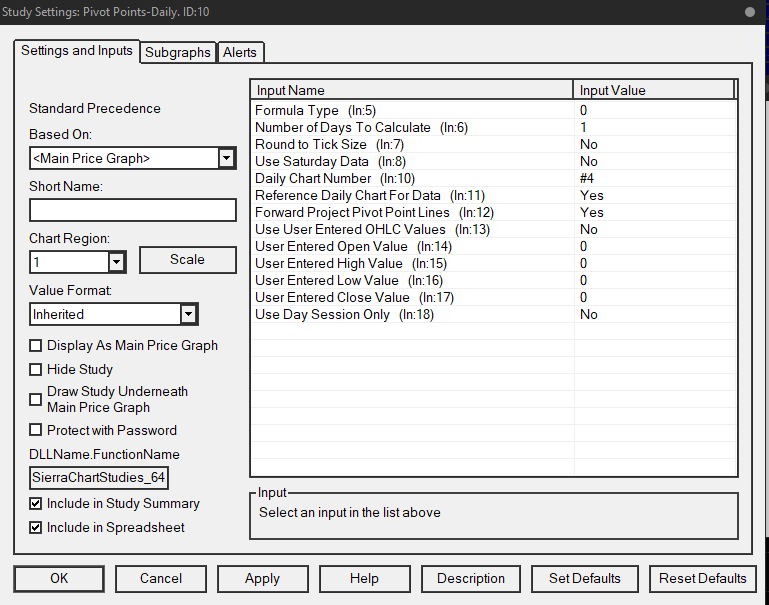

To reduce variables - I updated to 2261 before making any changes and my CPU is still high. I did notice on my daily chart pivots appear to be redrawing with every tick. There is a small movement/shift in the lines. I'll update this post but going to start going through everything to try and locate the issue. Date Time Of Last Edit: 2021-05-21 16:34:30
