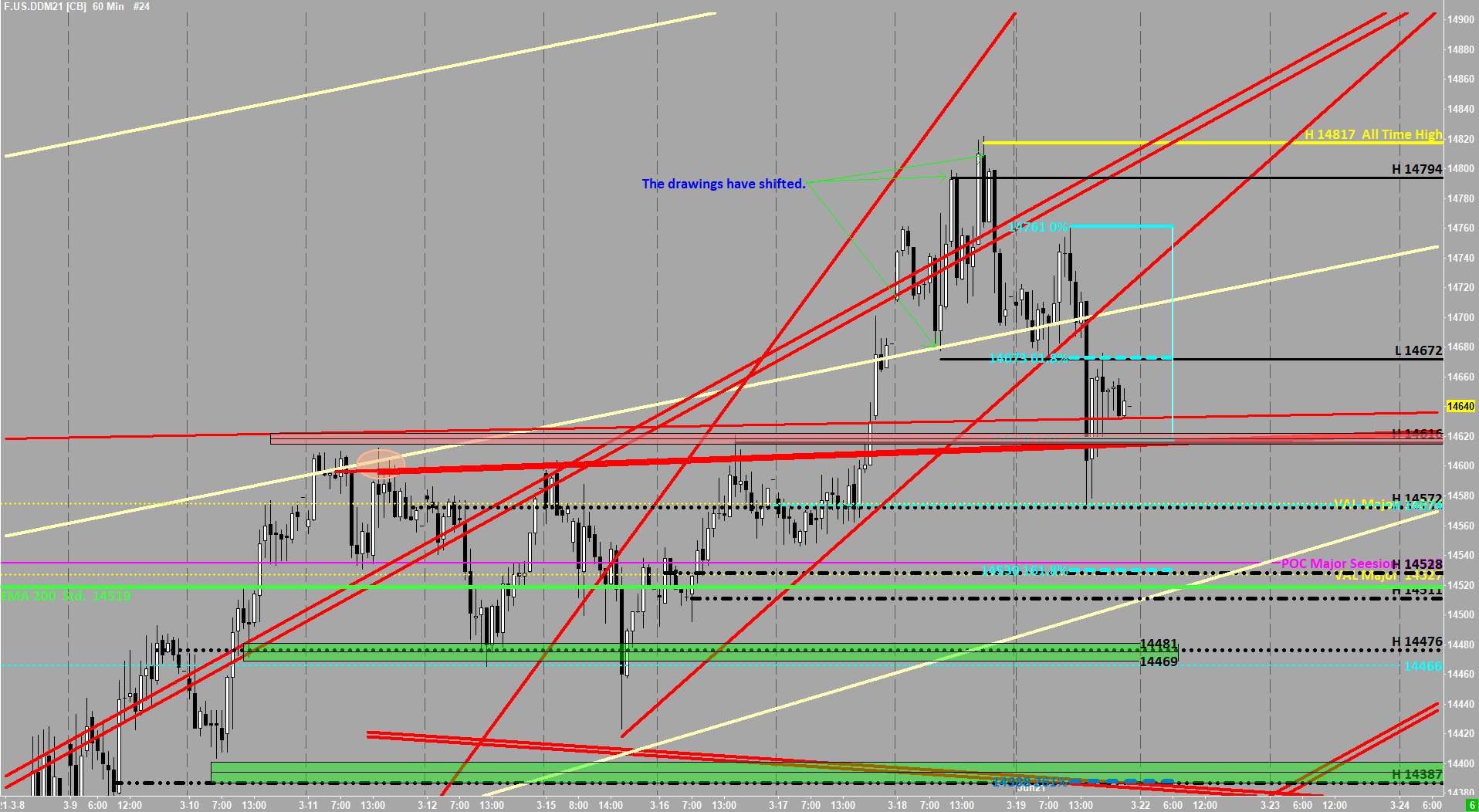

After rollover into a new contract, the subscriptions were taken over as well. Due to the interest rate difference there is a deviation in the drawings.

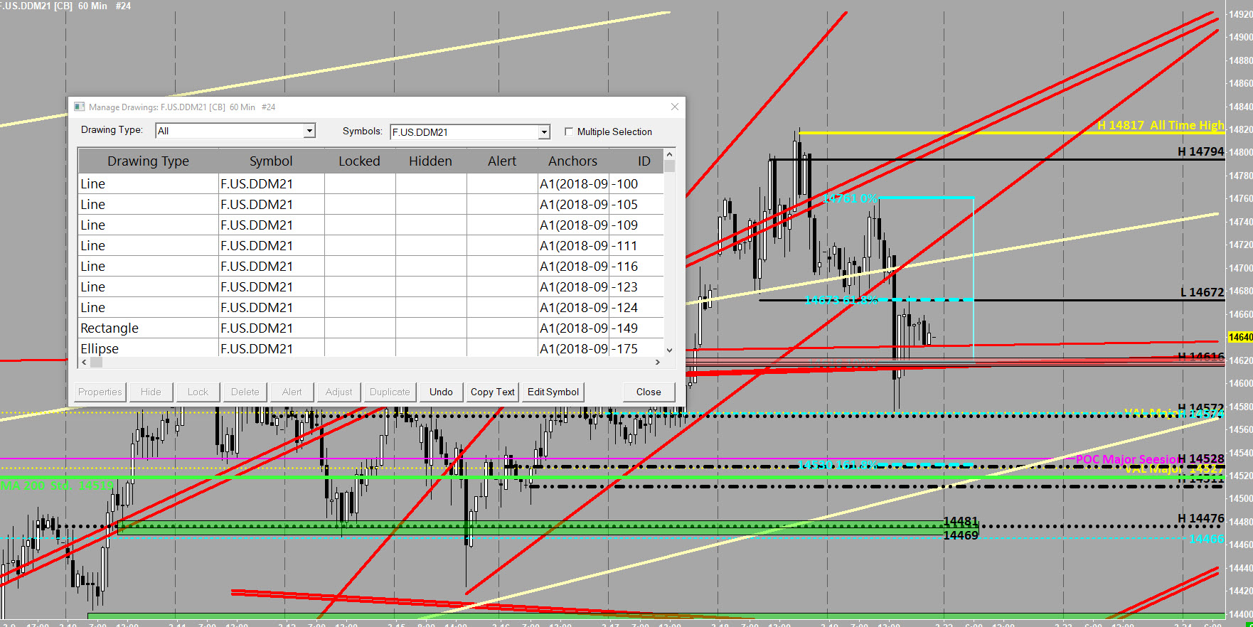

With the tool Manage Drawings you can make an adjustment.
I have tried all but the drawing have not changed.
What is the exact step to adjust the drawings to the new contract?

First use this Chart menu command to make sure the Chart Drawings are using the correct symbol:
Chart Menu: Update Chart Drawings to Current Symbol (Chart menu)
Here is the updated documentation to adjust the Chart Drawings:
Changing to a New Futures Contract Month: Adjusting Chart Drawings to Match Futures Contract Rollover Difference

specificically for VX rollover (from VXJ21-CFE to VXK21-CFE), i got the following:
VXK21-CFE [CB] 30 Min #60 | VXJ21-CFE price difference to VXK21-CFE is 3.2. | 2021-04-25 22:28:57.723
VXK21-CFE [CB] 30 Min #60 | Back adjust amount for symbol VXJ21-CFE is 3.2. | 2021-04-25 22:28:57.723
however, the drawings are still off using the value 3.2 adjust amount
any ideas what could have gone wrong?
