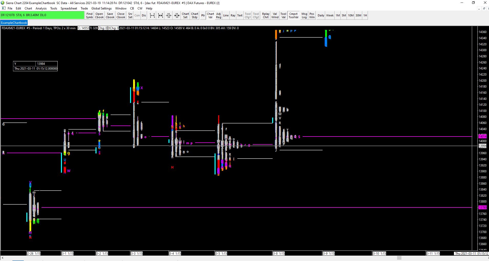

Bonjour, je suis passé sur les contracts de juin sur le dax30 futures (FDAXM21-EUREX) et je remarque que j'ai des trous de cotation dans mes tpo, donc je ne peux pas repérer mes zones de single print. Comment puis je remédier à cela ?

I went to the June contract on the DAX30 futures (FDAXM21-EUREX) and I notice that I have quotation holes in my TPO, so I cannot locate my single print areas. How can I remedy this?
The first thing to check is your Session Times. Make sure that you have the entire trading time for the exchange in your Session Times. Also, ensure that your Session Times are not overlapping. For example, if your Start Time is 09:00, and your End Time is 09:00, this is a problem - the End Time should be 08:59:59. Refer to the following:
Chart Session Times
If it is not the Session Times, then you would need to redownload the data to fill in any missing data. Refer to the following:
