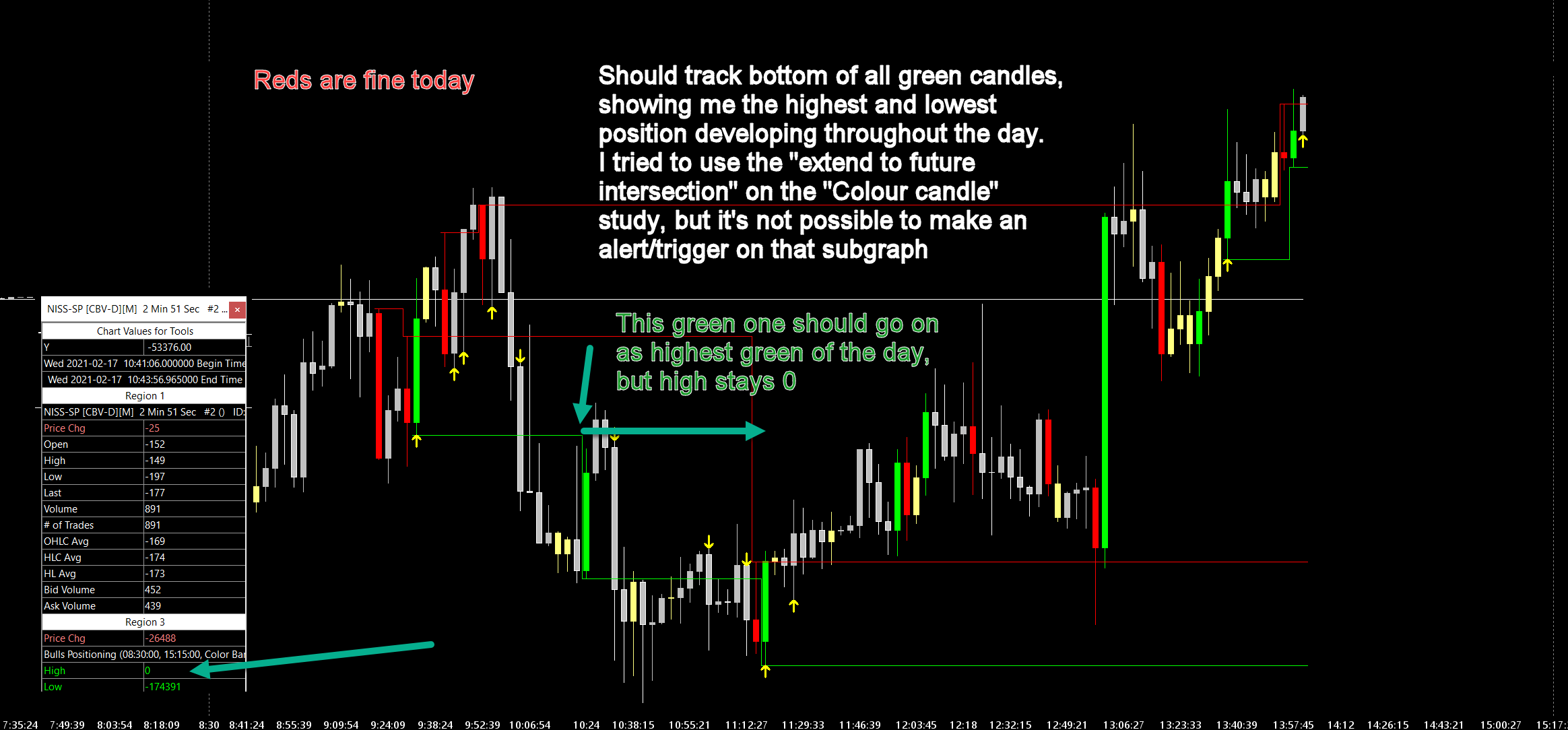

I want the high/low to track these highlighted candles, but it doesn't work well when using the "show developing high/low".
So hard to explain. I just assumed it was because of zeros (the chart is NVOL so it can be above/below zero).
See screenshot: http://www.sierrachart.com/image.php?Image=1613591136631.png
3rd pane down with the green/red NVOL candles. They're highlighted based on PVOL > above average and NVOL being either positive or negative.
It's to give an idea of bullish/bearish positioning in the market.
Then I use high/low to show when a previous position gets liquidated.

The idea is that the H/L tracks the bottom of the green candles and top of the red candles, but developing.
Appreciate it

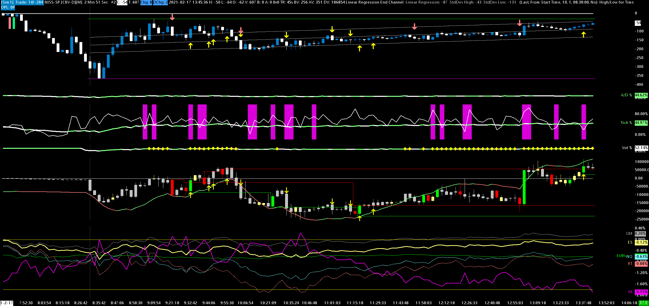

Matt NL - Posts: 91
Simple chart attached + photo with details.
attachmentjohn.Cht - Attached On 2021-02-17 20:09:09 UTC - Size: 5.96 KB - 438 views
image2021-02-17_21-01-54.png / V - Attached On 2021-02-17 20:09:13 UTC - Size: 140.57 KB - 394 views

The problem is that the Color Bar Based on Alert Condition is outputting a value of 0 when False. This is causing a problem for your particular setup since you are dealing with negative values. Therefore, 0 is the Highest value at those points where the data is negative.
There really is no good solution for your particular setup. You can't change the Output When False to some large negative value, as that would then cause issues for your Low values.
The only thing we can think is to shift the chart up so the values are all positive. If the actual price values are not important to what you are looking at, then this would be the best/easiest solution. Refer to the following for how to adjust your data:
Using the Basic Arithmetic Studies
Otherwise, you would have to modify the code to handle the situation you are dealing with. Refer to the following:
How to Build an Advanced Custom Study from Source Code
