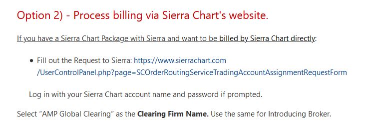

It s my BELIFE I'm waiting to find out for sure. This is what I did this morning US EST. According to this post https://support.ampglobal.com/hc/en-us/articles/360042515233-Sierra-Chart-Denali-Data-Feed-Trading-Technologies-TT-Trade-Routing-Pricing-Setup-Guide and following this link https://www.sierrachart.com/UserControlPanel.php?page=SCOrderRoutingServiceTradingAccountAssignmentRequestForm from it. Now it is a matter of someone from SC adjusting the account manually.
Hope this helps
imageCapture.JPG / V - Attached On 2021-01-03 20:11:02 UTC - Size: 42.69 KB - 492 views
