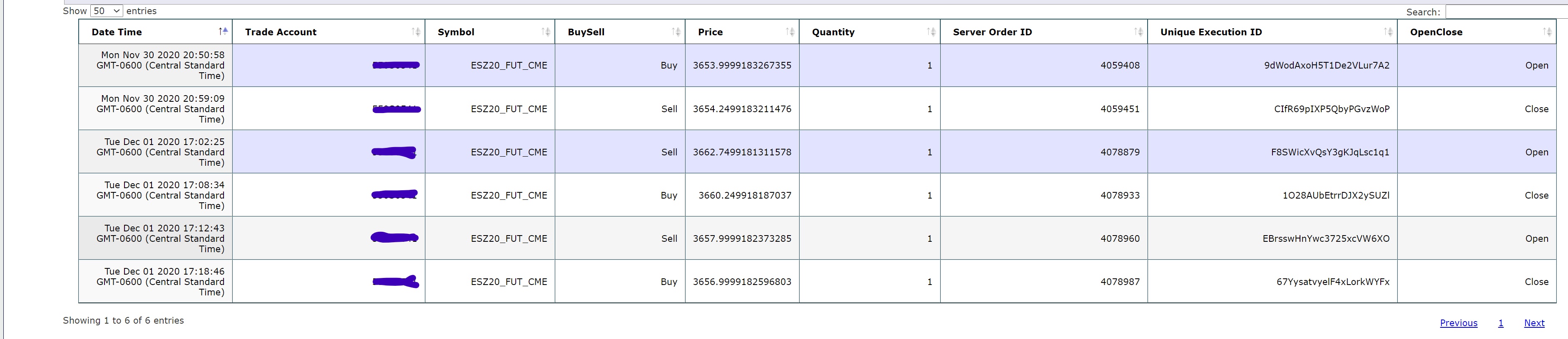

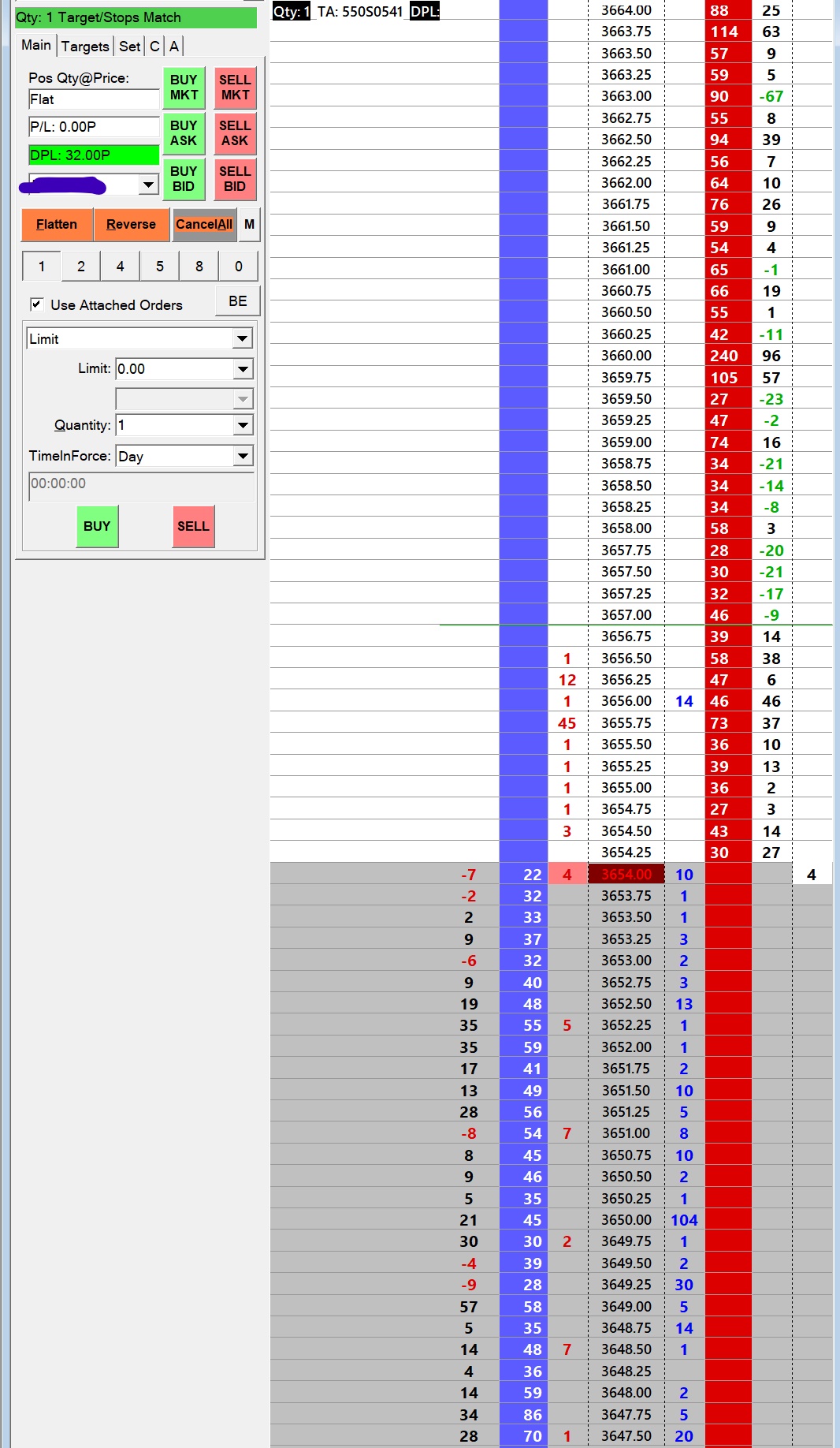

Hello, my DOM DPL (p&L) is not correct . I only made a few scalps and it says 32P. Any idea what may be wrong? See attached screenshots
imageScreenshot (78)_LI.jpg / V - Attached On 2020-12-01 03:14:50 UTC - Size: 1.46 MB - 573 views
imageScreenshot (79)_LI.jpg / V - Attached On 2020-12-01 03:14:58 UTC - Size: 1.39 MB - 471 views

Refer to this page:
Help With Daily Profit/Loss Value
And make sure this Chart Settings option is enabled:
Chart Settings: Filter Initial Fills Which Are Part of Existing Position (Chart >> Chart Settings >> Trading menu)

You checked what? What did you do, and why is it off? The documentation explains to use the Trades tab of the trade activity log to view the fills and trades from the same starting Date-Time you have used in the chart. And the Trade Statistics tab shows the daily statistics including the daily profit/loss.

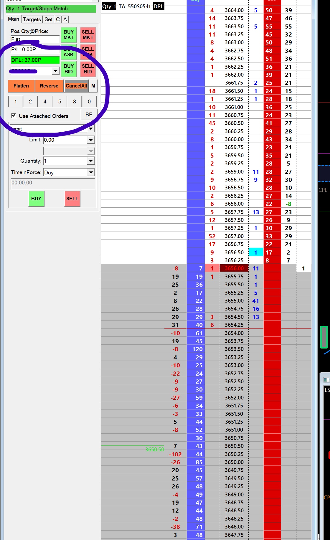

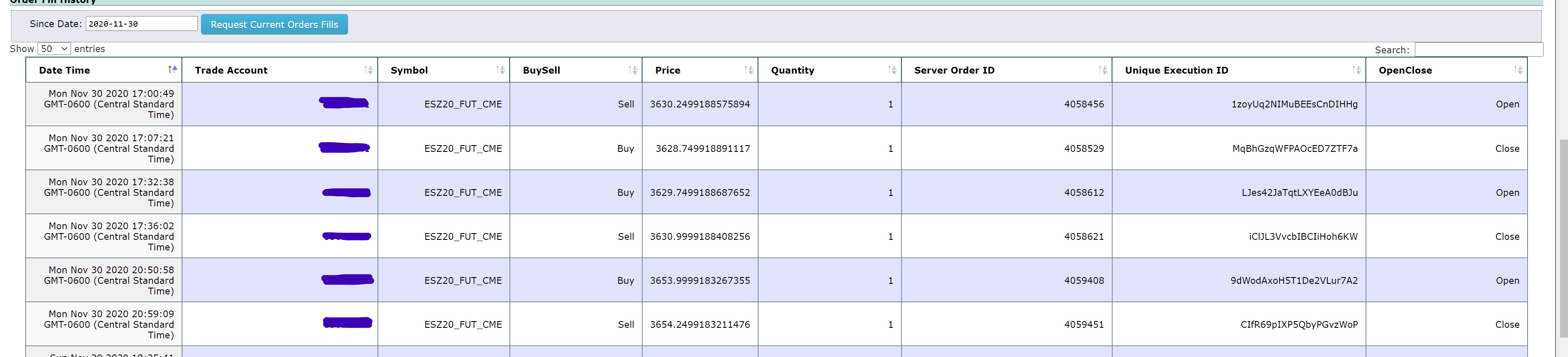

Still doing it today. I checked everything you recommended . like I said , it was fine before. What is the next step? You can see I clearly shouldnt have 37P on my dom based on the screenshots I posted
Date Time Of Last Edit: 2020-12-01 23:40:45
imageScreenshot (81)_LI.jpg / V - Attached On 2020-12-01 23:38:59 UTC - Size: 1.5 MB - 488 views
imageScreenshot (82)_LI.jpg / V - Attached On 2020-12-01 23:39:09 UTC - Size: 1.32 MB - 604 views

Nevermind. I had to delete my DOM and move a working one from a different chartbook. Was fine before the 2204 version update.
