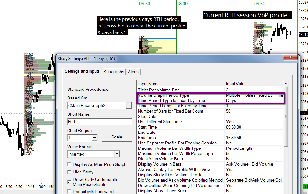

Is it possible to set VbP or DVP tool to auto draw profiles automatically for the selected time period, X days back? That is, say on a 15 or 30 or 60 minute chart a profile is automatically drawn with start time and end time for RTH session, for say the last 5 days, for each day.
If possible, how do I set that up?
Attached is a chart image to better help describe the question.
Thanks.

Hi, please disregard the above question. I got it solved. I had the wrong combination of settings in the 2nd and 3rd setting and inputs field.
imagevbp_repeat_solved.png / V - Attached On 2014-02-13 22:51:34 UTC - Size: 135.71 KB - 598 views
