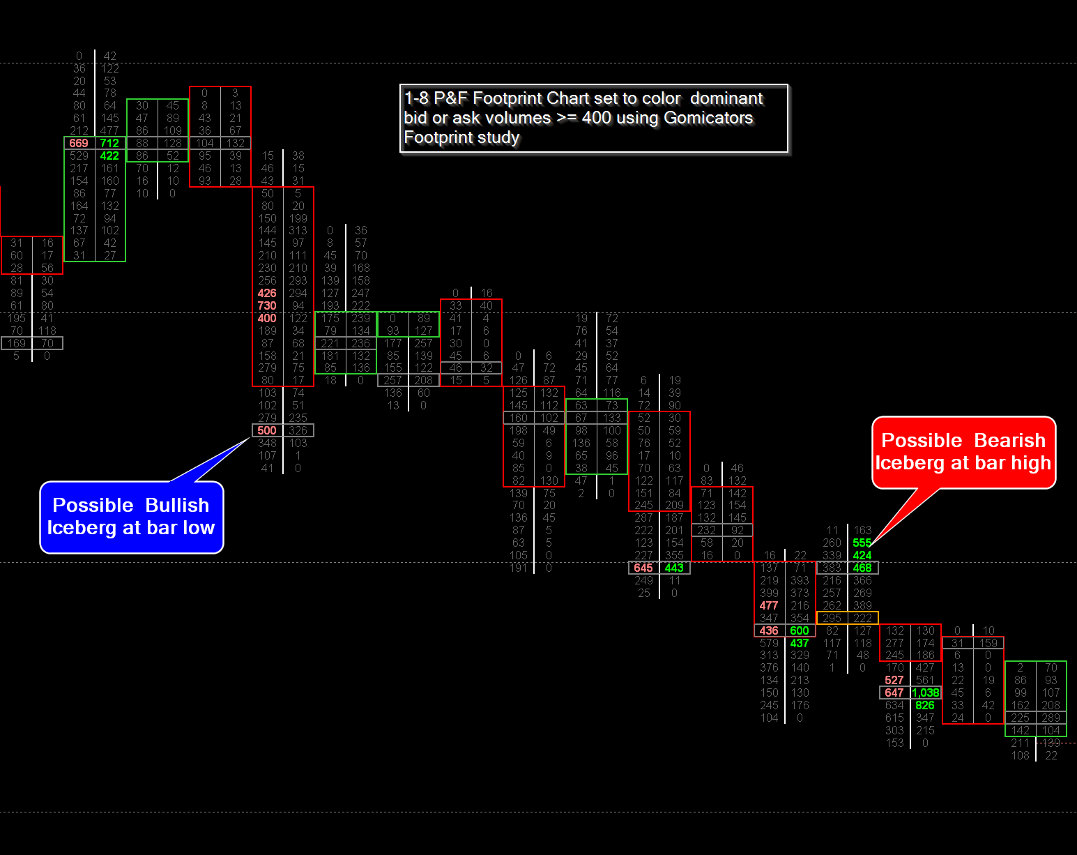

Not sure if this request has been reviewed to be added to future version of Numbers Bars. Since the previous post I have found that this can be achieved using the Gomicators Footprint study. However, I would still like to be able to do the same using the native Sierra Chart Numbers Bars study.
This is very helpful when reviewing orderflow to detect large iceberg orders at the highs and lows of a bar.
Please see the attached example for reference. Your response would be greatly appreciated.

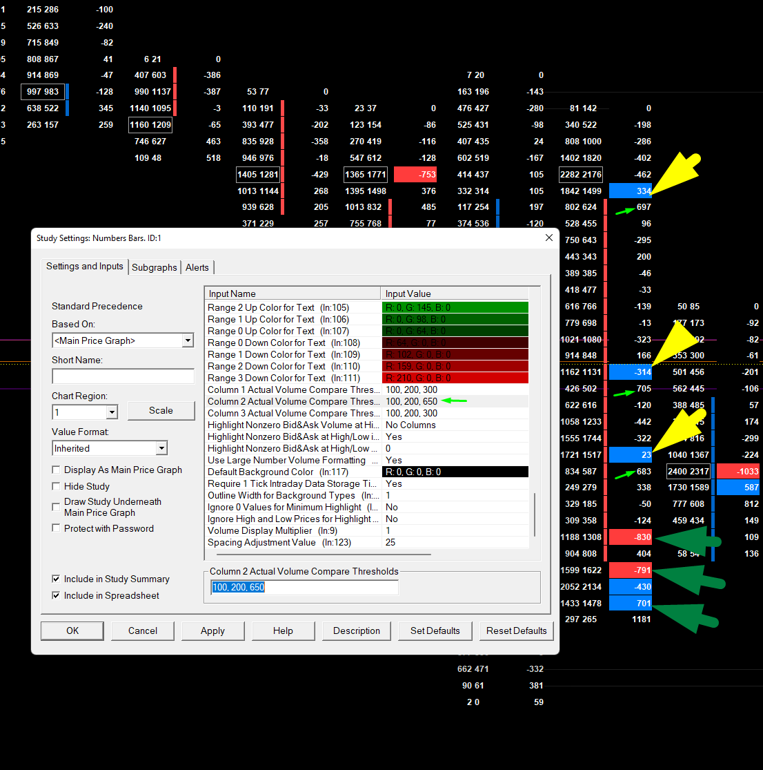

MarketBeast - Posts: 48
The background coloring method "Based on Diagonal Dominant AskVol BidVol Difference - Actual" is not working properly when used along with Number bars text "Ask Vol Bid Vol Diff Diagonal 1 Side" as you can see in the attached screenshot I want to highlight the actual volume over 650 which is calculating fine as shown by the small blue arrow but if you look at the yellow arrows it show that it's highlighting the wrong price level it should instead highlight the level below which is the correct calculation. I would really appreciate if some genius can fix this bug please?
Thank You
Ali

[2024-07-01 14:45:50]
This is not a bug. You are not understanding what the option for "Ask Vol Bid Vol Difference 1 Side" does. In particular, it is only showing the Bid side of the diagonal comparison - it is not showing the dominant side. Refer to the following:
Numbers Bars: Numbers Bars Text Types
