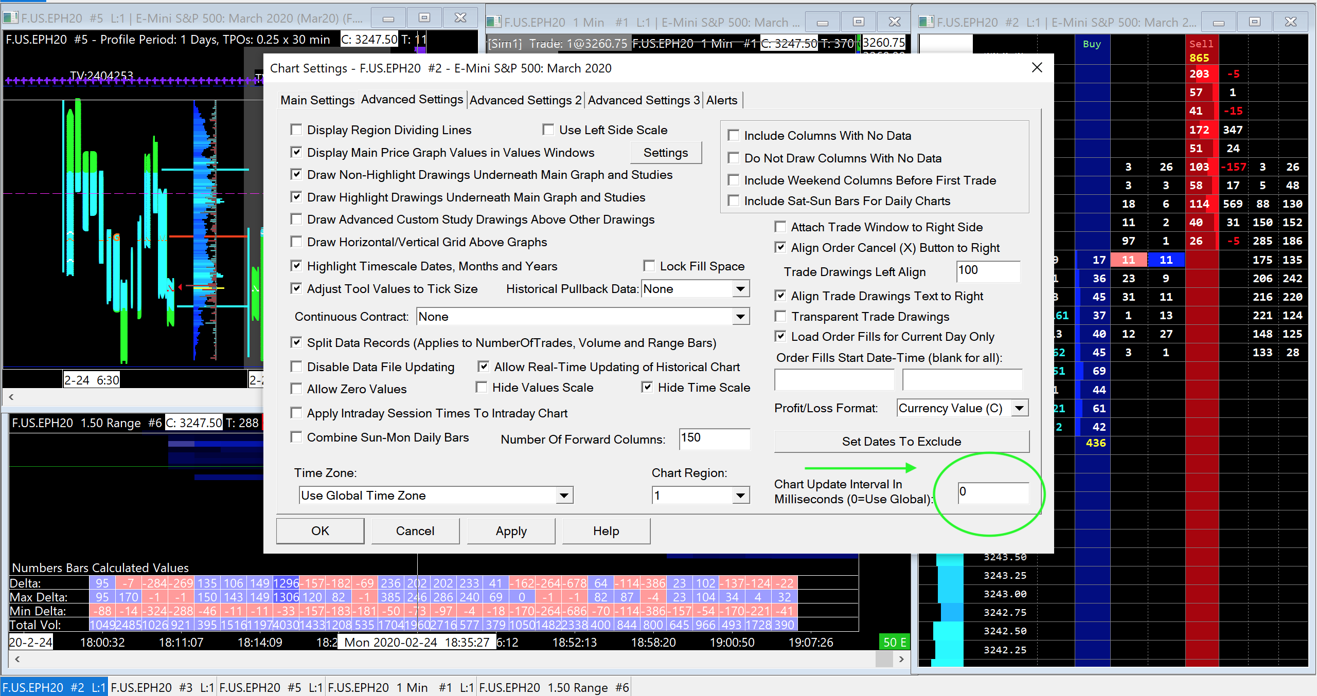

Hello, every time I try and change my chart update interval in seconds for my DOM, it changes it back to 0. It is at 0 right now and if I click on it and change it to 1, it will flash and become 0 again. Please let me know if you can help, thanks.
imageScreen Shot 2020-02-24 at 7.04.53 PM.png / V - Attached On 2020-02-25 03:07:14 UTC - Size: 436.86 KB - 1144 views
[2020-02-25 08:21:20]
User907968 - Posts: 884
Chart update interval is measured in milliseconds.
The lowest setting possible is 10ms.
For 1 second update interval, set to 1000ms.
General Settings Window: Chart Update Interval in Milliseconds (Global Settings >> General Settings >> General >> Update Intervals)
[2020-02-25 09:02:45]
Yes you need to set the Chart Update Interval to 1000 in your case.
