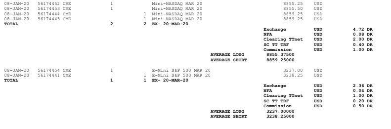

binaryduke - Posts: 387
Attached is the fee breakdown from my AMP account that uses TT routing for 2 round trips on CL. You will see a line item for CLEARING TTNET. I have queried this previously with AMP and been advised that this is a separate item to order routing. I have in the past been erroneously charged for TT routing (circa $0.60 per contract) in addition to this clearing line item.
Of course, if the CLEARING TTNET line item should not be there it would be good to know so that this can be reclaimed from AMP...
Hope this helps.

[2020-01-15 09:17:48]
This was not our understanding there would be an additional fee. Why would we be recommending the solution, when there is a $0.50 per side contract fee. It makes no sense.
We do not understand the basis of this. And we are not happy about this at all.
We are specifically telling users there are no fees from TT to the clearing firm but this makes it look like there is some TT fee. There just is not.
Our fee from TT is .05 per contract per side. We then add .05 ourselves. This is all the cost there is. This is what made this an attractive solution.

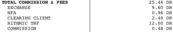

If this is of any help, attached here is a view of Rithmic charges from AMP (24 micro contract round trips). You will see there is still a line item for clearing that is separate from order routing (RITHMIC TRF), exchange fees, NFA fees and broker commissions.

In regards to post #6, we calculate you traded 46 contracts and at .25 USD per contract billed by Rithmic, the Rithmic transaction fee makes sense.
In the case of TT there is no cost to AMP for TT routing. Nothing additional. Certainly they have to pay TT for what is called Map fees. But that is fixed at something like 5000 a month for the CME group. And they have that cost no matter how many users are on TT.
This Clearing TT Fee is double Rithmic and then you have the .10 on top of it. This is not making any sense.

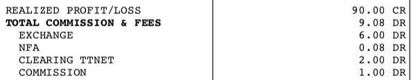

nosast - Posts: 324
My statement shows correct fees, at least for trading ES.
In the attachement I traded 3 round turns.
Date Time Of Last Edit: 2020-01-15 20:56:31
imageTRD_ 2020-01-15 - 21.53.35.png / V - Attached On 2020-01-15 20:56:08 UTC - Size: 13.03 KB - 865 views
[2020-01-15 20:59:52]
Same thing as posted by binaryduke. So is it your understanding you should be paying a .75 commission to AMP per contract per side? Now this is excluding NFA and exchange fees. We have thought it should be more like .50.
And also excluding the .10 order routing fee that we include.
Date Time Of Last Edit: 2020-01-15 21:00:12

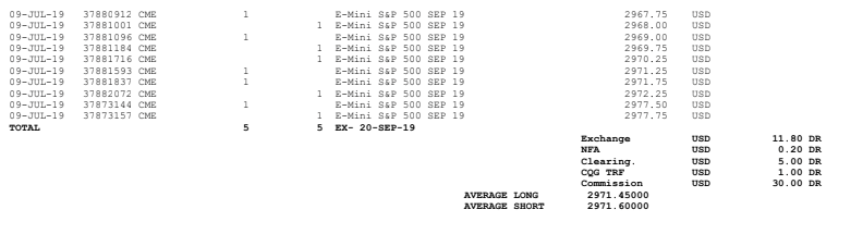

User187858 - Posts: 12
attached are two screen shots of some daily statements. one from CQG one from my recent billing with Clearing TTnet & SC TT TRF

seandunaway - Posts: 398
It's very common for a broker to charge an additional "clearing fee" or "brokerage fee" in addition to their commission fee. This is additional profit for the broker and a result of brokers in a race to advertise the lowest commission. The reality is they just split their true commission into two fees. This additional fee can almost always be negotiated out, depending on your trading and risk activity. Yes, their FCM will charge them literally a couple pennies for clearing, but that can be covered out of their commission.
CQG does not inherently have this additional clearing or brokerage fee. Any exchange non-member, with a new account, with the minimum deposit requirement, should near effortlessly be able to achieve an /ES trade for:
$1.18 exchange (increases by $0.05 in 2/2020, by the way)
$0.02 NFA
$0.49 - $0.50 commission (volume discounts typically available, negotiable)
$0.10 CQG routing fee (only $0.05 CQG routing fee if using FIX)
for $1.79 per side or $3.58 per round turn expense all in.
Alas, perhaps TT is more expensive to the FCM and that is being passed on to the broker and ultimately, the customer.
