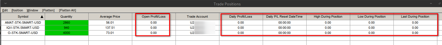

[2020-01-13 18:18:52]
Cavalry3162 - Posts: 523
that is some excellent news guys! really appreciate the effort and looking forward to 2035!
can you - while doing all this IB related order stuff take a look into the "Open Profit/Loss" too? as this is always reported as "0", even though it is not..
thanks,
Andreas

[2020-01-14 10:53:43]
SC,
the position stuff works now, awesome! even the profit / loss and high / low show up after i opened the symbol on a chart (is this just a "migration thing"?)

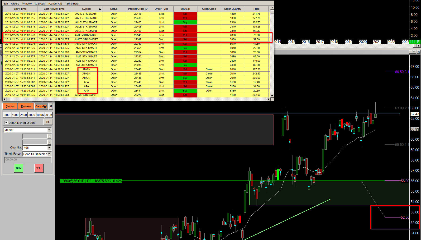

[2020-01-14 20:23:38]
well, what can i say.. the orders are at ib and visible in the order window but not in the chart (see screenshot), chart trade mode is on as well.
also pls note some of the stocks' orders do not have the typical -STK-SMART suffix in the trade order window.. there's several more
pls advise,
Andreas
imageib_sc_order_issues.png / V - Attached On 2020-01-14 20:21:37 UTC - Size: 164.61 KB - 743 views
[2020-01-14 20:25:05]
ah, and what i dont see is that little arrow indicating a trade entry...
Existing fills in the Trade Activity Log which do not use the simple stock format are not going to get mapped to the chart. You will need to edit those symbols.
