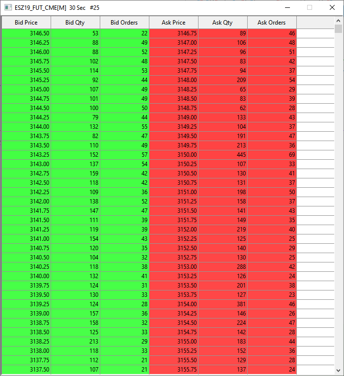

Go to the chart and select File >> Open Market Depth Window. Is there any issue with the displayed depth there?
[2019-12-12 02:37:13]
Acro - Posts: 459
I've attached a screenshot of the Market Depth Window.
This looks normal to me
image2019-12-12_10-35-07.png / V - Attached On 2019-12-12 02:36:37 UTC - Size: 57.02 KB - 489 views
[2019-12-12 02:54:29]
Yes it is normal. Our best determination at this point is that there is a data error in one of the depth files from another prior day causing an extended effect with subsequent calculations.
