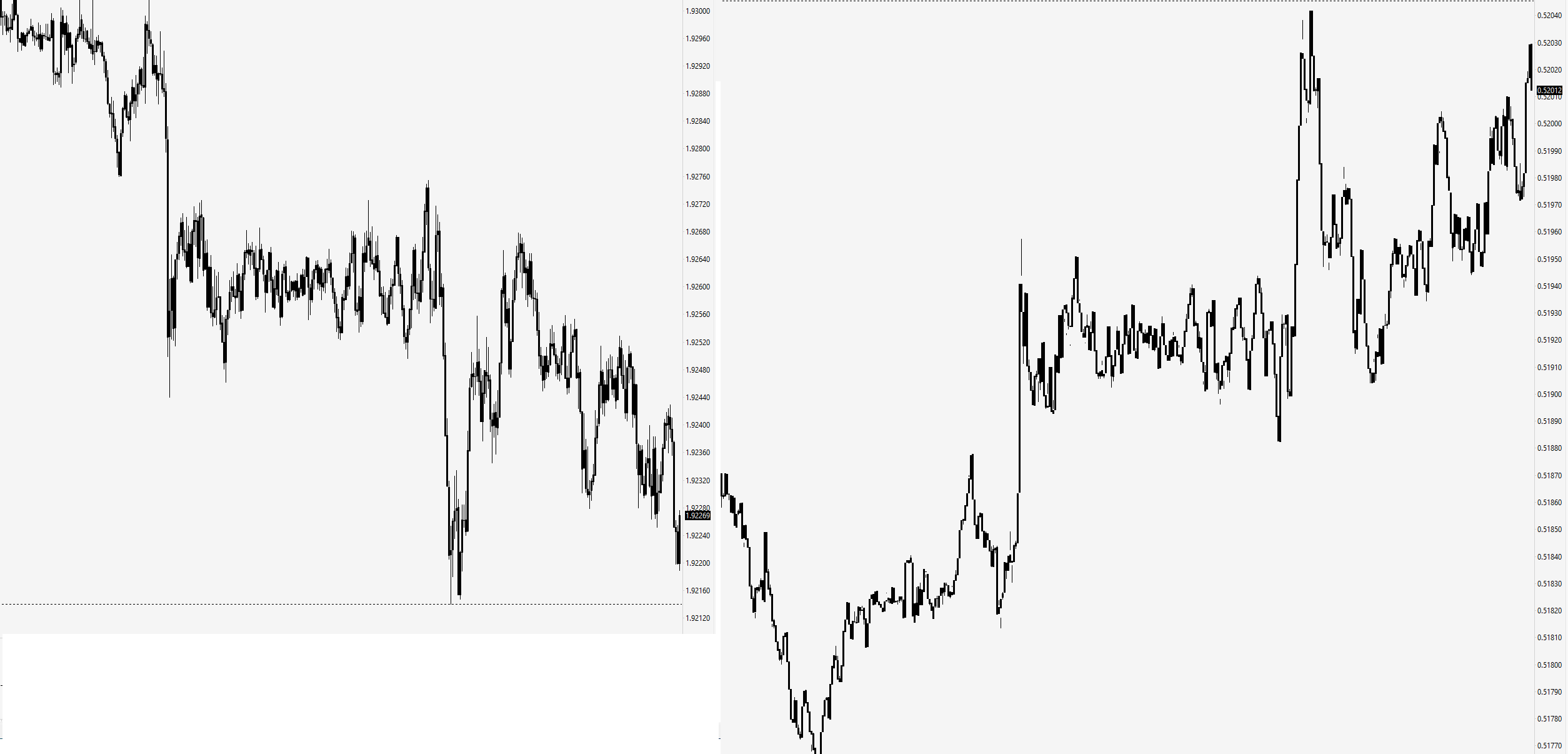

Please check attached screenshot captures. Pink line is drawn at 141.50 on GBPJPY, which was touched on 17th October 2019.
Inverted chart shows a miscalculation, which is amended if dropped down to lower timeframes such as 1 min.
I believe this could be the root of the inconsistency described above? Happy to do other research if you need me to, or pay for your time in fixing this.

imagesierra.png / V - Attached On 2019-11-22 15:36:27 UTC - Size: 10.75 KB - 434 views

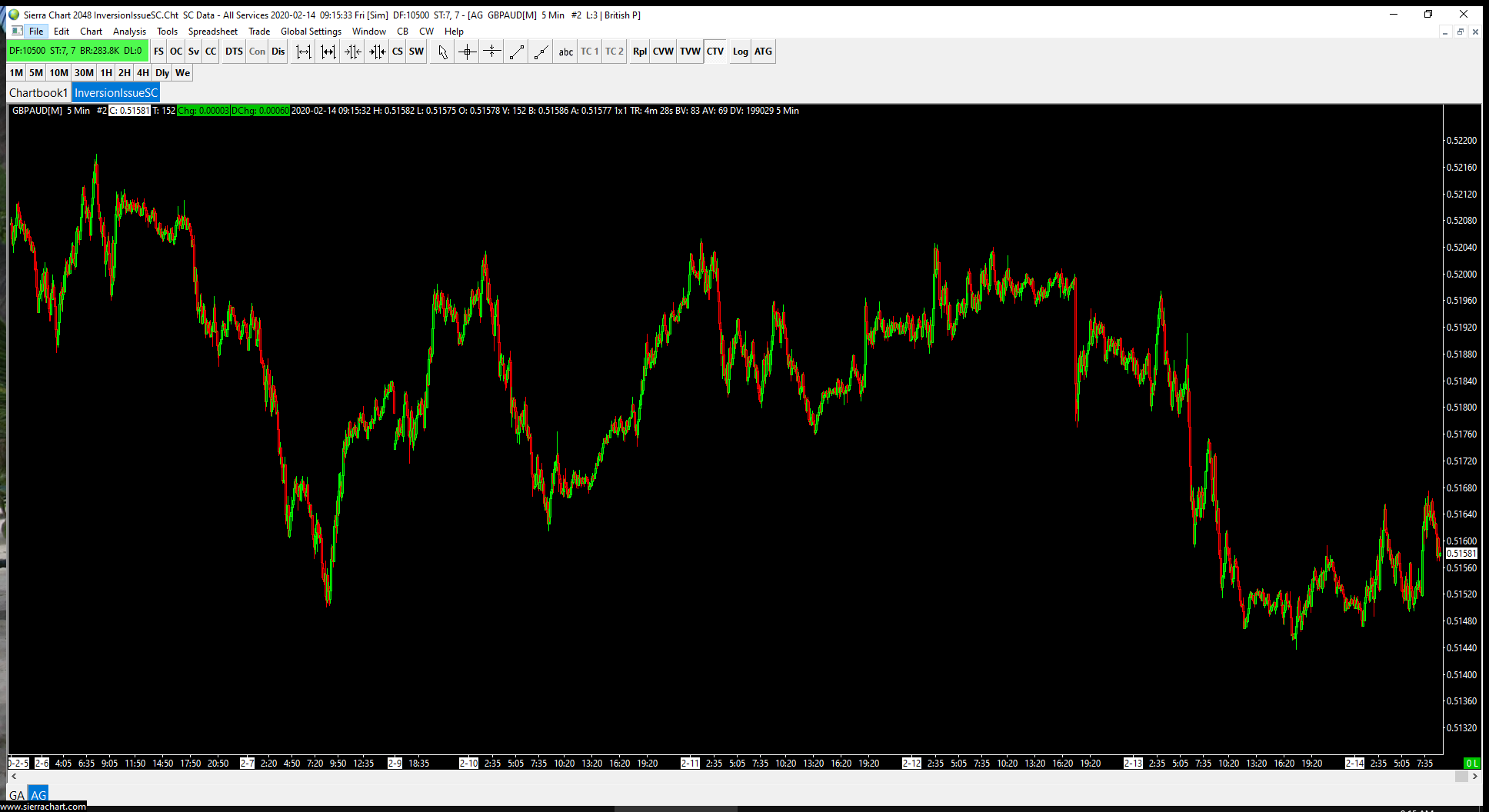

Still an ongoing issue with the lack of wicks when a chart is inverted? I thought this would be bundled with the old problem of the candles moving off-position, but positioning seems to be accurate now (see black dotted line). Have attached screenshot to aid, please ask for any more assistance
imageSIERRA.png / V - Attached On 2020-02-12 14:49:34 UTC - Size: 121.01 KB - 411 views

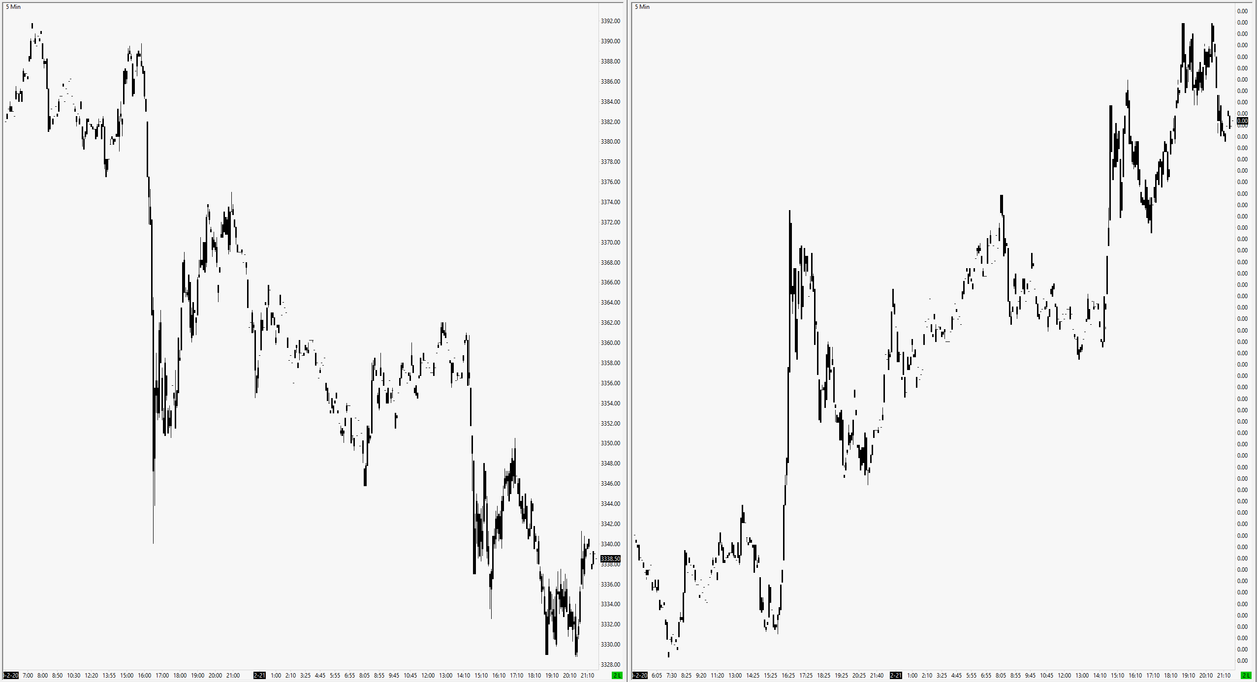

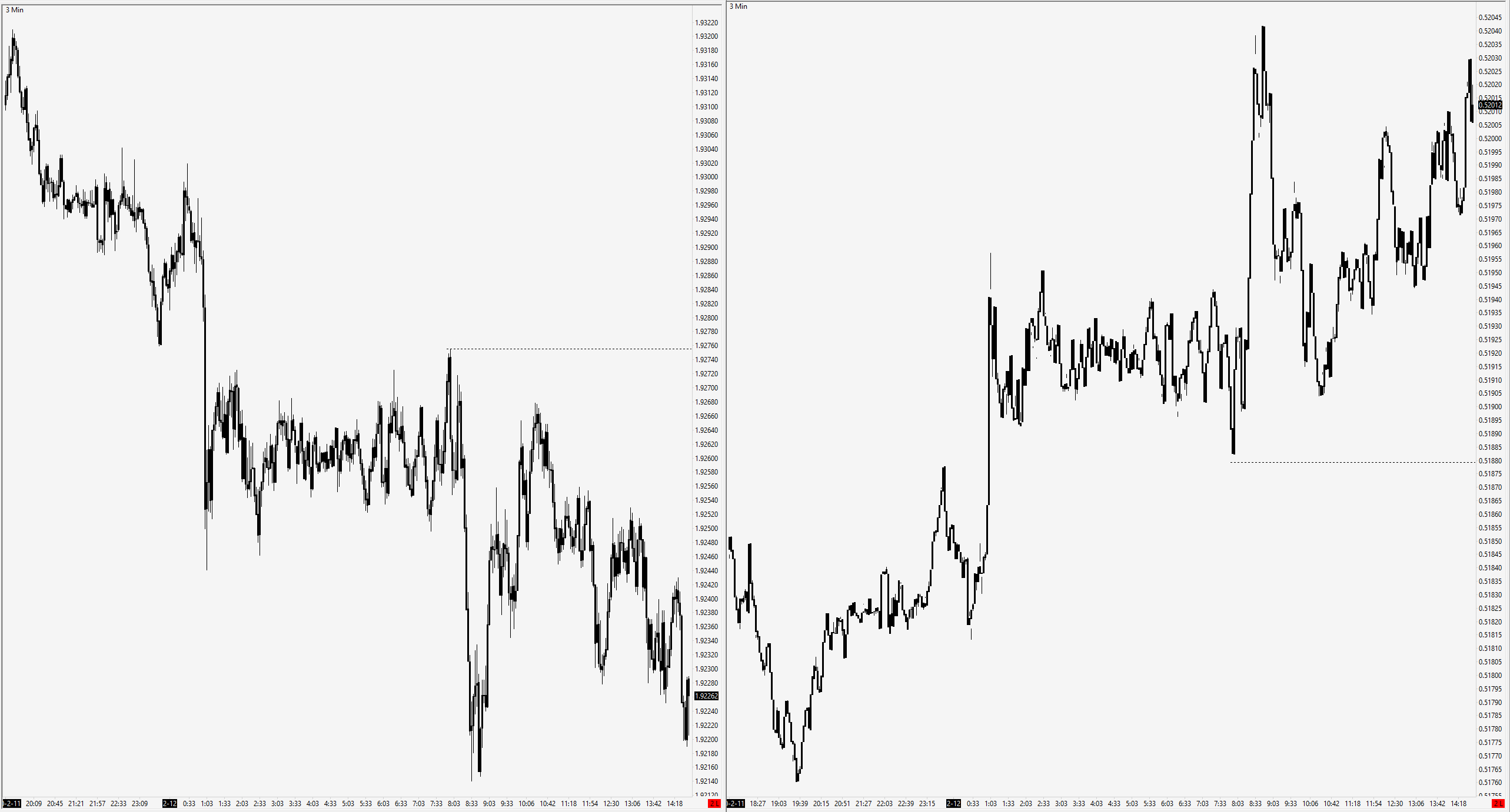

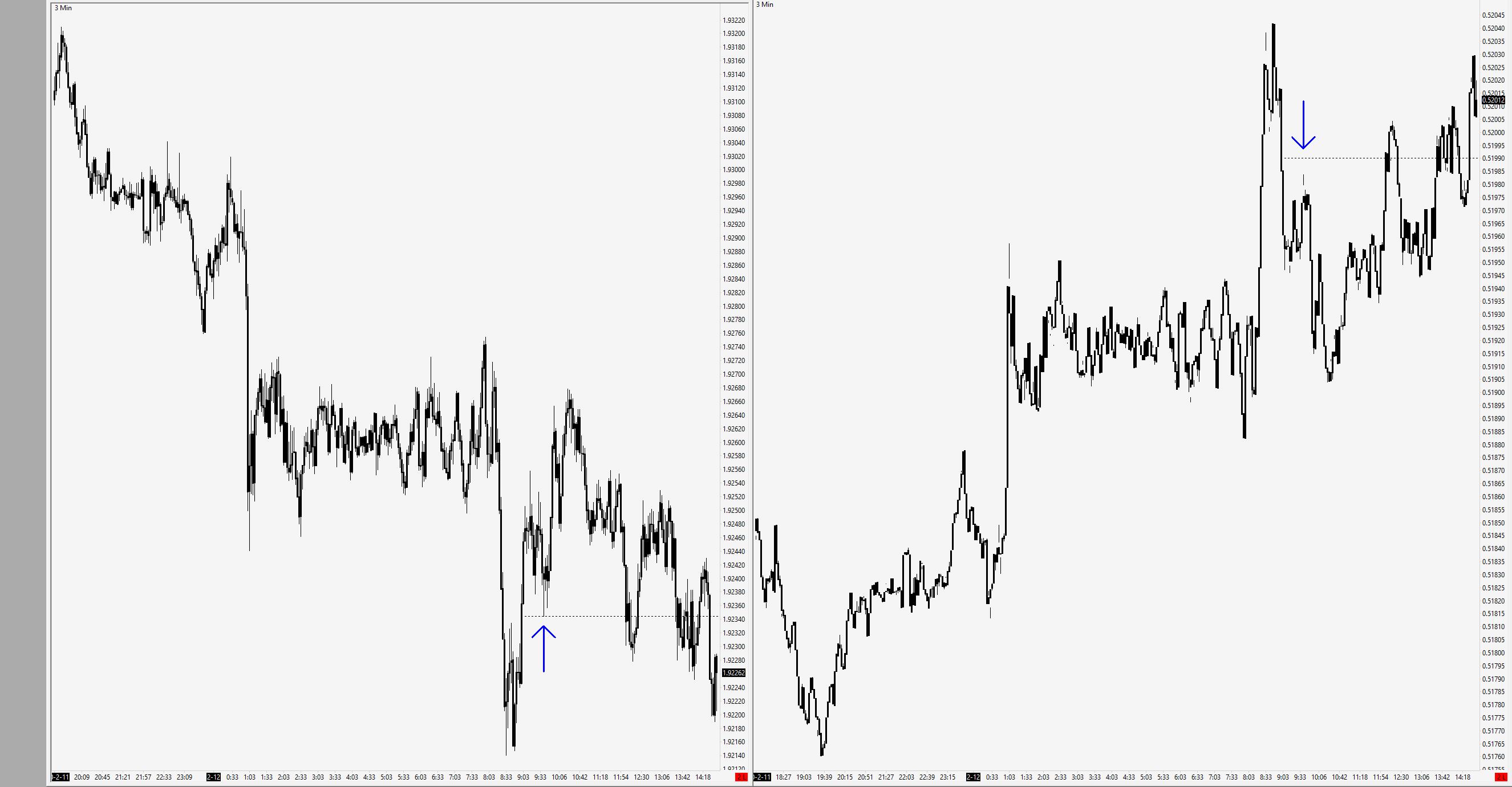

User34124 - Posts: 289
Feb 12 2020, GBPAUD 3 min chart
Hope these three examples illuminate it. Looks like just a wick problem and the price offset is just illusory. Happens on all symbols. The arrow replicated over perfectly. Same chartbook and graphics settings as already uploaded
Date Time Of Last Edit: 2020-02-15 12:47:53
imagesierra1.png / V - Attached On 2020-02-15 12:44:14 UTC - Size: 154.53 KB - 474 views
imagesierra2.png / V - Attached On 2020-02-15 12:44:17 UTC - Size: 72.87 KB - 368 views
imagesierra3.png / V - Attached On 2020-02-15 12:44:20 UTC - Size: 72.83 KB - 485 views

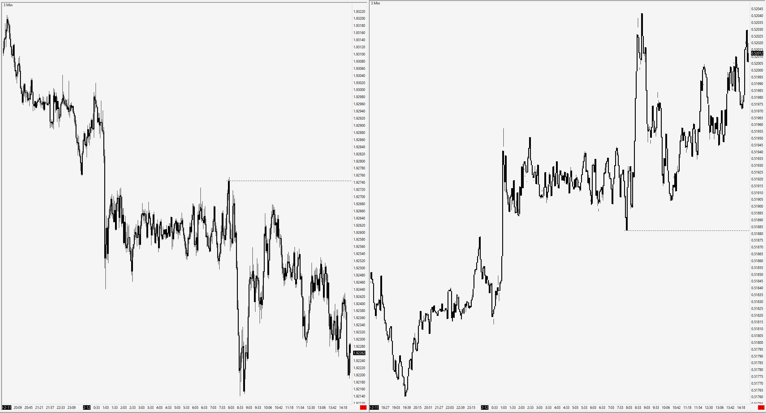

@User34124 - Can you please do me another favor. Open a new chart for the symbol ESM20 and select Chart >> Chart Settings >> Advanced Settings 2 >> Invert Prices and then take an image of the bars and attach it to this thread and let me know if everything looks good or not.
[2020-02-21 23:00:41]
Sure, attached, same issue, 5 min ESM20 charts side by side.
One thing to study may be the difference between 1 minute charts side-by-side seeems "better" than 3min.... then as you get up to 50min-ish charts, the problem starts to normalise. Weird, huh? You're welcome to remote view my computer as I display
imagesierra1.png / V - Attached On 2020-02-21 22:59:16 UTC - Size: 114.15 KB - 370 views
