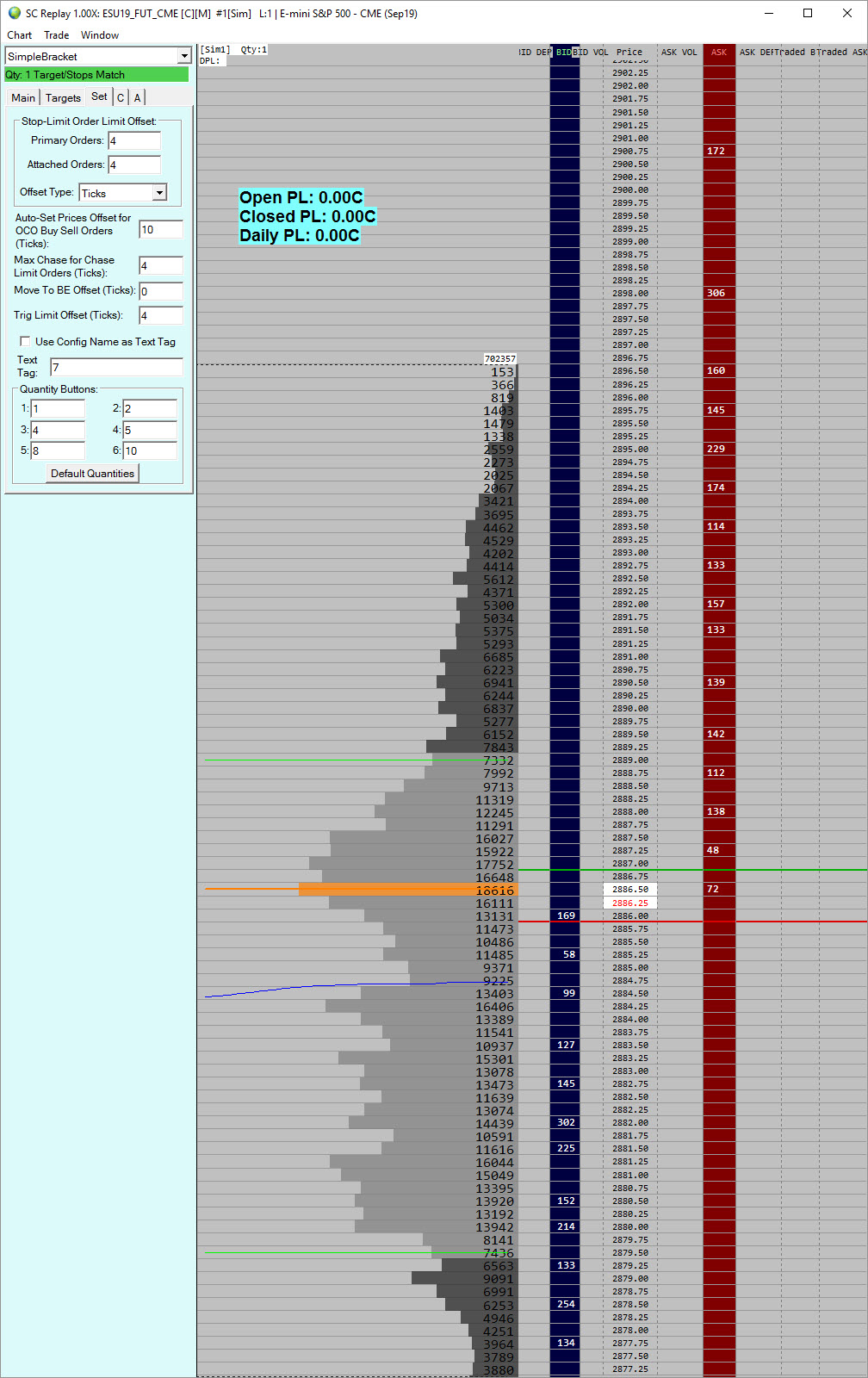

imageTrading_DOM-19-AUG-2019.jpg / V - Attached On 2019-08-19 20:20:13 UTC - Size: 499.86 KB - 555 views
[2019-08-19 20:29:04]
Why do you say you are not seeing market depth data? The blue and red columns clearly do show market depth quantity numbers.
[2019-08-19 20:41:58]
In addition, I'm not seeing any ask and bid traded volume.
We will solve this.

Regarding the market depth data, please disregard - I misspoke.
