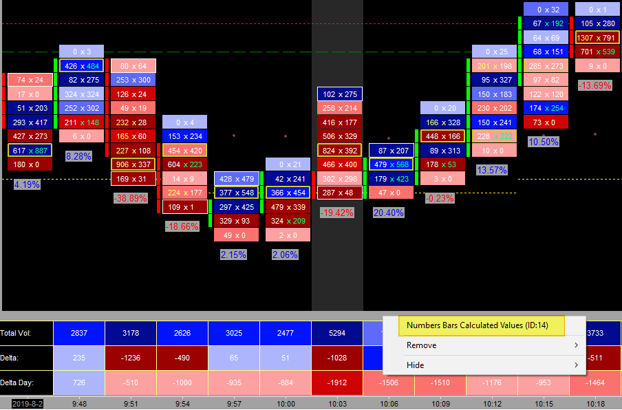

nicktrader - Posts: 813
@FlyingLimousine
Only as an Idea (see pic) I am using additional the study "Numbers Bars Calculated Values"
imageNBs BUND M3.png / V - Attached On 2019-08-02 10:12:15 UTC - Size: 46.57 KB - 449 views
