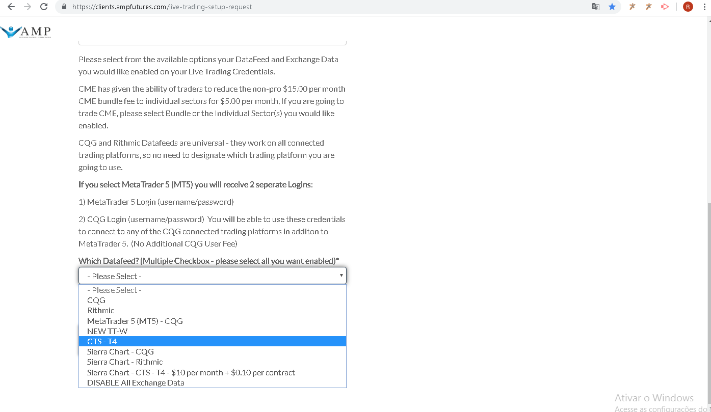

Hello. I have CQG real time data for S&P. But i use historical data to BMF(Brazil). On the free trial, when i insert TPO studies, it works just fine. Now when i try to use historical and TPO studies for BMF currency and futures index it fail to download historical data.
Even if i change ti data/trade services to SC data all service, keep getting the same fail to download message.

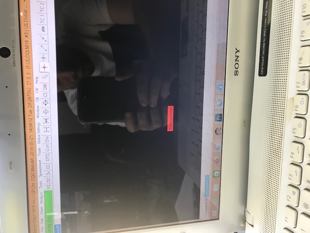

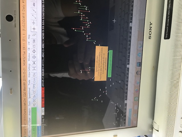

I did the procediment to active historical data on my CQG account. Now i can see the historical data, but when i insert the TPO chart study i keep the the failed to download message and the black screen. Other studies im having now problem, only the TPO chart one.
In the other hand, if i use on the micro SP, with i have real data, theres no problem and works perfectly.

[2019-05-17 14:21:51]
Based on the below your CQG account is not authorized for historical data or real-time data for F.US.DOLM19 and the other BMF symbols. Contact your broker for help with this.
HD Request # 8 | Error downloading historical Intraday data for F.US.DOLM19. Instrument F.US.DOL (corresponding to ID 4) is not allowed. Result=103. Num Quotes=0 | 2019-05-16 12:12:08.258
CQG WebAPI | Market data subscription for F.US.DOLM19 was unsuccessful. Text: Real-time data for instrument F.US.DOL (corresponding to ID = 4) are not allowed. | 2019-05-16 12:11:48.909
Date Time Of Last Edit: 2019-05-17 14:22:45

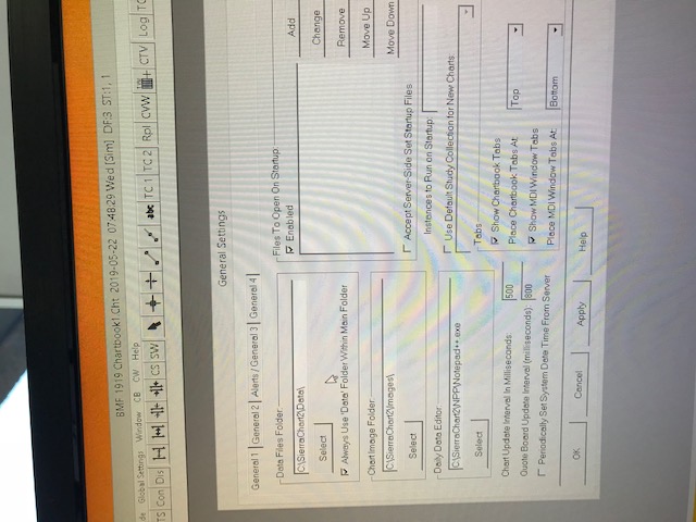

[2019-05-21 18:12:50]
User420291 - Posts: 44
Should i do something ou just wait for your return? There is 2 screenshots attached so you can see the message im getting. When i choose the symbol i got the first message, and when i choose TPO chart study i get the second screenshot.
imageIMG_0186.jpg / V - Attached On 2019-05-21 18:10:13 UTC - Size: 81.43 KB - 480 views
imageIMG_0185.jpg / V - Attached On 2019-05-21 18:10:18 UTC - Size: 69.43 KB - 323 views
[2019-05-22 04:08:13]
We are not sure why you are using CQG. If you are using CQG for certain reasons that is ok.
But we want you to install another copy of Sierra Chart following these instructions here:
Using Multiple Data and Trading Services at the Same Time
Use the Sierra Chart Historical Data Service:
Open an Intraday chart for XDM19
You will then not have any trouble with the TPO charts.
This is the only solution. Follow our instructions here. We want to solve this for you. You are not going to get it solved by using CQG.
Date Time Of Last Edit: 2019-05-22 04:09:25

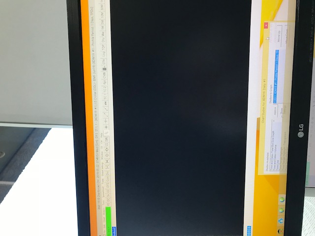

[2019-05-22 19:37:20]
I had contract the Sierra Chart directly via AMP futures, and add the CQG data services because of the facility. I only need real data for S&P, i´m paying 5 usd/month for real data. If i chance the data service to sierra i will have no problem anymore?
i had installed a second copy of sierra and follow all the steps, but still having the same problem.
Take a look on the pictures and tell me if i did something wrong.
Anyway, whats the link to check the real data price for S&P via Sierra Chart?
imageIMG_0195.jpg / V - Attached On 2019-05-22 19:36:23 UTC - Size: 81.68 KB - 468 views
imageIMG_0196.jpg / V - Attached On 2019-05-22 19:36:27 UTC - Size: 98.08 KB - 405 views
imageIMG_0199.jpg / V - Attached On 2019-05-22 19:37:10 UTC - Size: 49.01 KB - 441 views
[2019-05-23 18:51:13]
The options i got at AMP futures to get real data to Sierra are the ones at the attached file.
I really need to solve that problem.
If i cancel the real data that i got now and get the real data directly from Sierra, how do i link to my AMP futures account?
I had contract the sierra via AMP futures, i need to cancel that e contract the plataform or i can keep it and only chance de real data service?
Thank you.
imageSem título.png / V - Attached On 2019-05-23 18:47:58 UTC - Size: 47.73 KB - 394 views
[2019-05-23 22:50:55]
We apologize. We were not paying close enough attention that your Sierra Chart account is through AMP and you cannot use the Sierra Chart Historical Data Service in that particular case. You are going to need to use a direct account to access that particular service:
Direct Sierra Chart Account
That page has all of the instructions on what to do.
When you have a direct account through Sierra Chart you can still use CQG with AMP.
Date Time Of Last Edit: 2019-05-23 22:51:45
