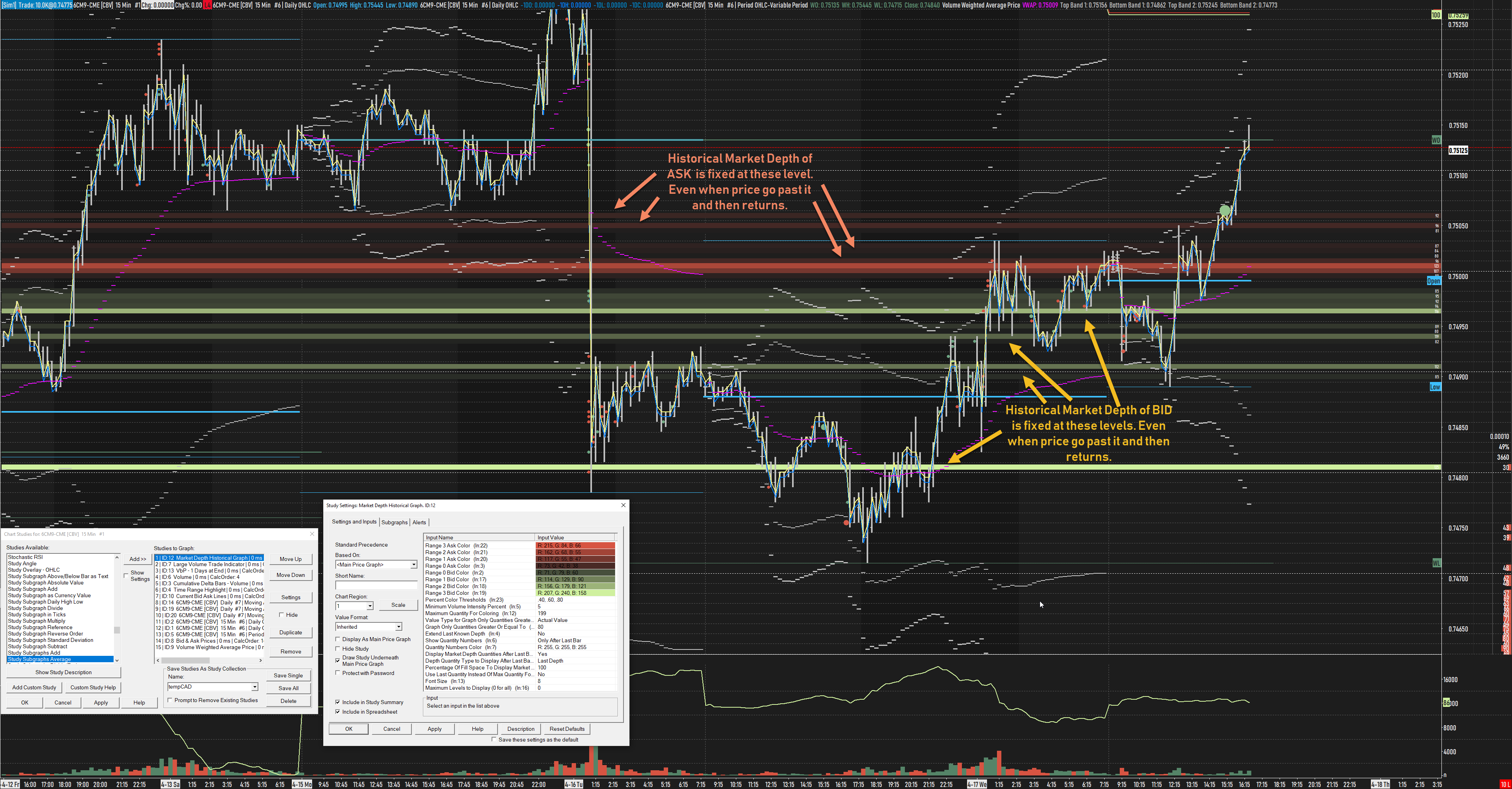

Clearly visible in the attached image what I am talking about... Doesn't even makes sense. Phantom Historical Market Depth appearing on charts.
Tried to recalculate the chart and remove all indicators except historical depth, but it is still there.

I have just done that. Restarted the platform as well. Also deleted and downloaded the symbol data again. Still bogus depth is there on the chart. This is another symbol. A different one altogether, showing the same behavior.

Now the issue is that at certain price levels, historical BID and ASK levels are fixed. Which is not really possible, because of the very definition of what bid and ask is. The price goes below and above the market depth level, but those historical depth levels remain there. This is likely also not a feed issue, just because again what BID and ASK is. Price cannot break out from a BID level without consuming all of the liquidity/market depth there and vice versa.
Have a look at the latest picture which has been labeled with the issue. Let me know if you need VPN access or any more details.

You were not connected to the data feed during those times, so the Market Depth Historical Graph displays the last known depth until new depth data is found. This is explained here:
Market Depth Historical Graph: Drawing of Depth Quantities at Price Levels on Chart Bars where there have been No Depth Updates

We did review what we wanted to in regards to the recording of market depth data and confirmed that it is working as expected. We ensured that when a full snapshot of depth is recorded every 10 minutes, that all prior levels are cleared.
If there is any issue related to Rithmic market depth data that is not something we will be helping with.
Our recommendation is to use the Sierra Chart Exchange Data Feed:
Also, this data feed supports controlling the number of depth levels which are subscribed to through Global Settings >> Data/Trade Service Settings >> SC Server Settings >> Max Depth Levels.
