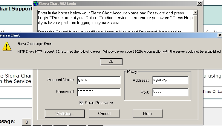

I am currently trying to help one of our trader set up Sierra Chart within our corporate environment.
However when I login, it returns an error prompt:
"HTTP Error: HTTP request #9 returned the following error: Windows error code 12029: A connection with the server could not be established"
I have set up the proxy address within the login box but I'll like to check if we need to open other ports within our firewall to resolve the above error.

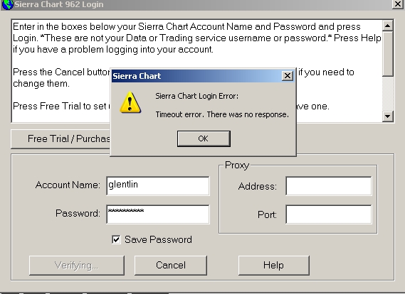

[2013-04-10 06:54:39]
Try leaving the Proxy Address box blank and only enter the Proxy Port number. The port number is the only port that needs to be open on the network.

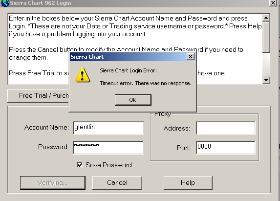

[2013-04-10 07:25:41]
User12267 - Posts: 14
Tried leaving the Address blank.
Now the error message is "Timeout error. There was no response"

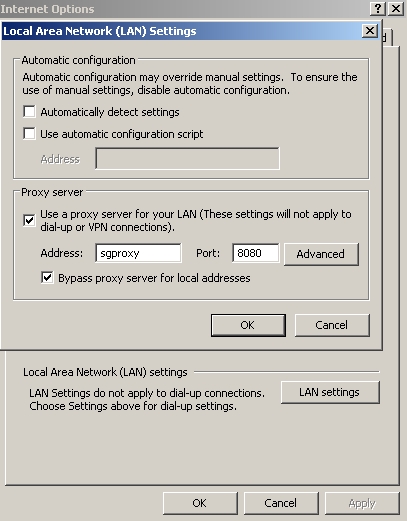

Yes I am pretty sure. I checked my the proxy used via Internet Properties > Local Area Network (LAN) settings.
And I am sure that I can browse the Web with my IE using the same settings.

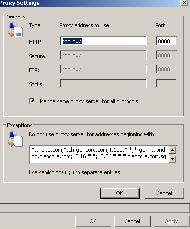

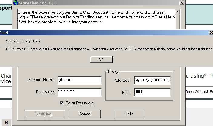

I have attached 6 images for your references. This was the proxy we have in our company and the different settings I tried in the login box.

I checked within the proxy settings in my browser, only HTTP is used (see my 2nd image attached previously).
