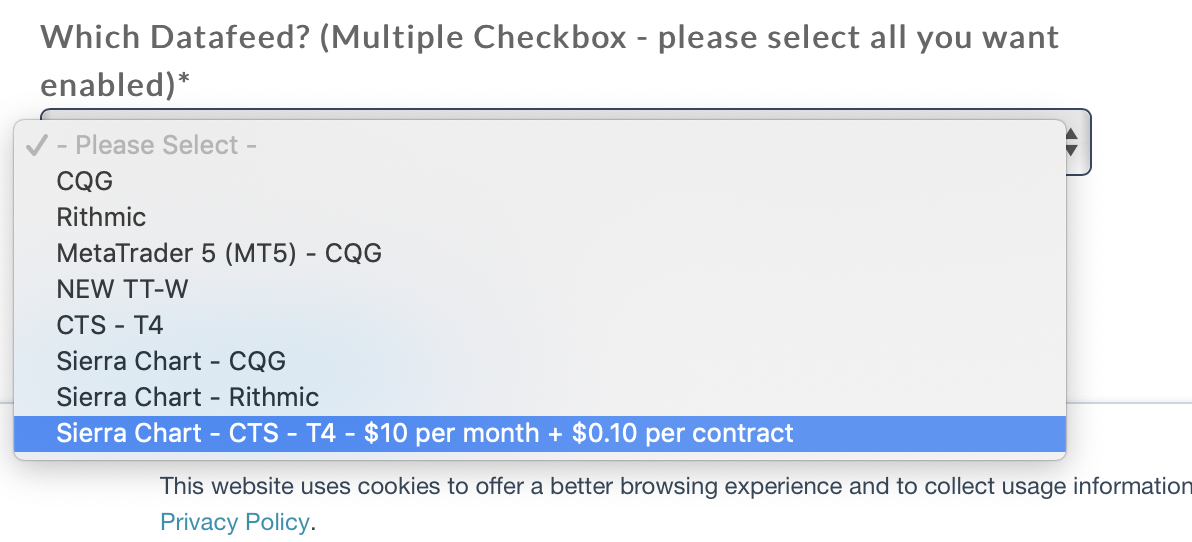

nosast2 - Posts: 73
I would like to give this a shot and test the new connection model in comparision to my current solution. Before I fill out the request, could you please answer the following:
- When will you discuss billing of routing fees with AMP? I would like to pay the routing fees from my AMP account and not from Sierra account. Main reason is the tax statement. I'm sure that the german tax authority won't accept a separate invoice for routing fees.
- My AMP account currently is linked to Rithmic. If the form is left blank where it states TT-account, will AMP than switch me over to Sierra with TT? Or should I change my account with AMP to be switched to TT? If the change should be made, please let AMP know, that Sierra with TT is currently not available in their dropdown to change technology and it also shows the outdated CTS option (see attached).
Norman
imageBildschirmfoto 2019-02-19 um 23.26.26.png / V - Attached On 2019-02-19 22:34:12 UTC - Size: 447.83 KB - 1399 views

Will the executions be saved in the cloud? As I'm trading on two PCs I only see the orders from the PC I'm on. It would be nice to have this in sync to show the correct P/L and all the order fills.
This will be the case and this is one of the features.
We are not sure when, but we think at the soonest this could be available would be in two months. Seems hard to believe, the German tax authority would not accept a separate invoice. If it is a real invoice with the name and address it should be fine.
We will handle all of this with AMP. We have just contacted them.
