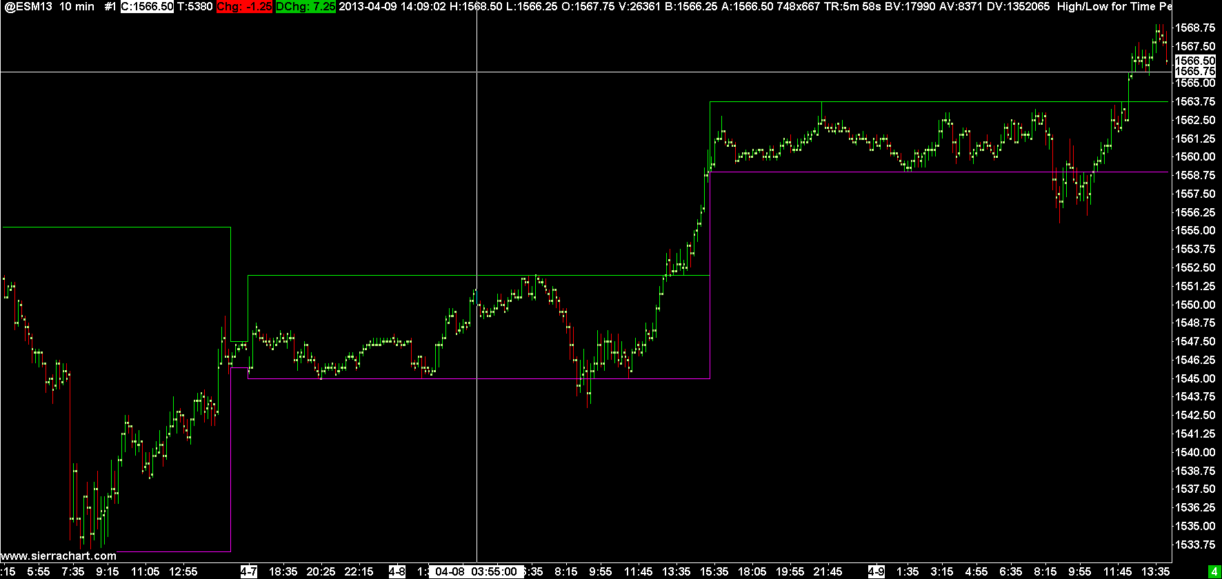

High/Low for Time Period-Extended does exactly what you want. You also need to set the Session Times in Chart Settings properly. Please refer to the documentation here:
http://www.sierrachart.com/index.php?l=doc/doc_TechnicalStudiesReference.html#s246
Example:
http://www.sierrachart.com/image.php?l=1365534544854.png

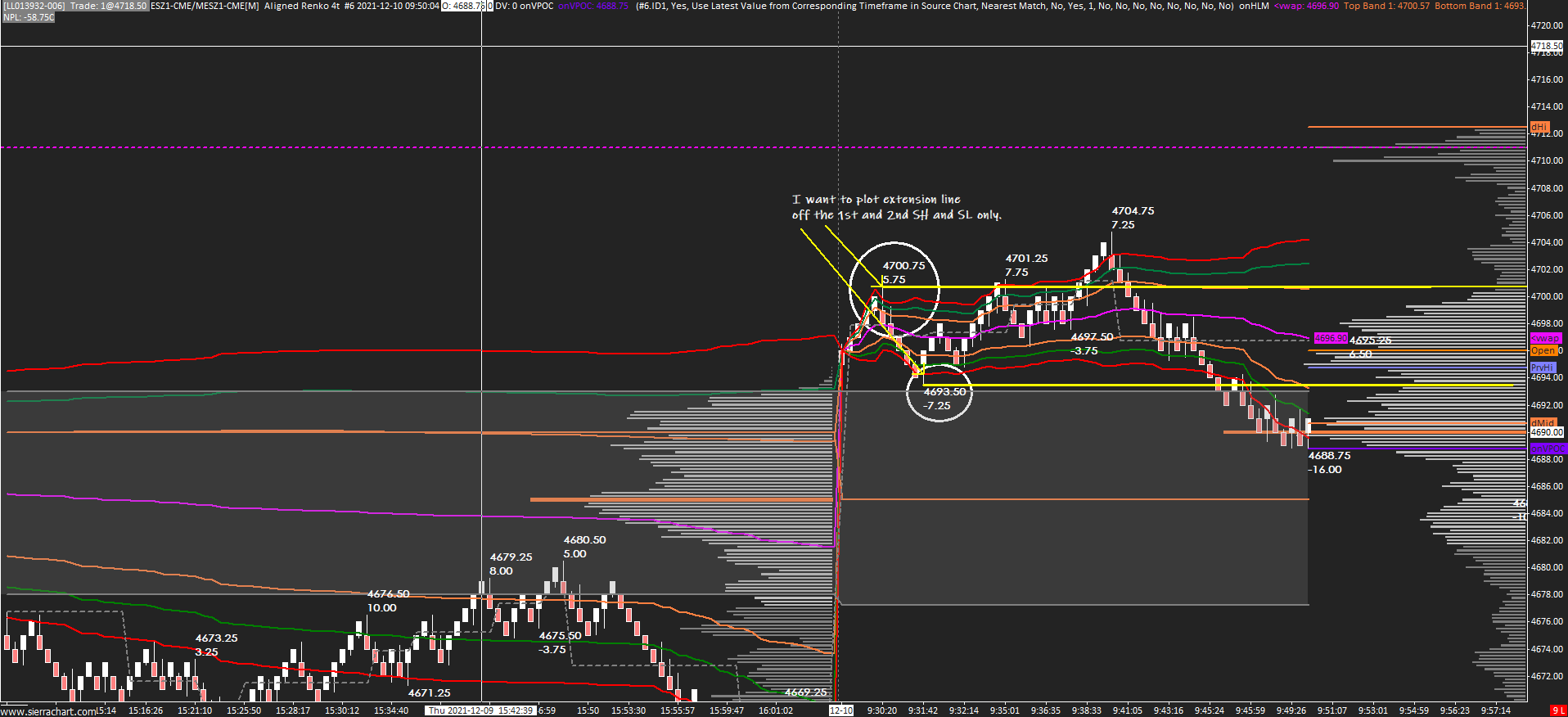

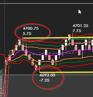

[2021-12-12 15:33:55]
Showbiztrader - Posts: 8
Thanks John. I've looked at this before and I'll try again, but do you think there's a way to limit signals and extension lines for all the SH/SLs that follow the very first two so that I'm not getting all the other ones all day long? I just want those first 2 SH/SLs.
I'm using the ZigZag study on an Aligned Renko 4T. Not a big deal...I can just hit the first two with a couple of horizontal extension lines and be done with it. But I love learning new things with SC.
https://www.sierrachart.com/image.php?Image=1639323190270.png
image1stSHSL_extension.png / V - Attached On 2021-12-12 15:25:46 UTC - Size: 17.45 KB - 453 views
