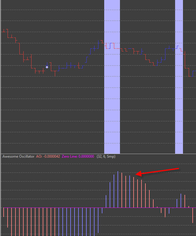

2garin - Posts: 189
With equal bars height, the color is inverted.
How to mark blue bars in similar situations?

Sawtooth - Posts: 4358
First, I'm a user, not SC Support.
Second, if the bars change color, they are not the same height.

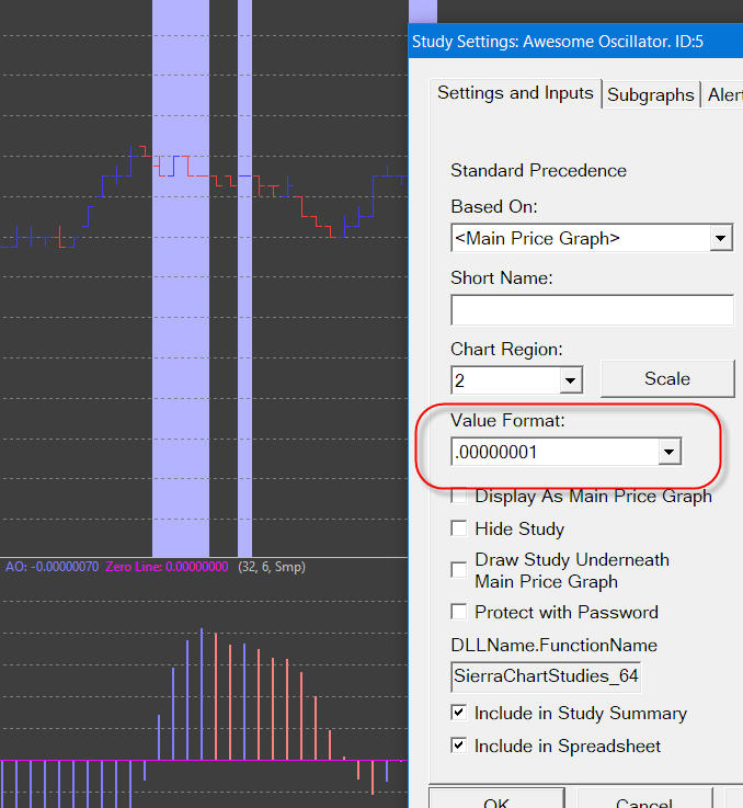

increased the number of decimal places and the condition worked.
image14.jpg / V - Attached On 2019-01-06 23:35:32 UTC - Size: 97.82 KB - 392 views

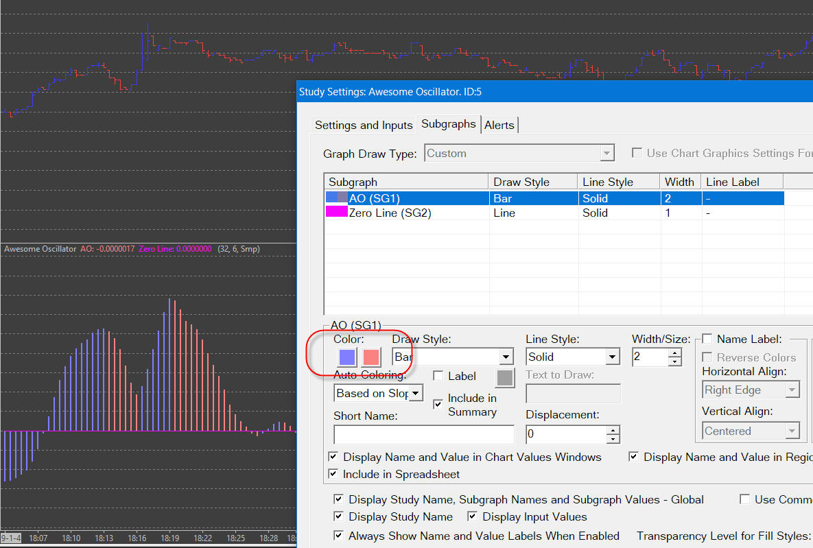

2garin - Posts: 189
How to mark all the bars in red (and equal too)?
image21.jpg / V - Attached On 2019-01-09 09:18:16 UTC - Size: 91.15 KB - 410 views
Try this:
=AND(ID4.SG1<=ID4.SG1[-1],ID4.SG1>0)
If you look at the documentation and examples for alerts, you will be able to write your own formulas:
