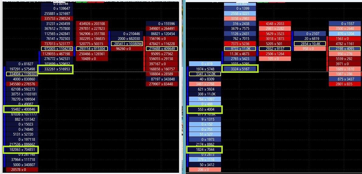

[2024-01-10 09:40:50]
User805074 - Posts: 29
OK John, but the coloring of the bottom of the clusters is not based on the highs of the trading day, but takes them into account. The calculation is based on the delta, as did Market Delta, and today ATAS, CQG, the user whats1thingnow in the publication 144616, explains the method to do it. In my publication above I explain how I have done it, which is using Based on AskVol BidVol Difference - Actual, but for the coloration to be as close as possible to the attached image of ATAS, or CQG Market Delta, you must manually modify the values of Column 1 Actual Volume Compare Thresholds In:112 (if this column is used in the study), changing them according to the market and its trading volume, to match the attached image. It would be interesting if this option were automatic, when selecting the background coloring method, Based on AskVol BidVol Difference - Actual. Thanks.
imageMarketDeltaBidxAsk_Footprint2.jpg / V - Attached On 2024-01-10 09:37:00 UTC - Size: 282.07 KB - 282 views
imageMarketDeltaBidxAskFootprint.jpg / V - Attached On 2024-01-10 09:39:05 UTC - Size: 176.8 KB - 311 views
imageMarketDeltaBidxAsk_Footprint3.jpg / V - Attached On 2024-01-10 09:40:01 UTC - Size: 182.89 KB - 212 views
