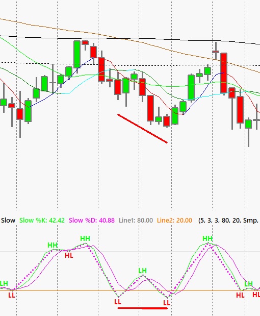

Hi, I apply zigzag study to indicator to capture the HH,LH,LL,HL. Is there a way to use color background alert to capture these 4 values and compare against the main graph prices? This is an easy way to detect divergence.

Thanks but I get the idea that it stops at; ID1.SG2 where SG2 is the subgraph for for text labels. How to add these number value when using Color background alert;
LH (Lower High) = 1
HH (Higher High) = 2
HL (Higher Low) = 3
LL (Lower Low) = 4
Currently this is what I used but not working as it should; =AND(ID33.SG2>ID33.SG2,C>C[-6])
Date Time Of Last Edit: 2018-12-15 15:32:17

Sawtooth - Posts: 4361
What you want to do is much too complex for a Simple Alert formula.
It could be done with a spreadsheet study, but it's not as easy as you might think.
It is a huge advantage to use the ZZ study because it marks where to look for a divergence, but there are other considerations.
Coding it on a spreadsheet would require creating persistent variables of the ZZ value and H/L prices at the Text Label locations.
-Then you'd need to use formulas like these to find the previous occurrences:
Spreadsheet Example Formulas and Usage: Return Last Two Zig Zag Reversal Values
-Then you'd need to subtract the two prices and the two ZZ values to see if there was a difference in direction.
-And even this wouldn't find the divergence in your example because both are downsloped.
-Now you'd need to establish parameters for differences when the slopes are in the same direction, and for how much difference should be considered if the slopes are in the opposite direction.
-And this would still miss some divergences you see with your eye, or find some that you didn't want to consider.
There are divergence detector studies out there, but they will have the same limitations:
Divergence Detector Study with lines
Detecting divergence is difficult to do with an algo. It's more of an art than a science.

User164231 - Posts: 281
Thanks Tom, I have looked into others but it is not what I want.
IMO the hardest part is to identify the most recent swing highs and lows of an oscillator/indicator, which the ZZ has effectively picked up. We are now left with the easy part of creating another study/code to reference against respective main graph candle for divergences. Hopefully one day you and/or some good coders could find the last jigsaw puzzle.
Thanks anyway for the reply. Much appreciated.

Assuming the zigzag study has an ID of 1, to detect a Higher High at a particular chart bar you would use:
ID1.SG2 = 2
[2018-12-16 07:01:19]
Hi, thanks for the heads up. My first step is to identify an angle of two reference points; say the LL of my attached image. Hence;
=AND(ID1.SG2=4>ID1.SG2=4). I also tried =AND(ID1.SG2=4>ID1.SG2=4[-1]), what did I do wrong?
2nd step is how to reference against the respective Main Price Graph bar close of each LL of stoch oscillator?
Date Time Of Last Edit: 2018-12-16 07:01:53
