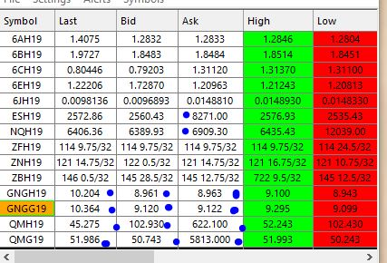

There is an issue with the bid ask volume data. This began yesterday morning, December 12, 2018. Yesterday I was able to "delete and download data" to solve the issue. This morning that isn't working either. It appears that parts of the data is over or understated by a significant magnitude causing other data to plot as "flat line" (see attached". This is occurring on all the symbols I monitor - ES,NQ,6E,6B,6A,6C,ZB,ZF,ZN,GCL and GNG.
imageCaptureBAV.JPG / V - Attached On 2018-12-12 12:08:33 UTC - Size: 18.39 KB - 530 views

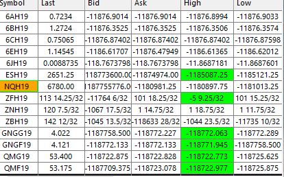

UPDATE 12.13.18 -
Apparently this issue is not resolved. Occasionally throughout the day seemingly random quotes/data occur. See attached upload. This requires a delete and download from some point prior to the spurious quote to correct.
SC VER 1850
imageQuoteBoard.JPG / V - Attached On 2018-12-13 21:09:13 UTC - Size: 58.92 KB - 500 views

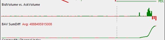

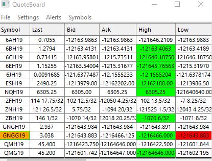

I continue to receive these erratic quotes at least 7-8 times per day, approximately once per hour during normal day trading session. It is NOT just bid/ask volume as you can see from the attached screenshots of the quote board. This corrupts my charts and each error requires a a delete and download data for all my charts. What is the solution? It seems to be an error in Sierra Charts since these same erroneous quotes are NOT occurring in the charts for the OEC Gain Trader software.
Date Time Of Last Edit: 2018-12-31 16:49:56
imageQuoteErrors.JPG / V - Attached On 2018-12-31 16:44:14 UTC - Size: 52.12 KB - 514 views
imageQuoteErrors02.JPG / V - Attached On 2018-12-31 16:44:21 UTC - Size: 54.41 KB - 446 views
imageQuoteErrors03.JPG / V - Attached On 2018-12-31 16:44:26 UTC - Size: 63.13 KB - 558 views

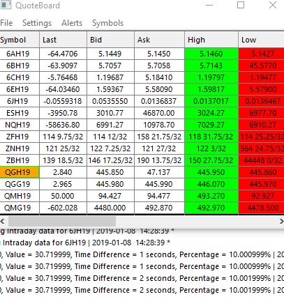

[2019-01-08 19:37:45]
NRGTrader - Posts: 351
Three occurrences today - the most recent
imageBadQuotes-02.JPG / V - Attached On 2019-01-08 19:37:29 UTC - Size: 66.62 KB - 495 views
