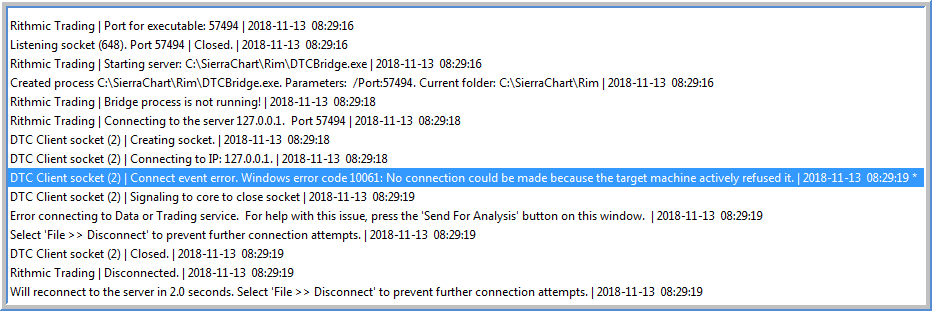

[2018-11-13 17:15:09]
TraderTen - Posts: 80
I still have the data issue referred to above with AMP/Rithmic, and in the log during a data drop today, I noticed a text line in the log which points to a possible issue with my hardware/software. See attached clip which shows the log message. Does this suggest anything to you by way of problem/solution?
PS. I still am working on switching to Sierra Chart Exchange as you suggest above.
Here is the relevant log clip:
DTC Client socket (3) | Socket gracefully closed by remote side. | 2018-11-13 08:32:16
DTC Client socket (3) | Close event error. Windows error code 10053: An established connection was aborted by the software in your host machine. | 2018-11-13 08:32:16 *
DTC Client socket (3) | Received socket Close event. | 2018-11-13 08:32:16
DTC Client socket (3) | Signaling to core to close socket | 2018-11-13 08:32:16
DTC Client socket (3) | Graceful close received or receive error. Shutdown complete. Closing socket now. | 2018-11-13 08:32:16
DTC Client socket (3) | Closed. | 2018-11-13 08:32:16
SC DTC Data with Market Depth | Disconnected from the server. | 2018-11-13 08:32:16
SC DTC Data with Market Depth | Data feed disconnected. Will reconnect in 2 seconds. | 2018-11-13 08:32:16
SC DTC Data with Market Depth | Connecting to the server ds4.sierracharts.com. Port 443 | 2018-11-13 08:32:18
DTC Client socket (1) | Creating socket. | 2018-11-13 08:32:18
image2018-11-13 log clip.png / V - Attached On 2018-11-13 17:01:00 UTC - Size: 33.53 KB - 415 views
[2018-11-13 18:09:32]
That particular message relates to a lost connection to the Sierra Chart data server and it does not indicate any problem on your side necessarily.
But that server is different than the servers used for the Sierra Chart Exchange Data Feed.
Date Time Of Last Edit: 2018-11-13 18:09:55
